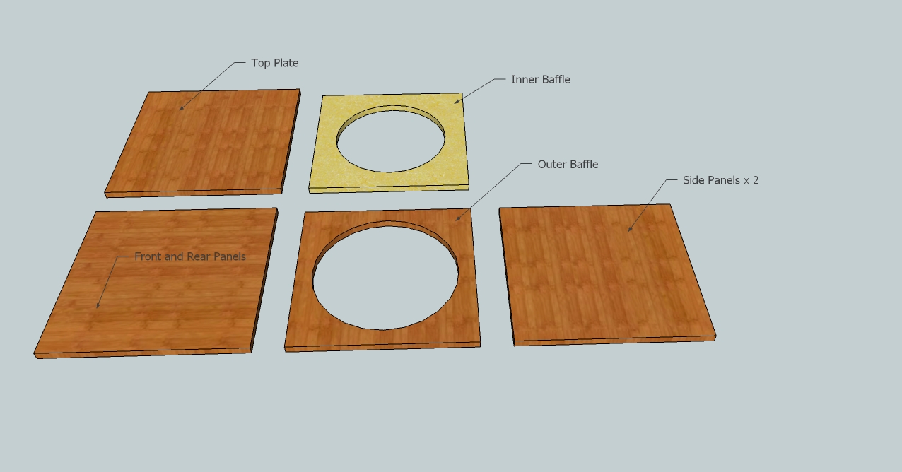

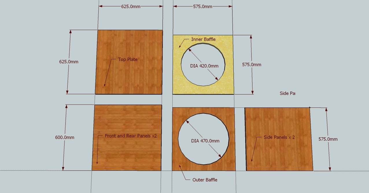

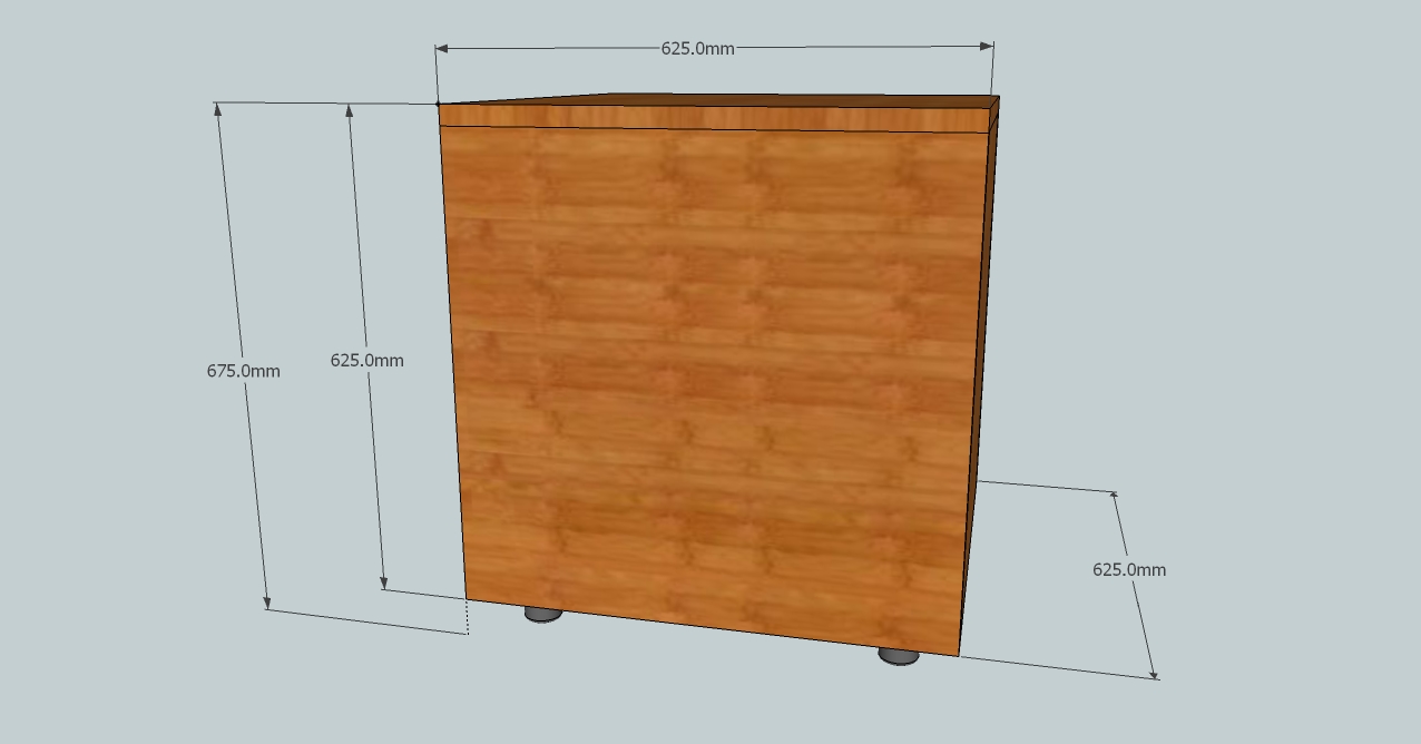

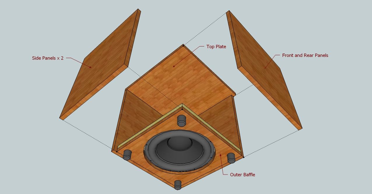

Thanks for that link. I have read most of that thread, and to be honest, I am a little bit intimidated. Those diminisons listed are hard for me to understand and picture in my head as I have never done any wood working before. Do you know if anyone has made a cutlist with the exact diminisons of each panal in inches? Kind of like lilmikes thread over at AVS on the F-20 horn sub that he designed? I really need some better sketches of this thing before I jump off into it.
If you build create a model in google sketchup you can produce stuff similar to what Ive done in the images attached.
I have never used google sketchup, but I will look into it. How do I figure out the diminisons of each board, preferably in inches?
I wish I knew more about using google, and had the proper diminisons for each panal. That would make this a whole heck of a lot easier! The picture that was linked a couple of post back, is very confusing in the way that it is written, and I just wish there were a more standard cut list for each panal. I really want to get started on the cabinet but I don't know what size cuts to make.
