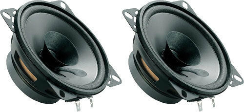

I have a kit list for the project below but the one area I am drawing a blank on is the speakers. I wanted to use car speakers that are low profile and designed to be in a small enclosure, but I was told car speakers are not designed for small enclosure spaces :shrug:.
Any recommendations for speakers on this project?

- 2 x 5" speakers SCRATCHING_HEAD

I have found that small car speakers are quite forgiving of enclosure space. They are designed to be confined within door panels after all.
You'll also not be expecting an extreme Hi-Fi performance from this small radio cassette recorder enclosure.
It is therefore worth considering a universal fit 5" car speaker that will do the job adequately without costing the earth.
Having said that, suggestions for all types of exotic 5" drivers are likely to follow!
