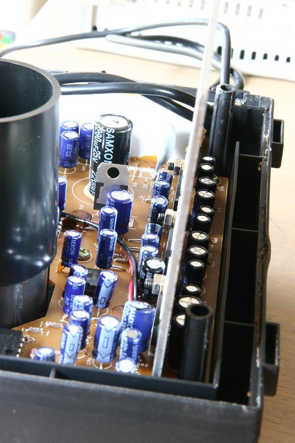

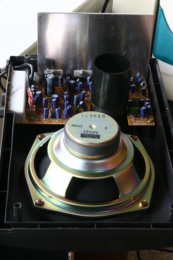

Recently my Altec Lansing AVS500 subwoofer started giving a hum noise. Quite loud actually. It hums even when i just plug in the power, without anything else connected. Another syntom is, the AC adapter/transformer gets extremely hot. After some googling, I think i have narrowed down the problem. I suspect the subwoofer output transistors have gone bad and hence putting pressure on the transformer. I figure it would be a lot cheaper if i just replace the transistors myself than buying a new set of speakers/sub.
I successfully opened up the sub but i don't know which ones are the transistors
. Any advice is greatly.... greatly appreciated.
Here are some photos of the board.

I would have thought that if your output transistors were blown you would very likely have a blown speaker also. I'd be looking in the power supply area.

Your woofer looks like it has chip amps in it. Chip amps are integrated circuits with many components built in. The black things bolted to the aluminium plate, how many legs do they have? 3 or more?
Are you sure the transformer was not getting very hot before?
Have a look at the capacitors and see if any have burst.
Quite often the larger ones are glued down, so what appears to be stuff leaking out may be glue.
Check the big black one has not broken it's solder joints.
If it's not something simple this probably won't be worth fixing. However it's a good starting point to learn some electronic basics.

From your picture, the transistors are in the back, 2 of them clearly visible, fastened to the heatsink with screws? or bolts. It is possible they are not the issue. If the hum is 60Hz (or 50Hz for some countries...) then it may be the rectifier gone bad, leaking in the AC to the driver. If the transformer had gone bad (too) this could have resulted in a dead driver. (120VAC @ 8 Ohms = 1800 W (P=V^2/R)). So if the driver still plays music as well as this hum, it still may be easily fixed.
It may also be the circuitry leaving the rectifier, as OzMikeH said capacitors are used to smooth out the rectified current. If this current is bumpy, then an audible signal may be produced.

Based on your information, i found the rectifier. It is square and with a hole in the middle but instead of 4, mine has 3 legs. 🙂
The largest cylinder (black with silver strip) is glued on the circuit board. Is that the transformer?
I have checked the legs of every capacitors to make sure they are not broken, or loosen. So far everything seems ok.
The speaker set has 4 satellite speakers and a subwoofer. They still play music/movie sound fine. It is just when the power is turned off (still plugged in to AC), it gives a hum. I can live with soft, subtle hum noise but this one is a bit loud, even to me. 😀

In the picture, all the small cylinder shaped things to the right are capacitors, as is the large "(black with silver strip)" thing. The thing with 3 pins is a voltage regulator, not a rectifier.
There are two "chipamps" on the PCB; no output transistors. One chipamp is for the sub, and the other is for the satellite speakers.
There is no transformer inside the sub. The power comes the large plastic box that gets plugged into the wall.

Hello everyone I have solved the issue of output IC overheating and possibly shorting in the AVS 500. If you have replaced the power supply condenser and still not solved the problem of humming (more like motor boating) then read on.The output circuit uses 3 ICs TDA 2007A. Two of the ICs are used in normal stereo mode (6+6w) for the surround and satellite speakers. IC 10 is used in bridge configuration (12w) for driving the sub woofer. This circuit uses six electrolytic condensers of value (0.15mf){ C93, C94, C65, C66, C77, C78} for preventing the output going into high frequency oscillations. Unfortunately the engineers in Altec lansing seem to have not realized that these condensers being polarized will not perform as they are supposed to do and the whole circuit goes into unstable high frequency oscillations that bog down the power supply due to over current and hence the humming sound from the sub woofer. It reduces after sometime but the 3 ICs tend to get very hot as the high frequency oscillation (not audible to human ears) persists. Solution is very simple. Replace all six condensers with metal polyester types. (0.1mfd, 50V). Happy listening 🙂

Thanks very much for this useful post. My problem was C93. Replaced it with a polyester non-polarised cap (0.1μF).
The 'motorboating' has stopped!
