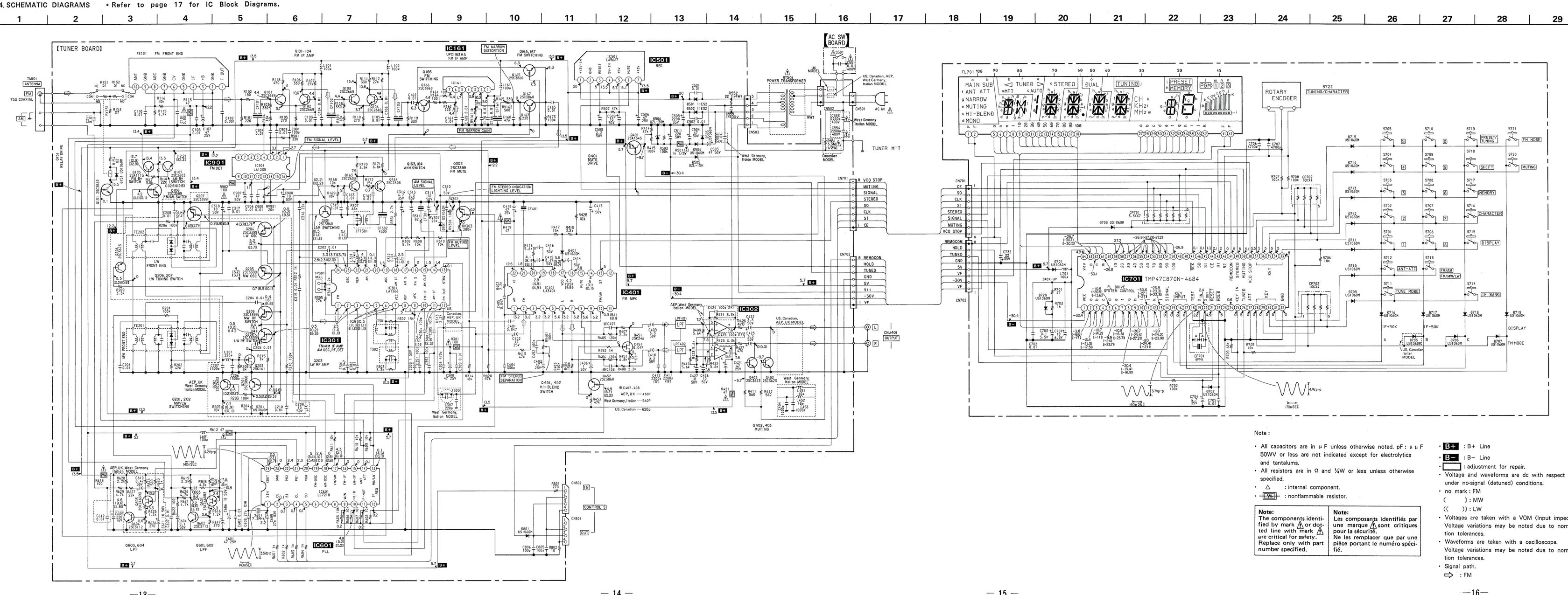

My ST-S550ES sound good five minute then the ssound is dirty .
if i change the frequency manually and i tune to the same frequency , it sound good 😀 but for few minute !

Being able to retune, and it then being OK suggests more of a misalignment issue to me.
Is there any mention of an AFC adjustment in the manual. Don't twiddle anything, but if any of the cores in the transformers are adjustable see what just placing a metallic trimmer in the core does as that alters the tuning without you twiddling. See if the sound come back.
It's T301 and T302 on the circuit diagram.
