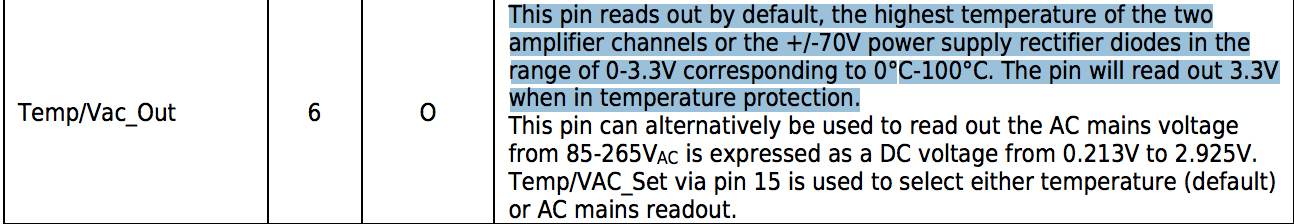

Digging up shelved projects. It seems that the module is in protect mode when measuring pin 6 'Temp out pin' I first read values which was going up and down. Anyway after further troubleshooting it seems that the RCF sub's micro controller is designed to toggle between Temp and VAC select pin 15.
I bypassed the toggling signal and manually selected what to monitor. When I short pin 15 to ground (VAC monitor) on pin 6 I get a good reading of around 0.16V. When I leave pin 15 open (Temp monitor) I read 3.3V which would be registered as a fault and the amp remains in protect mode.
I'm not inputting any signal. Anyone have any idea how the temperature is measured in the module and on which PASCAL ic pin is the temperature measurement inputted?

What do you get on pin 11? From your explanation I agree that it sounds like you are getting the temp. protection signal, but it seems a bit weird if the module is cold. Does pin 11 show that the amp is in protection and what do you get if you measure the voltages of the AUX PSUs from pin 18-26?
Pin 11 remains to be held low.What do you get on pin 11? From your explanation I agree that it sounds like you are getting the temp. protection signal, but it seems a bit weird if the module is cold. Does pin 11 show that the amp is in protection and what do you get if you measure the voltages of the AUX PSUs from pin 18-26?

I didn't measure pins 7&8 they are Vout Monitors for +-70V rail because in the application notes it says =
"This pin reads out the amplifier channel 1 output voltage. The signal will be in the range ±10Vp corresponding to ±70Vp on the output of the amplifier. The signal is high impedance and requires a buffer if used."
I wasn't sure about the high impedance and requires buffer part so I didn't want to take a chance probing around - would be great if you could shed some light on this 🙂.
