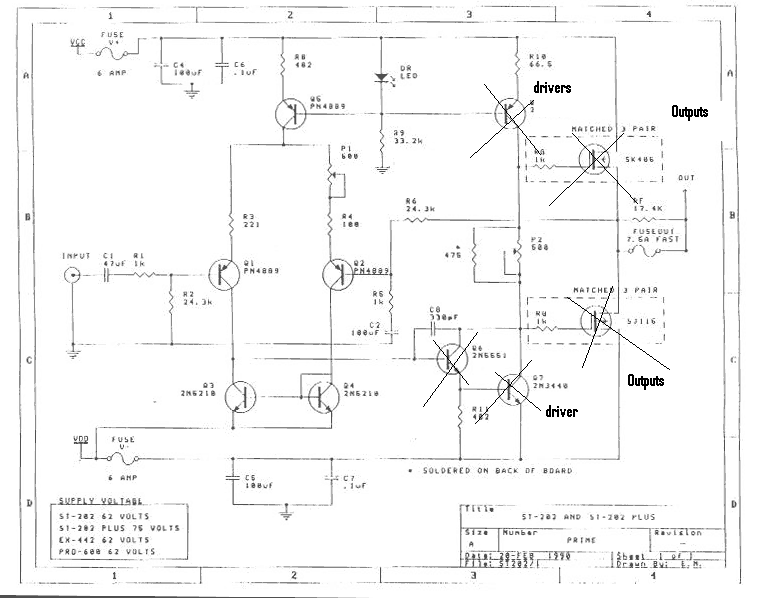

Here's the schematic. Don't know why two that are not complementary would be fried...the maid service was in yesterday, the amp was on, I'll blame them.

The output devices are mosfets. Upper ones are N-channel, the lower ones P-channel. Is there written 'Matched 3 pair' ?
This means two times 3 matched mosfet pairs. You'll have to keep that in mind.
Look at http://www.passdiy.com/howto/matching.htm to learn how to match them.
The drivers are normal transistors.
Upper one PNP and bottom NPN.

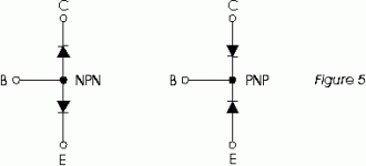

This and the drawing from hugobross are good sources to learn how to measure transistors and fets:
http://www.eatel.net/~amptech/elecdisc/ampfail.htm.
Your biggest problem will be finding the correct devices.
I'm not able to read the exact numbers of the devices on your schematic (could be my eyes).
You'll have to check every transistor and fet marked with a cross.
Maybe even the other ones.
Better take them out if you can.
You did a good job with the diode test, and with comparing to the other channel.
Carry on and good luck.
/Hugo

What a bogus design, no gate protection zeners.
Semelab BUZ900/905 ouputs are a slight step up, 125W vs the stock part rated at 100W.
Farnell sells them, about $10 in one lot qty.
djk said:What a bogus design, no gate protection zeners.
Actually, they have a number of diodes in the circuit - they're just not shown in that scan. I have another more detailed schematic, but it would have had to have been very large to be readable.
Are they "gate protectors"? I wouldn't have a clue. 😉
