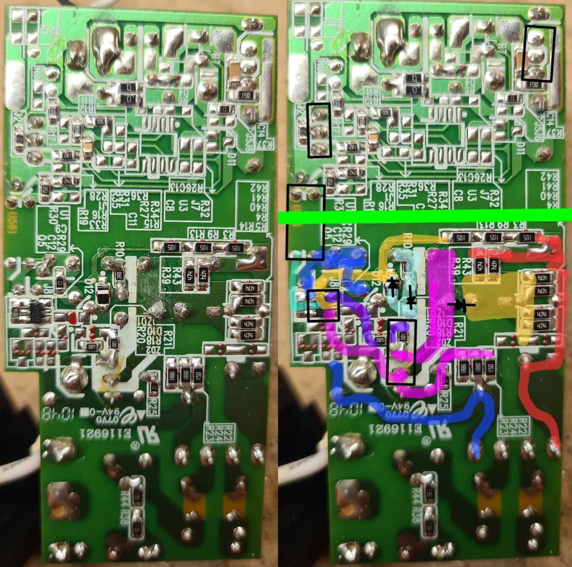

The schematic resemble this one, exept for resistors values and different MOSFET and DOUBLE DIODE semicons. I've highlighted some paths.
Red: Vcc
Blue: GND
Orange: B(1)+ // B(2)+
Purple and pink: trigger and sense of MOSFET

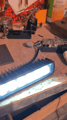

Now, I connected a load (12V 0.3A led lamp) and the voltage now ramp up to 10V, sufficient to trigger LEDS and then drop to 8. It rises again to 9.5-10 and drop. The frequency is 200 flash per minute or 3.3 flash per second.

It MUST when you are powering COBs.Shouldn't power LEDs not be current regulated?
Typically no current regulated means lower power output ie. Not pushed to limits.
OT: led philips bulbs in DUBAI have double the filaments than US EU bulb, so they are undervoltage to achieve a super efficiency.
In this case these LEDs are intended to work plung n play. But to confirm, when I supply the TV sat decoder it power on and off like 1 time per second. Pop of audio, tak tak tak tak...

I traced the PCB. The scheme posted in #1post is not the indentical same of my board.
IMHO the mosfet is fried. I suppose that since you explained the aux circuit.
So the main power start the IC that cant trigger the MOSFET so the inrush voltage and current @300ish V induce the voltage/current in the secondary (lets say 10.5V fews mA). One pulse. Then no more pulses until the caps discharge and the whole circuit thinks to be just powered ON.
Seems logic and coherent with 3.3Hz.
Btw I can hear a tik every time the led got powered. The tik come from MOSFET. Usually the tiks are so fast but also silent so you cant hear a constant freq whine, at least at 50cm distance.
Here I tracked the circuit in the first part of the PCB. LIGHT BLUE is the aux path.
Rectangles delimit the Qx and ICx.
From top to bottom and from left to right.
Dual diode
431
Opto isolator
6pin PWM controller
MOSFET
GREEN LINE like the scheme, trafo galvanic isolator
