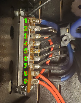

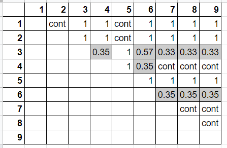

One more check before I order. I measured the bridge(?) where the primaries are attached for resistance. I expected most values but want to confirm the values in grey are correct. I numbered the tabs 1 (N) to 9(power switch).
Yeah that doesn't mean much. You're measuring the resistance of the primary coils, and at those low ohm ranges, your meter's leads are going to have nearly the same resistance as the coils. But all of that looks pretty normal.
More importantly, you'll need to figure out where to connect the dual 120V primaries of the new transformer. Determine which terminals have hot and neutral connected.

Thanks for all the help. Just placed the order for the transformer. I'll be back with photos when it arrives (and probably new questions)
