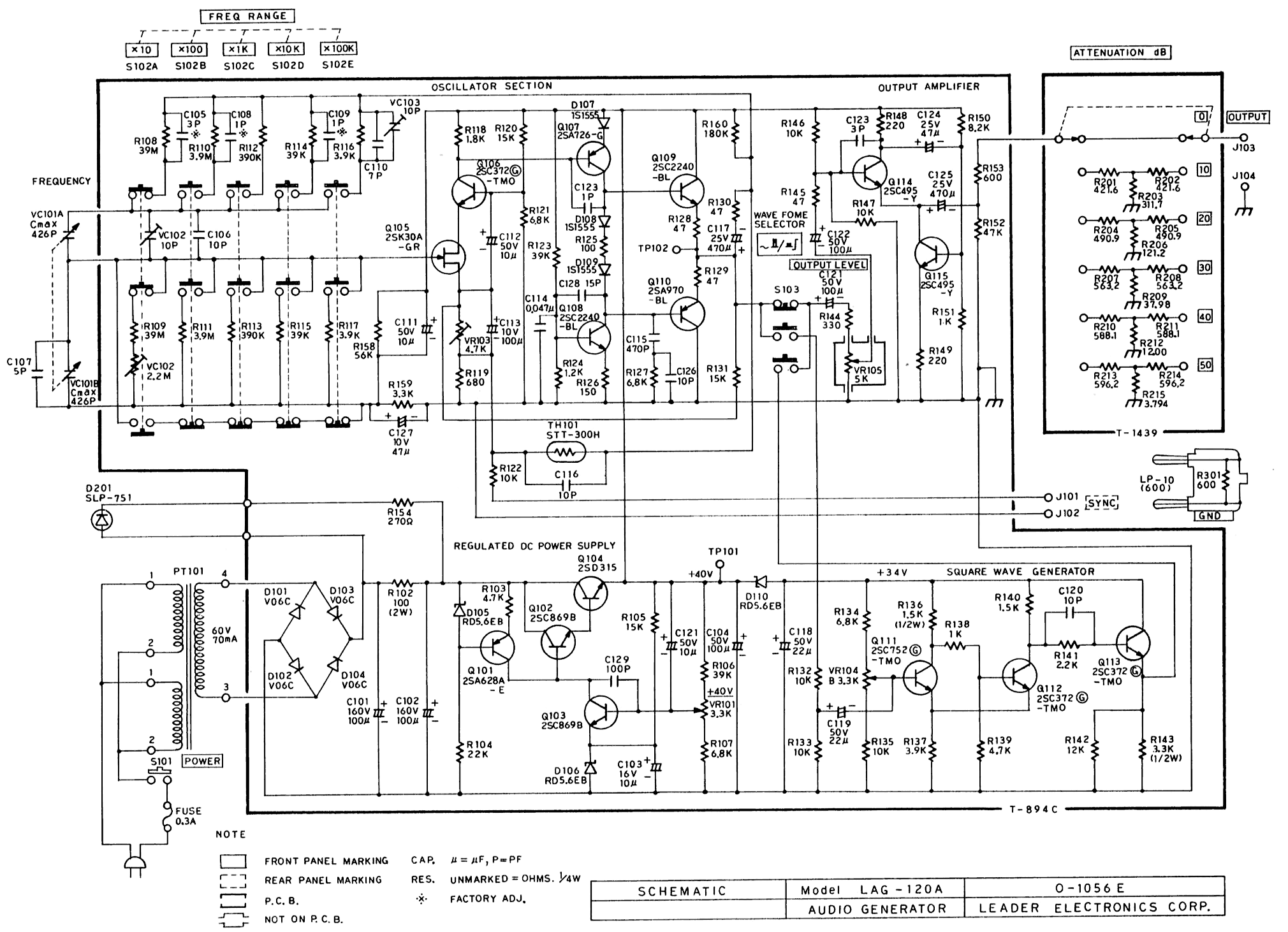

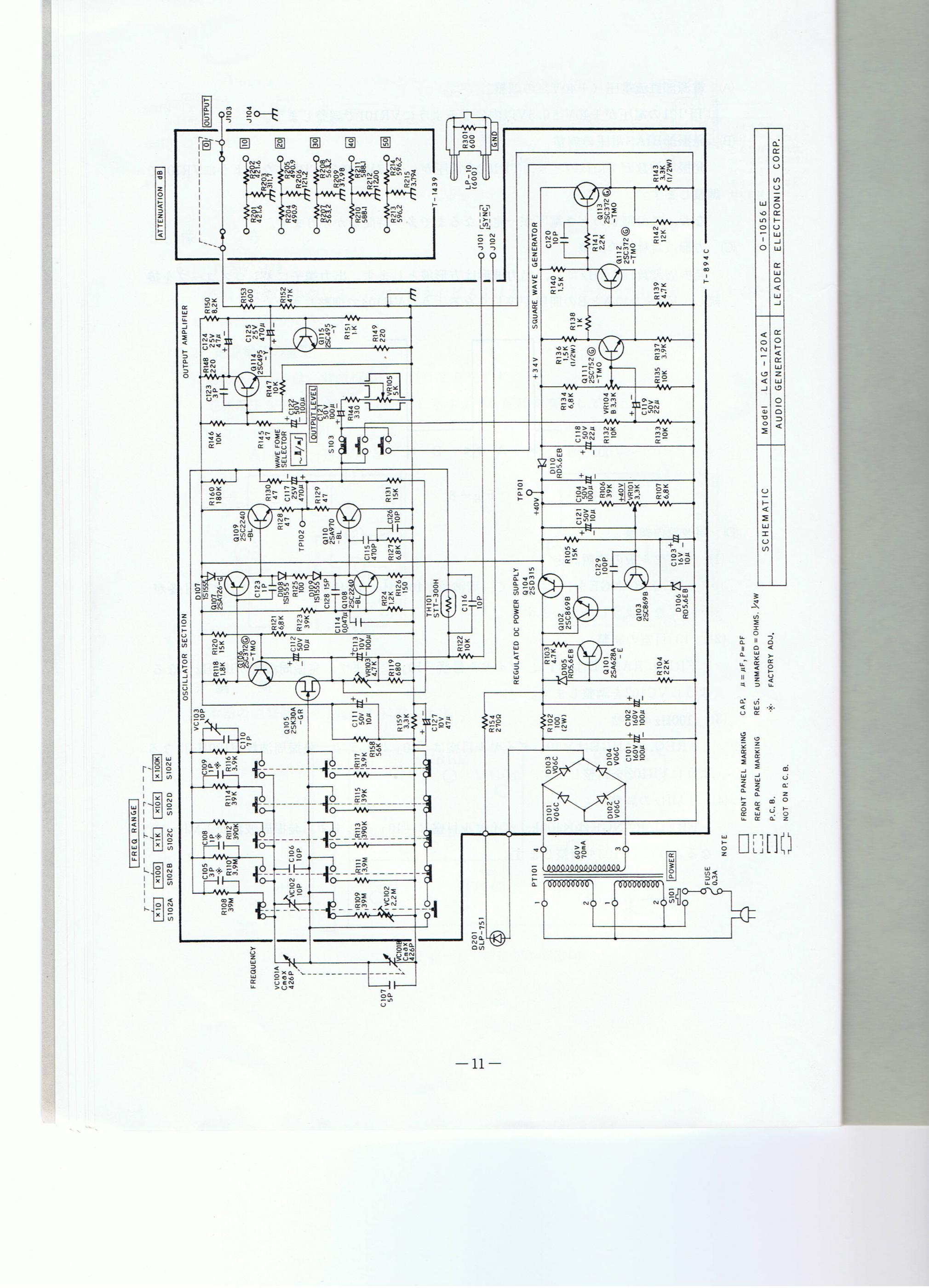

.. that thread is for the 120B, here's the 120A schematic, doesn't look all that different

Hi Rafael,
I wasn't able to find a service manual--- only schematic, nor anything about the thermistor. If you've found any actual service info, would you point me in the right direction?
But the circuit is a classic Wein bridge oscillator. At stable oscillation, the amplifier stage must generate a gain of +3, implying that at equilibrium the thermistor's resistance must be 2x R119, that is 2x 680 ohms ~1360 ohms. The thermistor must have a negative temperature coefficient so that its resistance falls with rising temperature as the thermistor heats with increasing sine wave amplitude. I've pasted a search link at Digikey. The list is large.
I've not sorted out the nominal output voltage at TP102, but I surmise it might be 6 V rms, open circuit. It seems the nominal amplitude is determined solely by the thermistor selection and R119.

If you want to experiment, you could try an incandescent lamp instead of the thermistor. See figure 2 of this link: Application Report SNOA665C–October 1999–Revised April 2
http://www.ti.com/lit/an/snoa665c/s... WAVE GENERATOR&tisearch=Search-EN-everything
The lamp replaces R119 and the 430 ohm resistor relates the thermistor. Trim the 430 ohm to tweak amplitude.
Good luck!
...I've not sorted out the nominal output voltage at TP102
The output stage is unity-gain (0.9 or so). What is the box rated at?
The Heath also ran 40V supply and would do rated 10V. THD was a bit lower at lower level. Depending on era and market, Leader may have used 6V, though it is odd (not decimal, not a multiple of 0.775V).
Agree with your suggested AGC parts. Me, here, I would go find the last 120V 7Watt incandescent nite-light in the store. H-P's 200 boxes used 230V 7W xmas lamps. Lamps get pretty screwy below 20Hz, though I used to run the Heath sub-Hz and accepted the mostly-round wave for deep response testing. (Cap-tuned oscillators won't go that low without gallons of variable cap.)
