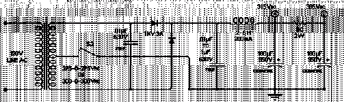

This is the B+ power supply schematic. I have 275-0-275 secondary. The switch seems OK right now. A short in the Hi-voltage secondary or any secondary can cause this problem.

With switch 2 open (B+), ohm out B+ to ground before the diodes. Should be pretty high if not infinite.
The orange drop before the diodes could be shorted. I doubt it, but
With the unit unplugged from the wall, ohm out the primary to ground. Should be pretty high, if not infinite.
Ohm out the heater taps to ground before the switch. Should be high if not infinite.
Double check the 5V are insulated and tied off.
Somewhere, juice is getting to ground and you need to find it.

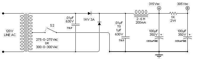

diodes
Silly question, but how do you measure diodes. With on ohmmeter, I get high values both ways (like 5 megaohm one direction, and 30 megaohm the other way).
anyway, i guess that shorted diodes will be 0 ohm, so it's ok if I get high values....
F
I just ohmed out a 270 FX which is slightly smaller and I got slightly higher readings. This shows that your readings are normal. This does not mean that the transformer is good (or bad) since the insulation could be breaking down under power. Power up the transformer with all secondaries disconnected. If the fuse blows, it is toast. If it doesn't, leave it on for about 1 hour. It should not get hot (slightly warm is OK) or make any smoke, or burnt smell. If it passes this test and puts out the correct voltage it is OK.

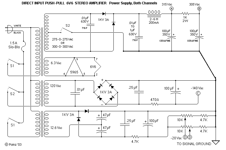

Main transfo OK
Hi, here is the follow up.
I disconnected all the secondaries on the main transfo, and power up. Fuse did not blow, so the mains transfo seems OK. Great news ($$$)
Now I reconnected only the B+ secondary, and the fuse went out. So I know that this part of the circuit is defective. I suspect the diodes, since I did heat them for soldering a few times, and one of them may have failed. I will rebuild the high voltage circuit all over again and check everything. I will improve some other things at the same time.
These diodes are 1000 volt 1 amp rating. The transfo is 275-0-275, so they have 550 volt RMS across them, that means 775 volt peak. I have maybe 125 volt max at the primary sometimes, so that put us at 837 volt peak. That's very close I guess. Is my calculation correct?
