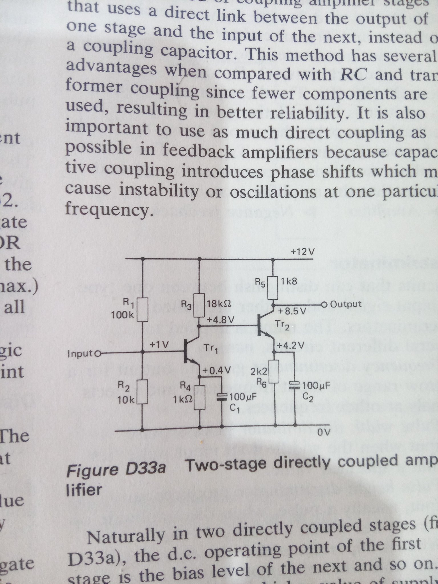

i have been 'trying' to experiment with transistor amps but cant seem to link one stage to another. i am using bc337-25's on a bread board with trim pots to adjust as needed. with a single transistor everythings fine, but when i try connecting the second stage it fails.

hi jan, so currently the bread board is dismantled from frustration, but the last one i tried was this. i made it exactly as it was in the book, and after adjusting the pots i could get a signal but it was less than the input signal and was very distorted. (electronics sourcebook for engineers p103)

That circuit does not have the required input (and output) coupling capacitors. If you connected your signal source directly to the schematic "Input", it will short out the "+1V" bias voltage.
In "short": 🙂
An input cap prevents the 1V bias voltage to be shorted to ground because the generator normaly has an output impedance of 50 Ohm.
Imagine a +/- 50 Ohm resistor from the input node to ground.
Also, you need an output cap to prevent the 8.5V of the output transistor to damage your speaker. They only like AC voltage, not DC.
The schematic doesn't show the caps because it focuses on the coupling of both transistors but you need caps in real life.

i have made a single transistor circuit that did not require input/output caps, 0-12v , no speaker, just the generator on input and scope on output, i got about 9V signal out and it was clean! did it work because i adjusted the bias pots to compensate ? if yes why cant i just do that all the time?

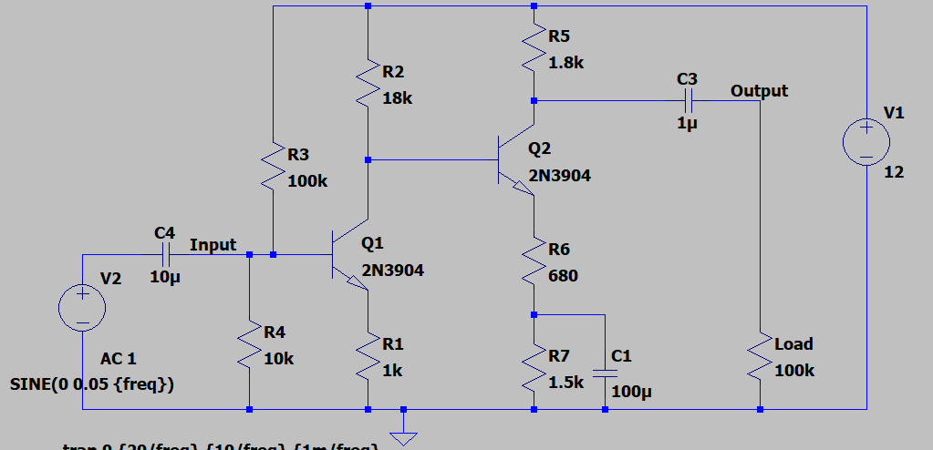

I think playing with these kinds of circuit is a great way to learn.
This circuit is designed for an enormous amount of gain (>10,000 from back-of-the-envelope), so even a 1mV input signal will be way too big! Here is a lower-gain version that keeps the same DC operating points but lowers the gain to something like 40 so will be easier to work with. Even then, input signals of about 50 mV are probably about as large as you can use before you see clipping.
If you are using the pots because you don't have the right fixed resistors, and just leaving them fixed at the design values then that would be fine. But I think it is a bad idea if you are using pots and randomly adjusting them after the circuit is built. My experience with directly coupled common-emitters is that they do not generally allow significant changes to resistor values without messing up the entire circuit (gains and bias points are very tightly coupled). Designing them takes careful thought, and randomly adjusting pots is unlikely to get you anywhere (or help you learn!).

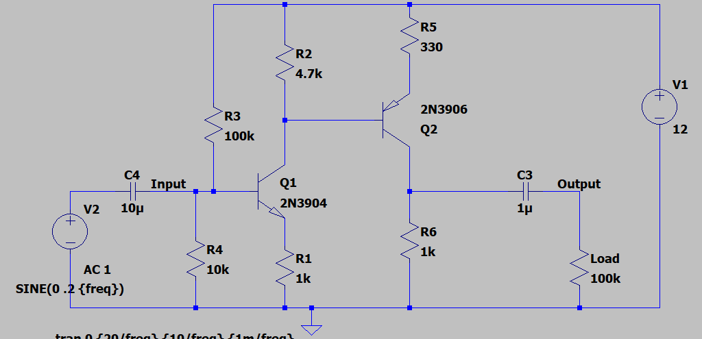

By the way, when cascading common-emitter stages (especially if you only want modest gain from each stage) you will quickly run out of DC voltage. It is easier to design the circuit if you have both PNP and NPN transistors available. Here is one with a gain of about 12. I don't claim it is optimized in any way, but it should work.

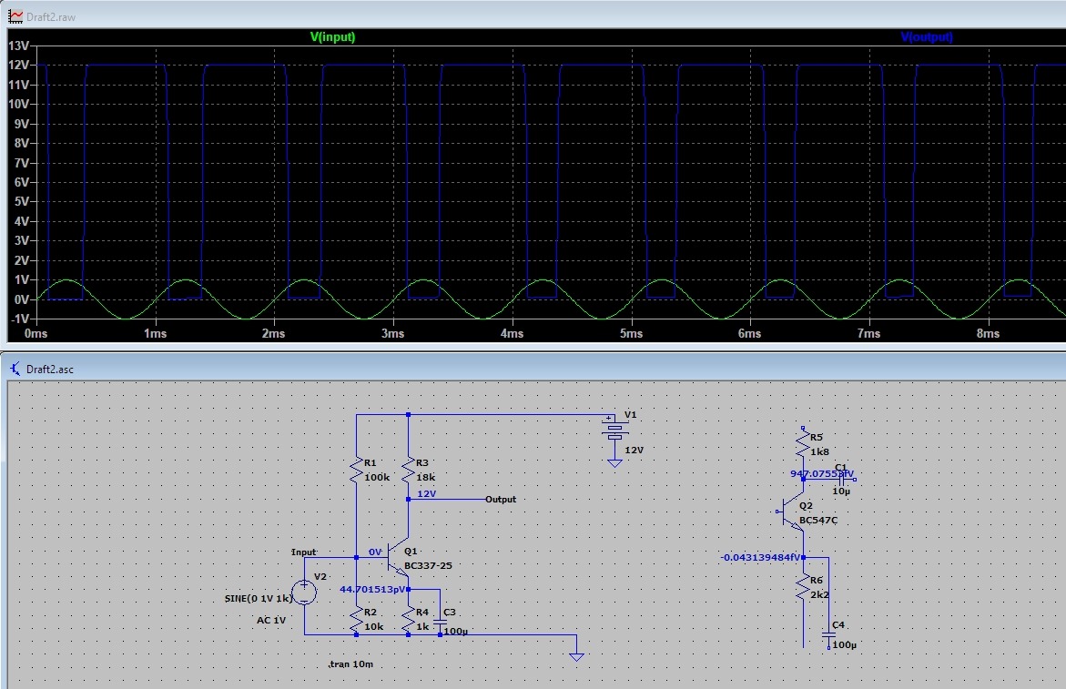

I assume you made the circuit as above with one BC337-25. Where were the bias pots?
This is what you should have seen with no coupling cap. Look at the DC values.
I have no idea how you got a clean 9V signal out of this circuit.

i do have fixed resistors but where i have been trying out different circuits, i have come to the conclusion that its easier to remove the pot, adjust it to correct value and then pop it back in, also being able to adjust it on the fly helps me see what affect it has on the circuit.
a quick question, on the schematics there is a 100k 'load' resistor, i havent used a load resistor yet in any of my circuits, they look like they form a high pass filter, is this what i would use to clean up some of the distortion i was getting in some of my earlier attempts ?

basically the schematic on the left but without c3 and with different resistor values. and yes about 9v
"where were the bias pots?" every resistor was a pot

I just put the 'load' resistor so that the capacitor isn't floating - it is not strictly necessary but I always include them on capacitor-coupled outputs. Yes, it is a high-pass filter at about 1 Hz or so. No, it will not clean up distortion in general.a quick question, on the schematics there is a 100k 'load' resistor, i havent used a load resistor yet in any of my circuits, they look like they form a high pass filter, is this what i would use to clean up some of the distortion i was getting in some of my earlier attempts ?
As Jason said, it better to stick to fixed ones that are carefully selected.every resistor was a pot
But we are past that point now.
It's a good idea to try Jason's second circuit.
You'll need both a NPN and a PNP.
In my previous post, discard the blue clipped square wave. I didn't refresh the sim.
It should be a stright line at 12VDC because by shorting the input to ground with the generator due to the lack of an input cap,
the transistor is not turned on an can thus not produce a output signal.
