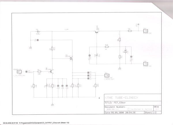

I have just installed the Fetishizator into my Rotel rcd-971 and although it is working and sounds great, the gain is too low.The dac chips are the Burr Brown pcm 63..pins 5 and 6 are shorted. I believe the Fetishizator was optimized for the tda1541 dac?..I hope the picture of the circuit comes through so to make it easier to comment.😎

That circuit does not have enough gain for those Iout DAC's you mentioned. Nothing you can do about it, apart from increasing the Iout resistor value and/or increasing the fetishizator gain, but both solutions will give high distortion / cripple frequency response. If you are happy with sound, consider using “interstage” gain - like the pre-amp, between CD player and amplifier.
