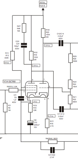

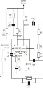

World Audio Design used the ECF80 as a phase splitter in several of their kit amps. The first time I saw this asymmetrical design I was surprised, but actually these simple amps gave quite good results at a comparatively low cost.
The attachment is just a snapshot of the circuit as I'm not sure of the current copyright status of these.
I have an old Scott "laborotory reference amplifier" that uses the same circuit. It does work very well and I have built a few duplicates of it that all worked very good too. The Scott used a 6BL8 but I used a 6U8 in my clones because I have a bunch. The 6GH8 works there too.
