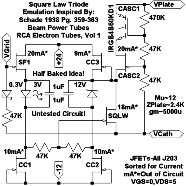

Triode Emulation (100% Sand)
Haven't breadboarded this yet, still cipherin component values...
Gonna post to tubes, but figured they'd just throw a hissyfit
I decided not to use a real tube this go round. Anyways, respin
of a very old idea by Schrade (RCA 1938)
He suggested a plate feedback method for emulating a Triode
abusing a 6L6 beam power tube. Which just so happens the
6L6 had the same sort of square law behavior as do modern
JFET devices.
He suggested that negative feedback in the Cathode was not
the same as negative feedback from Plate to Grid. At least not
as the load sees it... And the distinction does seem critical.
Only one JFET "SQLW" is working as a non-linear device with
light Drain Feedback, just as Schrade's Beam Power Tube did.
The rest rely on heavy linearization from Source Feedback, as
Source Followers and Constant Current Sinks and Sources.
Many emulations become unrealistic when they mimic a single
curved transfer function into a fixed resistance, and do not
consider real misbehaving loadlines over an entire operating
area... No big deal in a pre-amp, potentially very important if
driving a loudspeaker.
Anyways, I present a general purpose triode emulation.
Not intended to rigidly mimic any one specific device.

Unless you make some changes, the feedback scheme will
fail around 150V Plate... A first draft that may not work at
all, so don't go running out to build one just yet.
Explaination
The cascode stack on the right multiples drain voltage by 12,
or divides VPlate voltage by 12. Same thing, only different...
CC2, CC3, and the Zenier simply set a fixed voltage drop from
the drain to the gate for bias. CC3 Sink may be omitted when
IPlate can tolerate the added DC.
CC1, Source Follower 1, and the LED set a small voltage drop
to compensate for VGS rise (is depletion bias an anti-drop?).
Anyways, you might do away with one drop diode or the other
if you tolerate some DC through the mixer.
The pair of 47K's in the feedback mixer (to the gate of SQLW)
average the input signal against the drain feedback signal.
This point is not expected to zero out, but move around the
triode and square law region of the JFET's operating area.
SQLW sees 1/24th of the VPlate (suggesting a Mu of 24!),
but also only 1/2 of VGrid (knocking Mu back down to 12).
J203 currents in the schematic above, refer to part binning
by wide open VGS=0 current. Not currents one is expected
to measure in the running circuit.
And I misspelled "O.H. Schade" not "Schrade" . Whoops!!

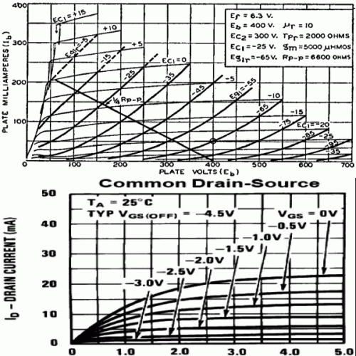

Graphs to show square law similarity between 6L6 and J203,
especially in the constant current region. I think if the scales
were presented a bit different, they would look even more akin.
No reason the 1938 trick wouldn't work just as well today!
Remember, those 6L6 Triode curves are not "Triode Strapped",
but Triode emulation based on Schade's feedback scheme.

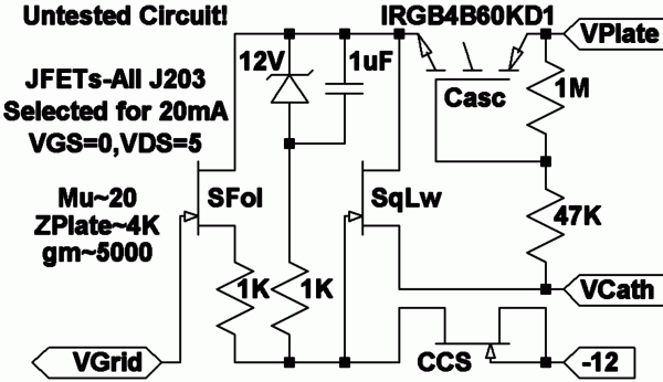

Hah, without knowing I seem to have "invented" that, too (although I have the book the Schade article is taken from).
If the goal is only to get triode/UL-like curves but not replacing actual tubes in circuits, I have a simple JFET version (sligthly simpler that yours) that works pretty well, ie as preamp stage. Everything is just scaled down in level.
The basic idea is exactly the same as Schade's: feed part of the plate voltage back to the grid, he did it with passive AC divider and then letting the gate voltage ride on top of that (pg. 41, fig.33c). If you have an input xformer this scheme as is would work equally well with any FET.
I divide down the drain-to-input voltage which then feeds the gate, after being offsetted with a current source. This looses some gain, though not much, as the resistor ratio can be quite high. The gate is isolated with buffer to retain high input impedance. One can/must use a buffer (bjt is OK) an the drain if the divider needs to be isolated from the drain load.
As usual with FETs, some measures must be taken to stabilize the operation point thermally and it needs to be trimmable too, to compensate device-to-device changes (or you select your FETs very well). Some modulated cascode option are doable to linearize the output characteristics very well and shift then a bit further to the left (UL-style curves), but then biasing gets tricky. As I was after that typical triode curvature's sound and supply sag gain compression character (not a HiFi-application, but electronic instrument amp) I settled with this simple arrangement.
- Klaus

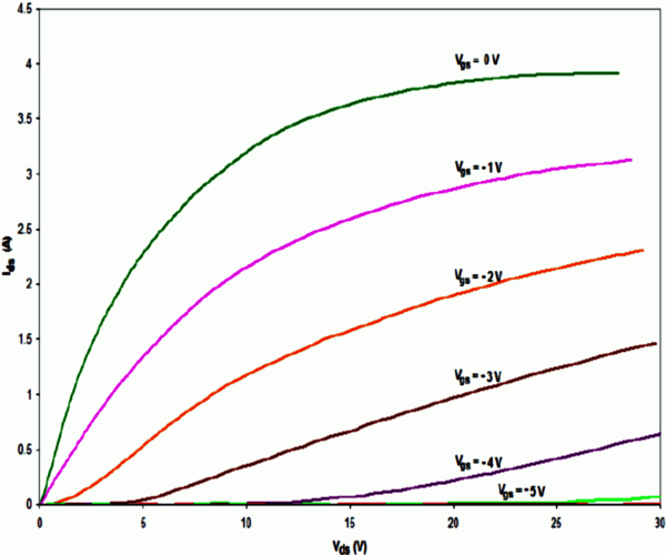

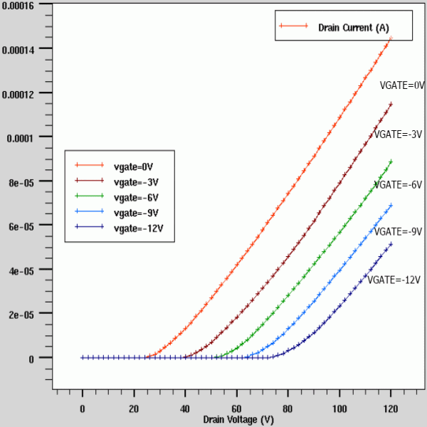

There are some Mosfet like devices called Static Induction Transistors that have very short channel length. They have triode like curves, without the need for the drain to gate resistive feedback, since the drain potential affects the field in the channel. Unfortunately, they don't seem to be commercially available, just research devices. I did hear some while back however that someone had built an amplifier with them that was commercially available at very high $$$.
The construction of the SIT devices even looks like a triode, but embedded in silicon. The gate is just a linear grid like array of dots.
Don
I have no idea which SIT these curves were measured from?
Found this graph in a paper "2003_EPE_Final_Paper.pdf" found
while searching "Static Induction Transistor".
Sorta Triodish, very A2... I'm sure than when/if real devices fall
into our hands, we can then cherry pick a better set of curves.
Anyways, it all the same thing only completely different.

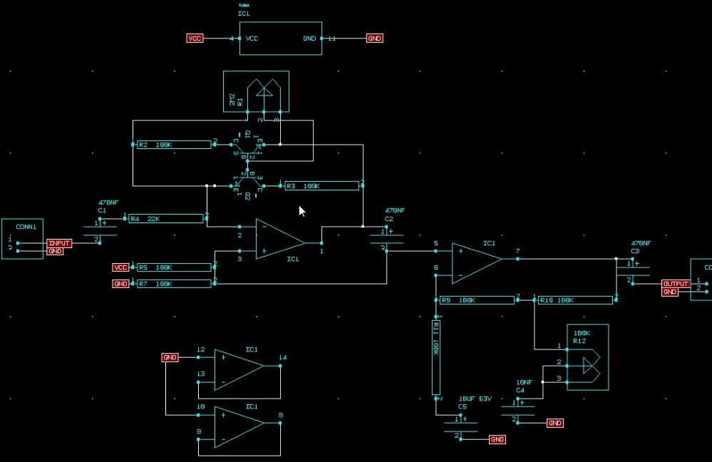

I think what you are looking for is a soft limiter as soppposed to a hard limiter as per transistors.
I built one in the 1980's from a cct out of a magazine.
I have tried to rebuild the cct from memory but it is clearly wrong as the bias is modulated by the second stage.
It needs another bias pair of resistors.
If I remember correctly you tweak the pot until you get the sound you want.
I enclose the cct digram anyway.
I have tried to rebuild the cct from memory.
Not sure if it is correct but looks about right.
The output stage has a soem serious treble boost which is great for lead guitar.
