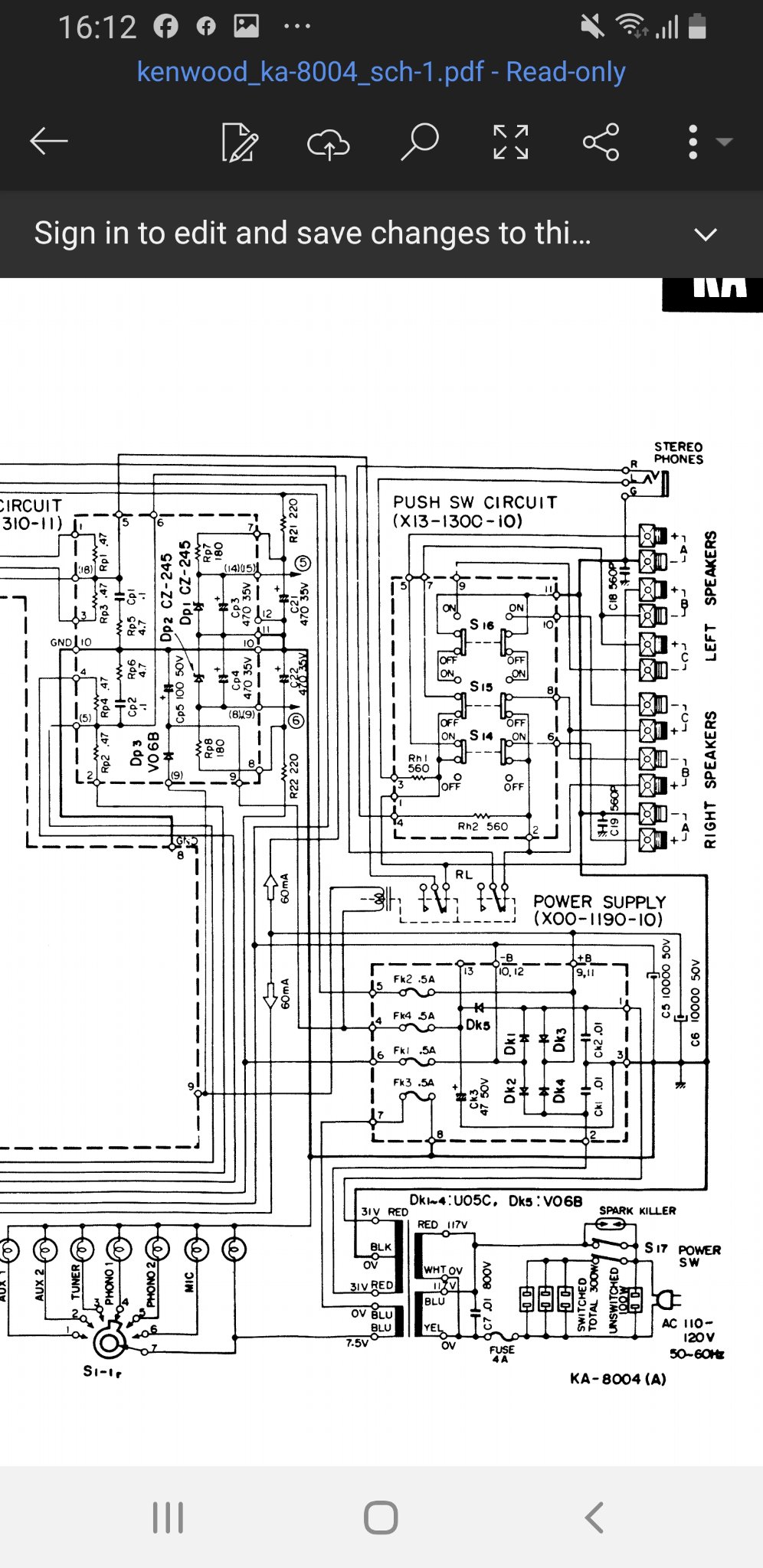

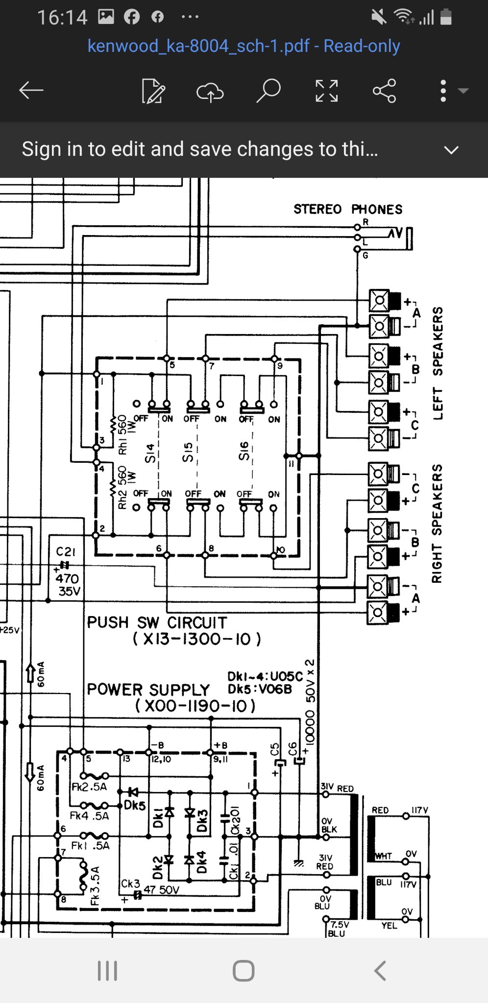

Hi everyone, Bazza with questions again..so can I. I have small arcam muso speakers, very nice sounding. I have 2 pairs and wondered if I could connect to amplifier without stressing other. I could connect in series to speaker inputs A but wanted to know if I could connect to B and C because on diagram it looks like B and c are in series in the amplifier itself. Pics

Ok so use either a,b or c and connect in series to any. I have option for 3 pairs of speakers but even I know connecting and using 3 pairs at the same time is stressing the amplifier. I don't want to do that because the ka8004 is a wonderful amp. Ok thanks for your reply.

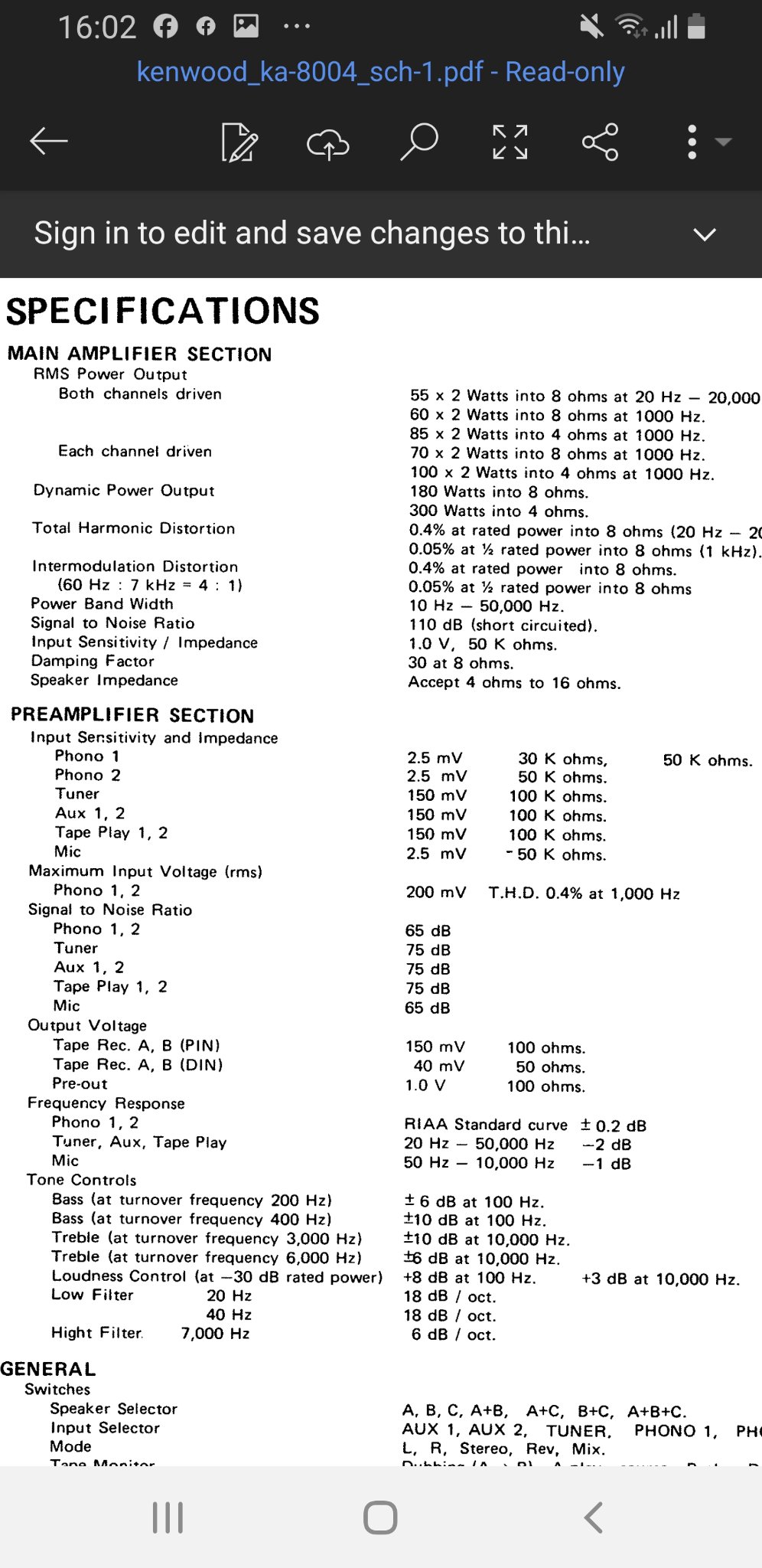

Your speakers are 4 ohm, and your amplifier can support 4 ohm speakers. Putting them in parallel, well the amplifier would not like it. Like I said accidents happen. Enjoy the day.
It supports 4ohm but not 2 pairs at the same time I.e Channel A left and right and channel B left and right.
Is that right? So best thing to do is connect in series in either of the 3 available pairs of channel's A,B,C.
Internally it looked like B,C are in series, your right best not to risk it. Cheers

- Trio KA8004 can i connect 2 pairs of 4ohm speakers e.g 1 pair in B and other in C. The diagram to me looks like b and c are in series.
