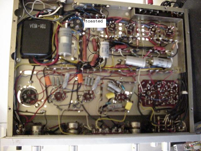

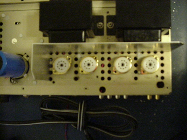

i should have replaced the tubes when replaced the sockets
there super old original the geter was dark brown on some
i live close to the tube store so it will be a easy fix. from what i can see it was only one resister that is bad. we shall see

I have a Kenwood KW-70 (Trio = Kenwood) receiver that almost suffered the same fate. Question, have you replaced any of the coupling caps tot he 7189s? When I first fired up my receiver, the plates of the 7189s would glow red hot in a matter of a couple minutes. Was caused by leaking coupling caps - bias voltage would drop to ~10V-12V. If this is the cause, is an easy fix

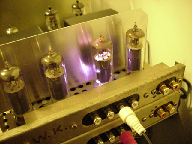

its weird how it all started. can u kill a tube by moving the amp when its powered up? the amp was on a speaker wire so i dragged
it over thats when the tube started shooting sparks in the filament.

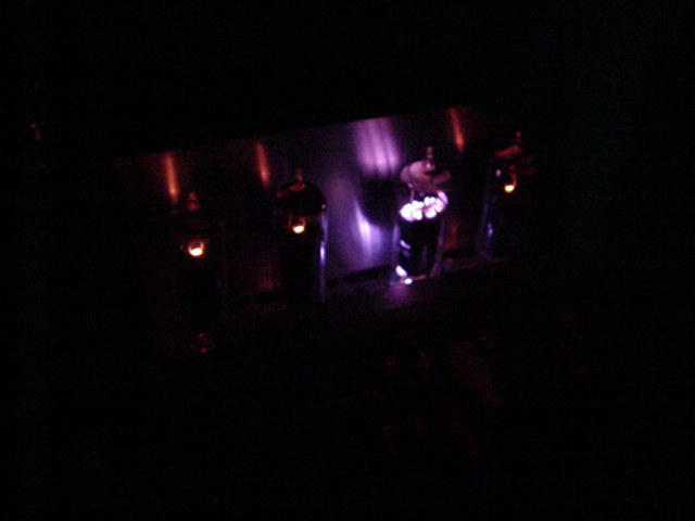

I looked at the first photo and saw a milky white color on the top of the tube that is glowing. That color indicates that the tube has lost it's vacuum seal.
Before your install new output tubes, make sure to check the d.c. bias supply (if the amplifier has fixed bias) and replace all coupling capacitors that have a d.c. potential across them.

I would not expect a the amp to smoke simply by moving it - even if the speaker wires shorted - at least not for a couple seconds (thinking more like a few minutes). More likely something shorted taking tubes with it. Tubes are surprisingly robust and can often tolerate several times their spec rating before dying. Hmmm, thinking a short is more likely. Also, on my receiver, almost all of the grey coupling caps that isolated/coupled any significant voltage were leaking badly.
