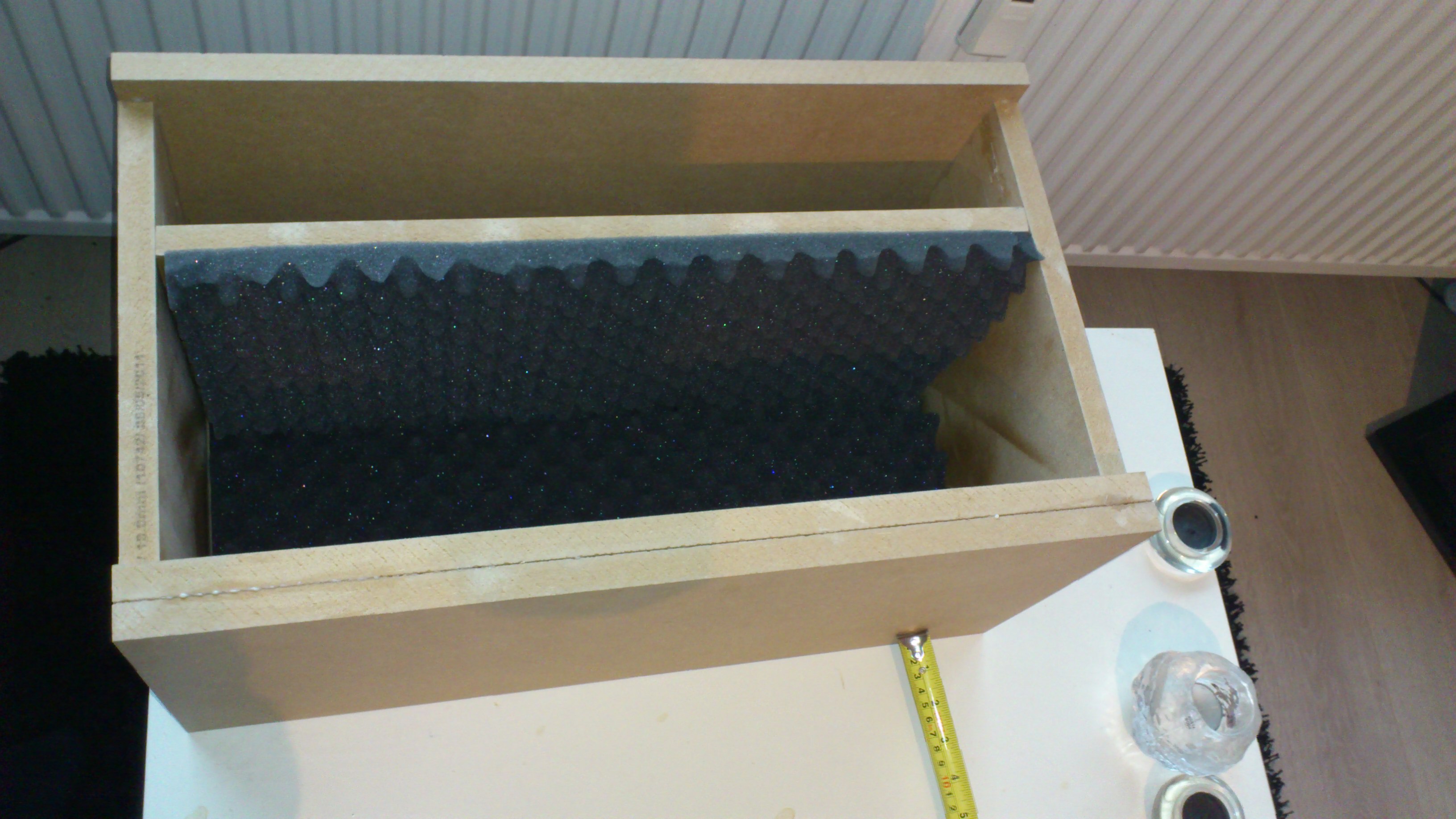

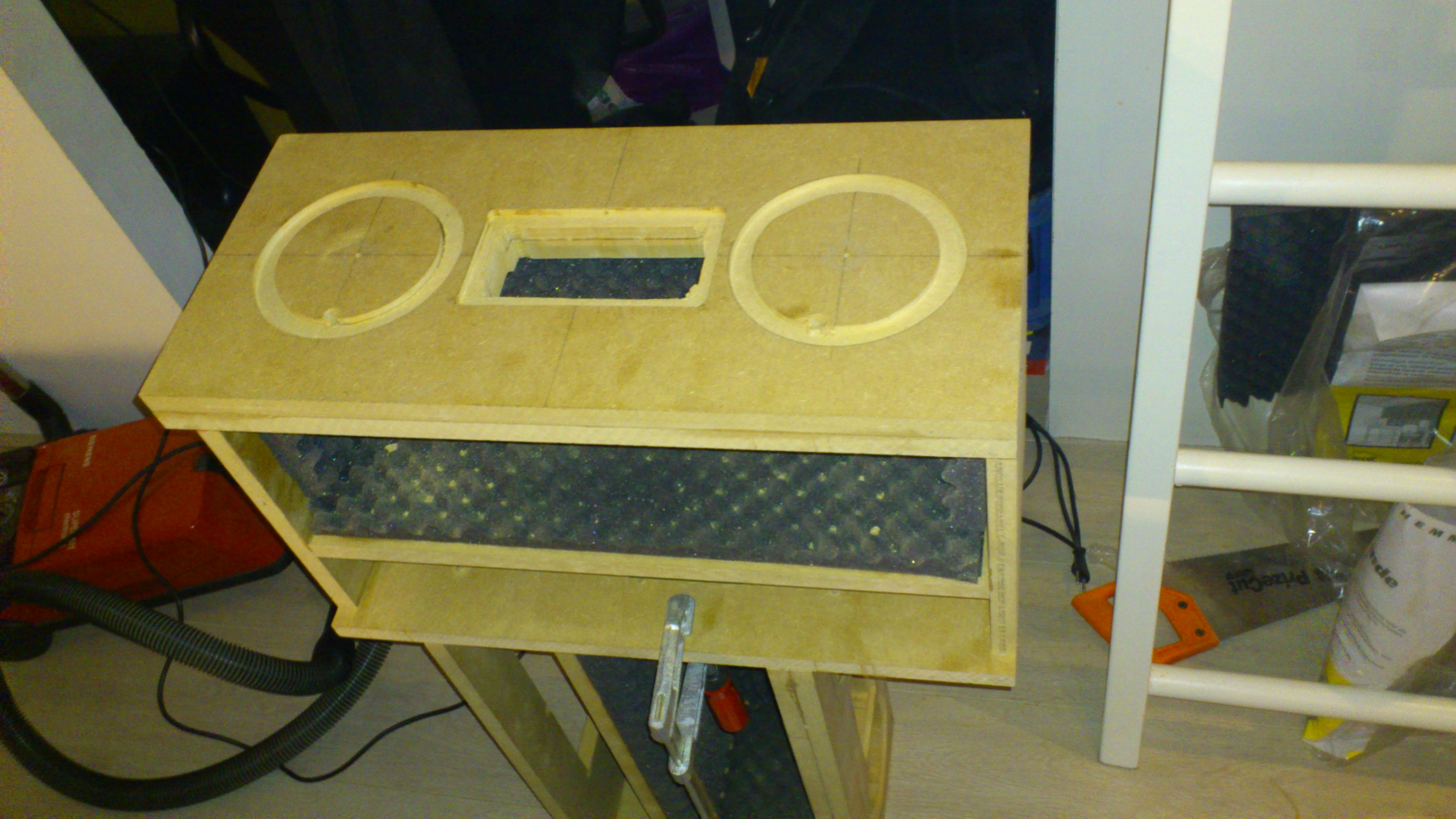

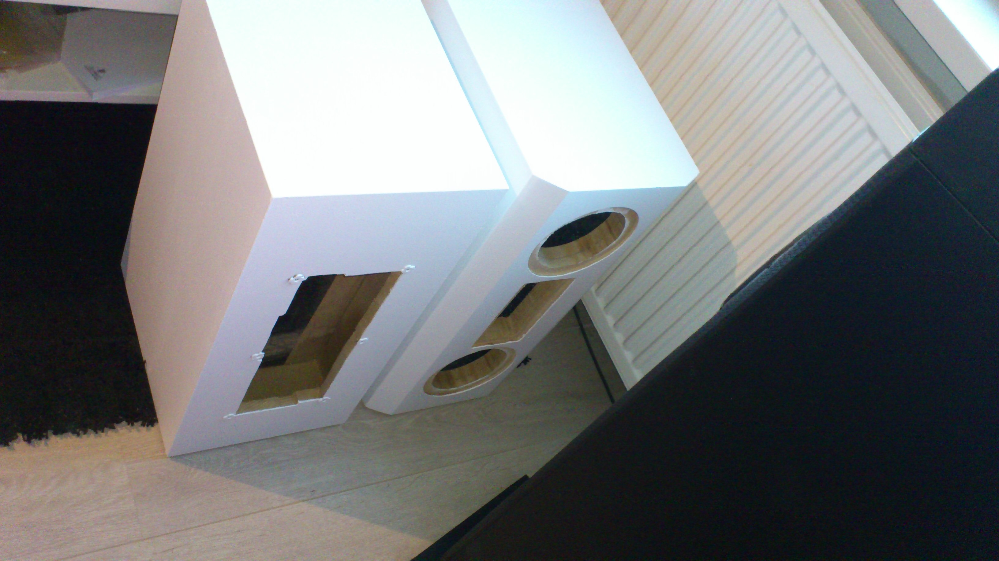

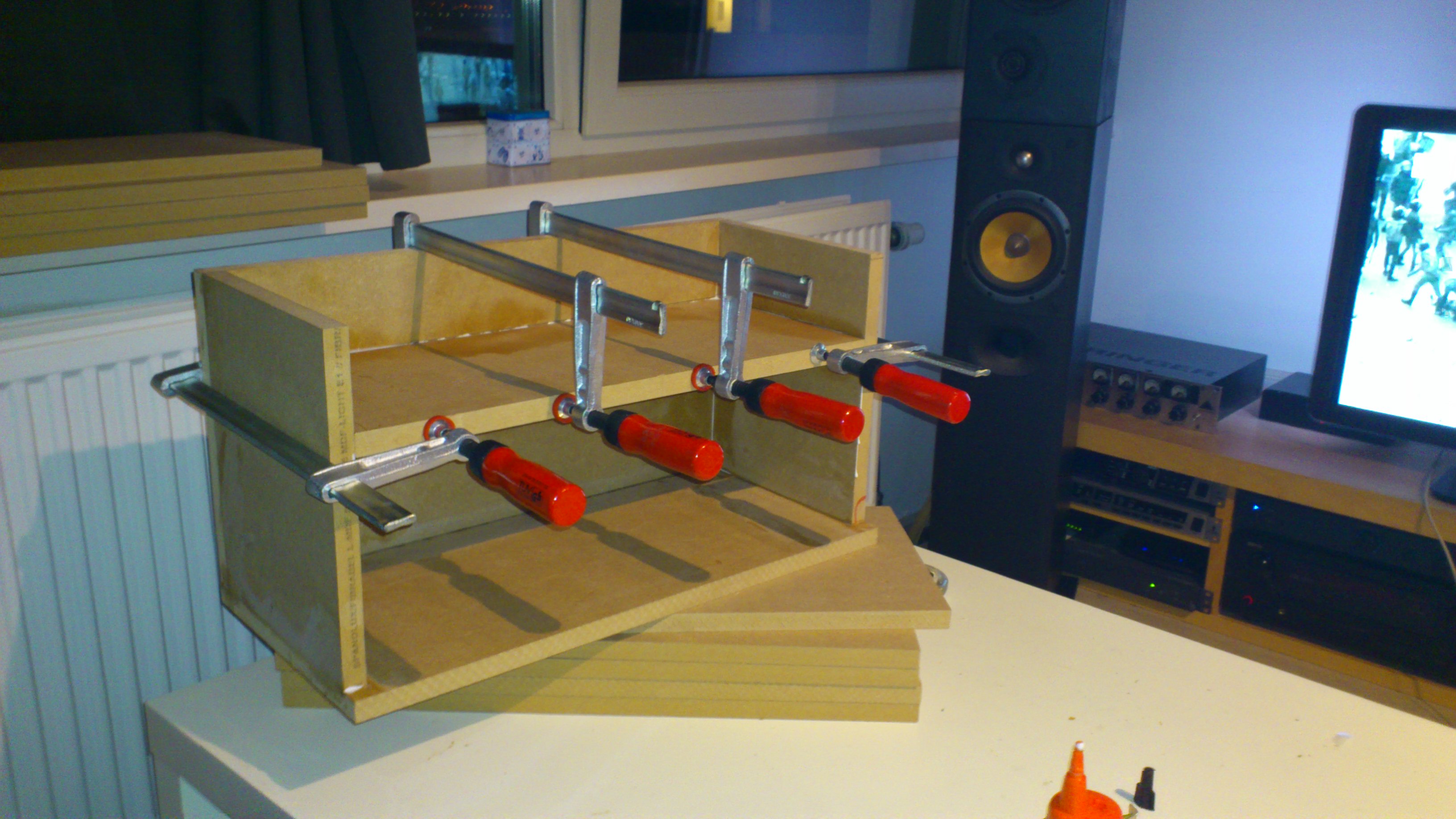

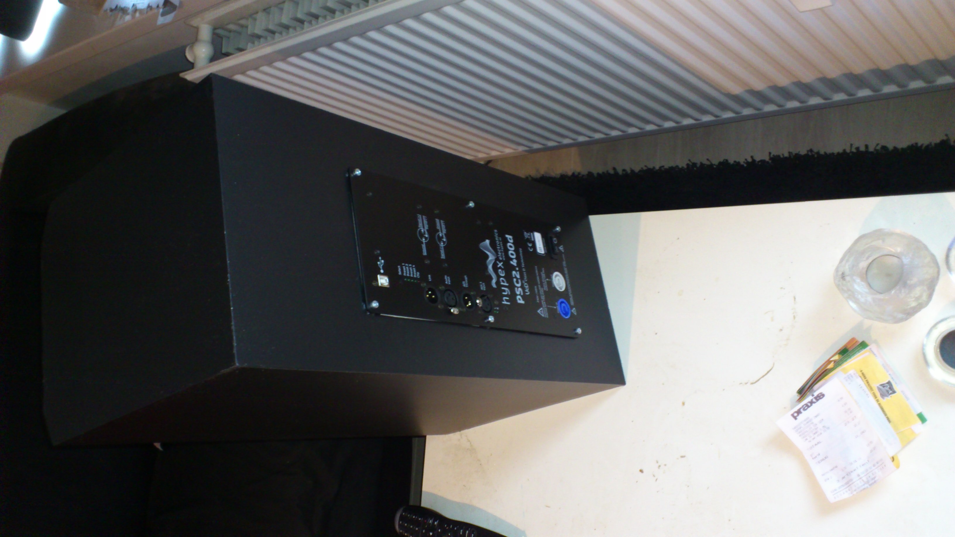

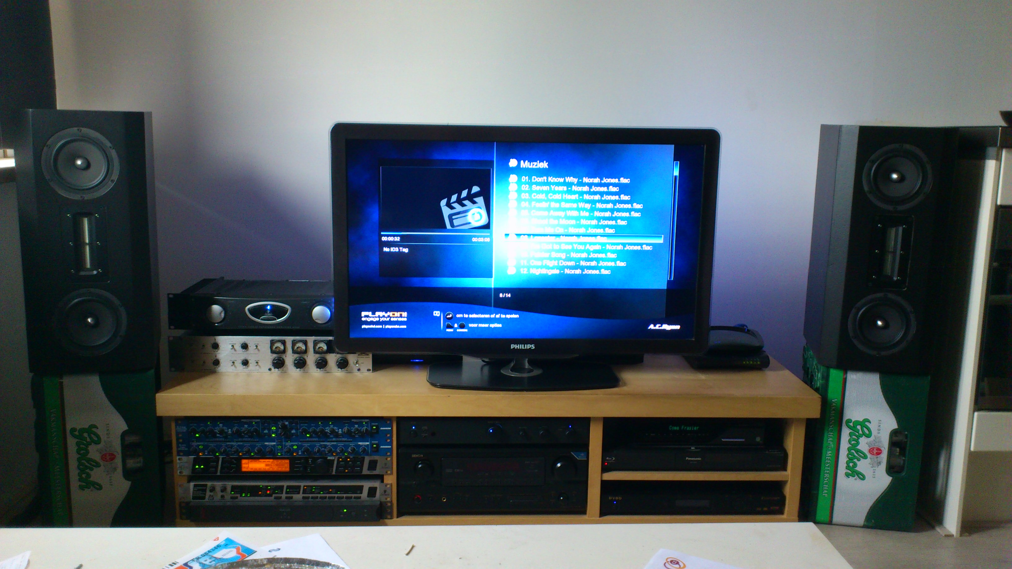

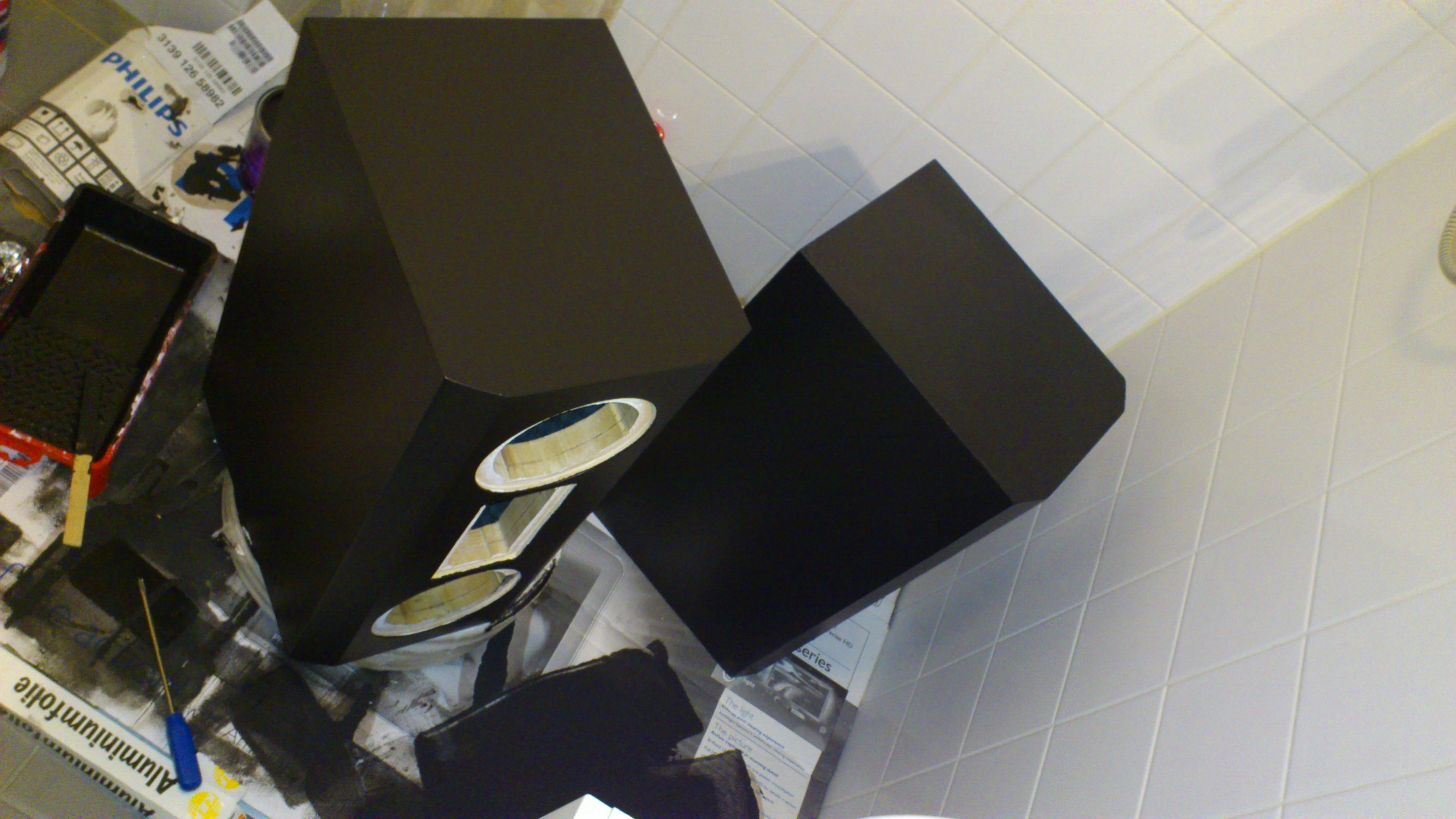

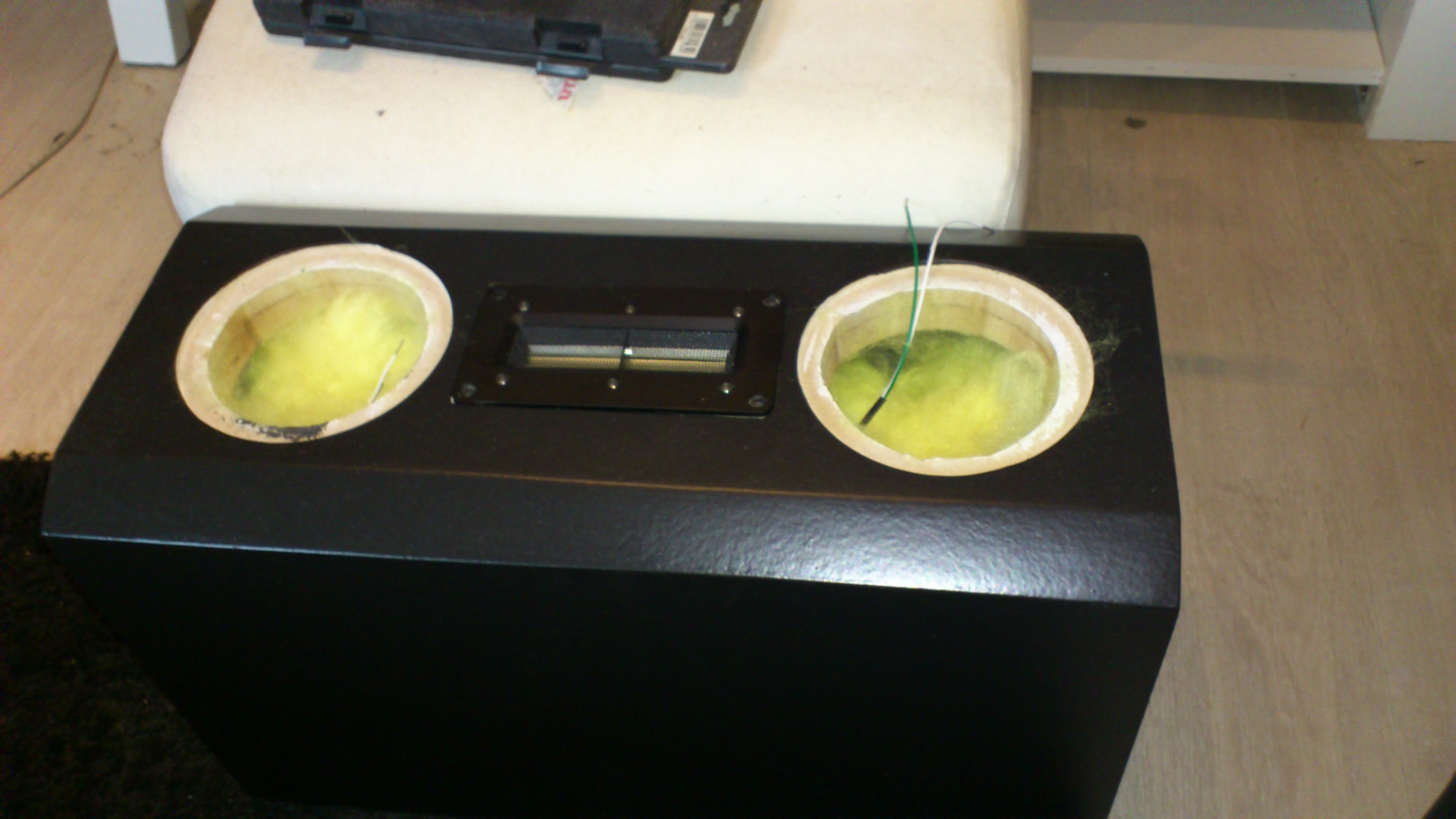

I like to share my latest build. It's a active 2 way based on the Hypex PSC2.400d modules.
The PSC2.400d is a plate amp loaded with very nice features; 2x UCD400 amplifiers, a SMPS and a powerful DSP.
The drivers are 2 Seas W15LY001 midwoofers and a Fountek NeoCD2.0 ribbon tweeter in a MTM. The crossover is LR8 @ 3.5KHz time aligned.

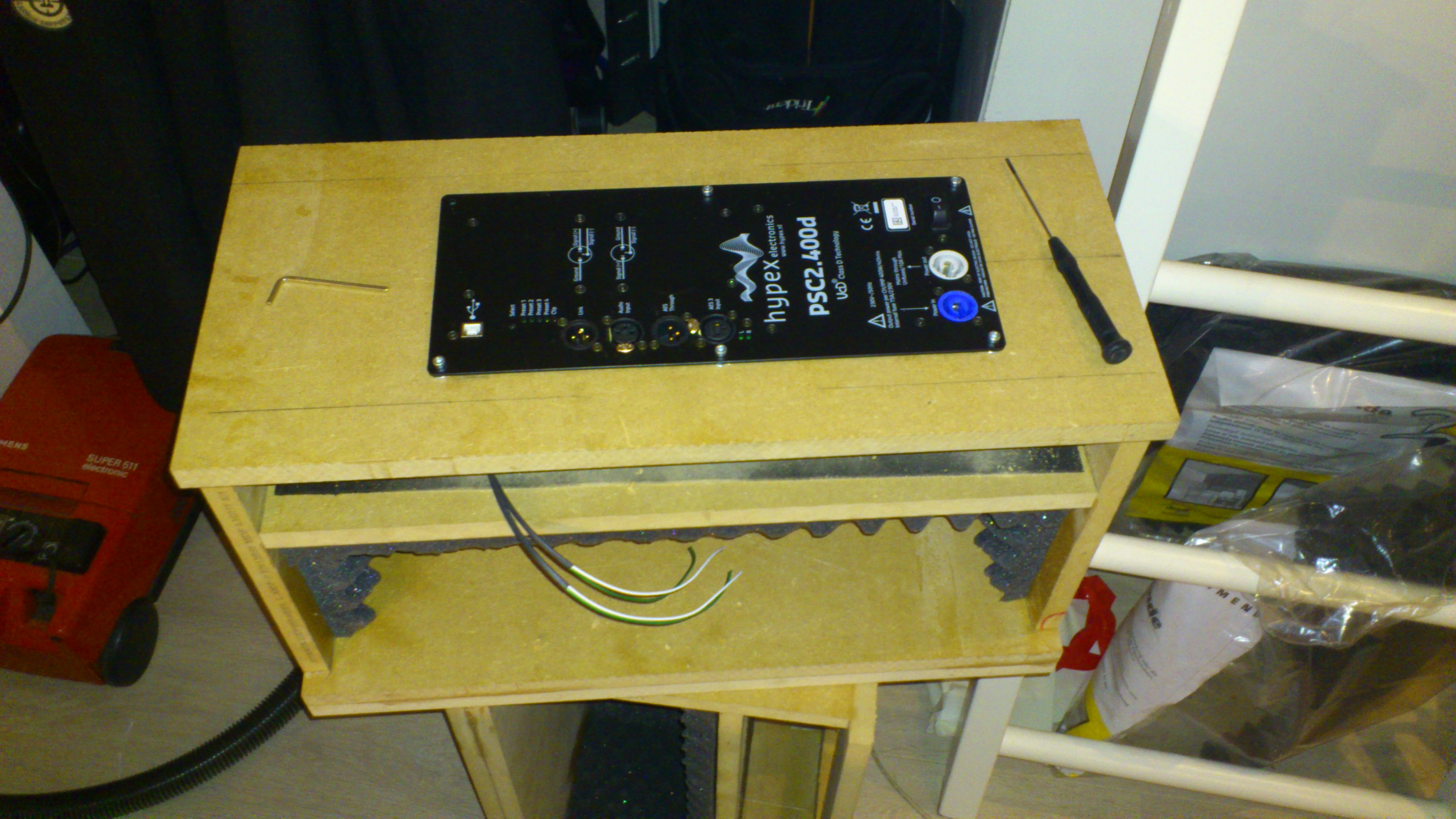

The cabinet is a closed design with a Q of 0.71. The front is made of 36mm MDF (2x 18mm glued), the rest is 18mm MDF. Internally the cabinets are damped with
"loodbitumen" (2mm) this stuff is also used in car doors, pritex (4cm) and angel hair (100g).

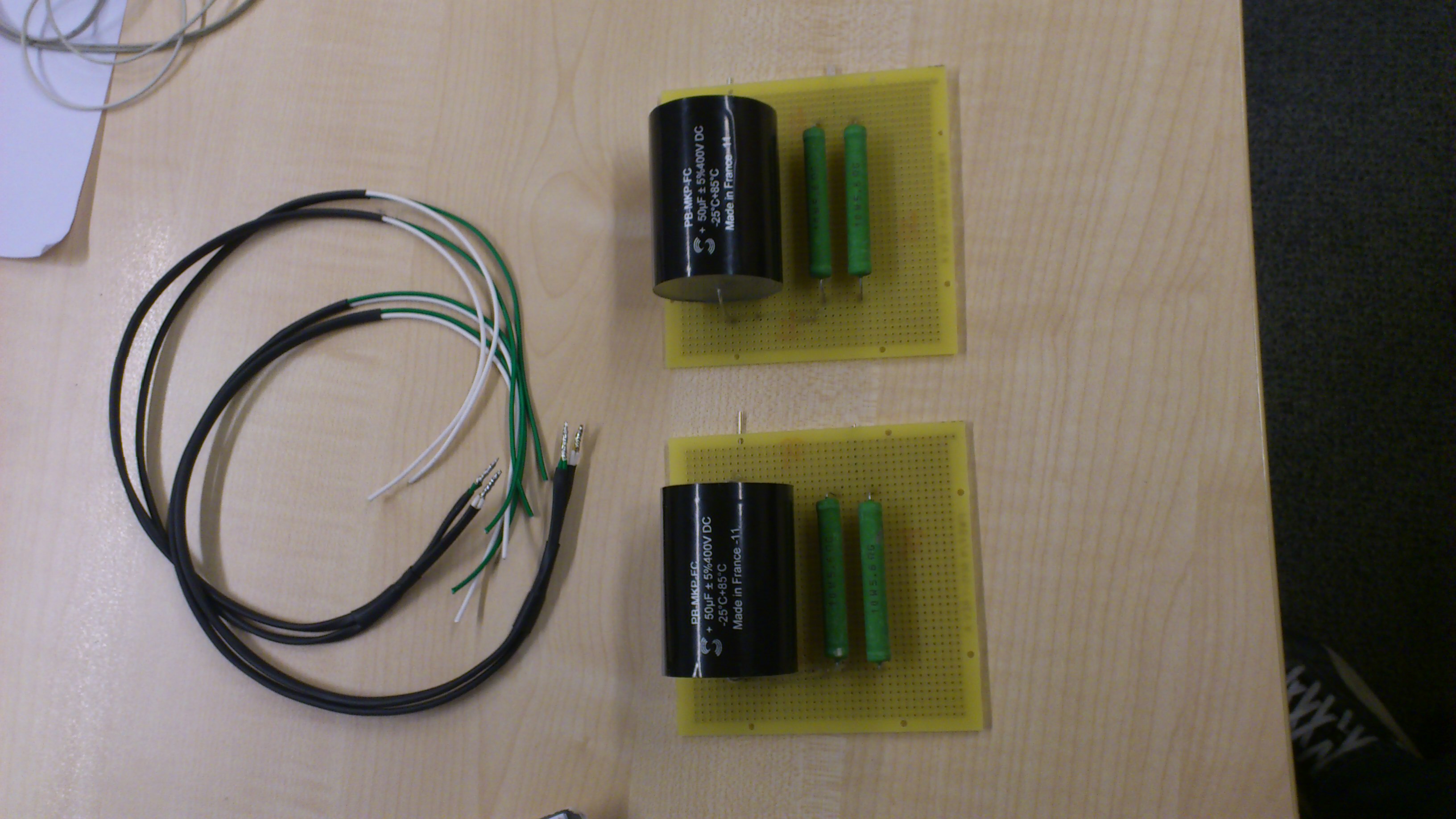

The "filter" thumbnail is not really a filter but more of a safety measure for the tweeter. It's a 50uF capacitor followed by 2 5.6Ohm resistors in parallel. This provides protection against DC and some attenaution and does not influence the filter inside the DSP.

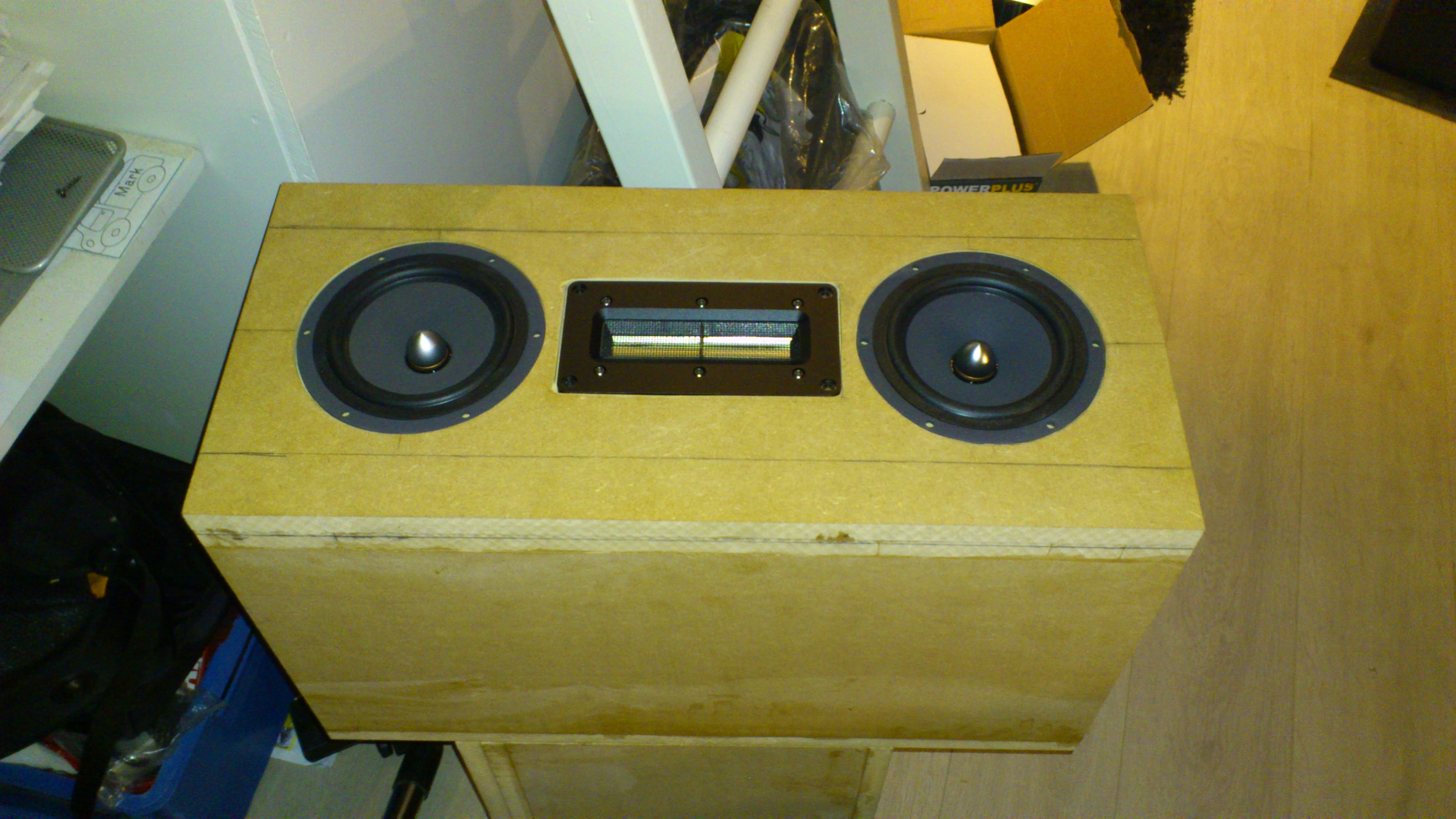

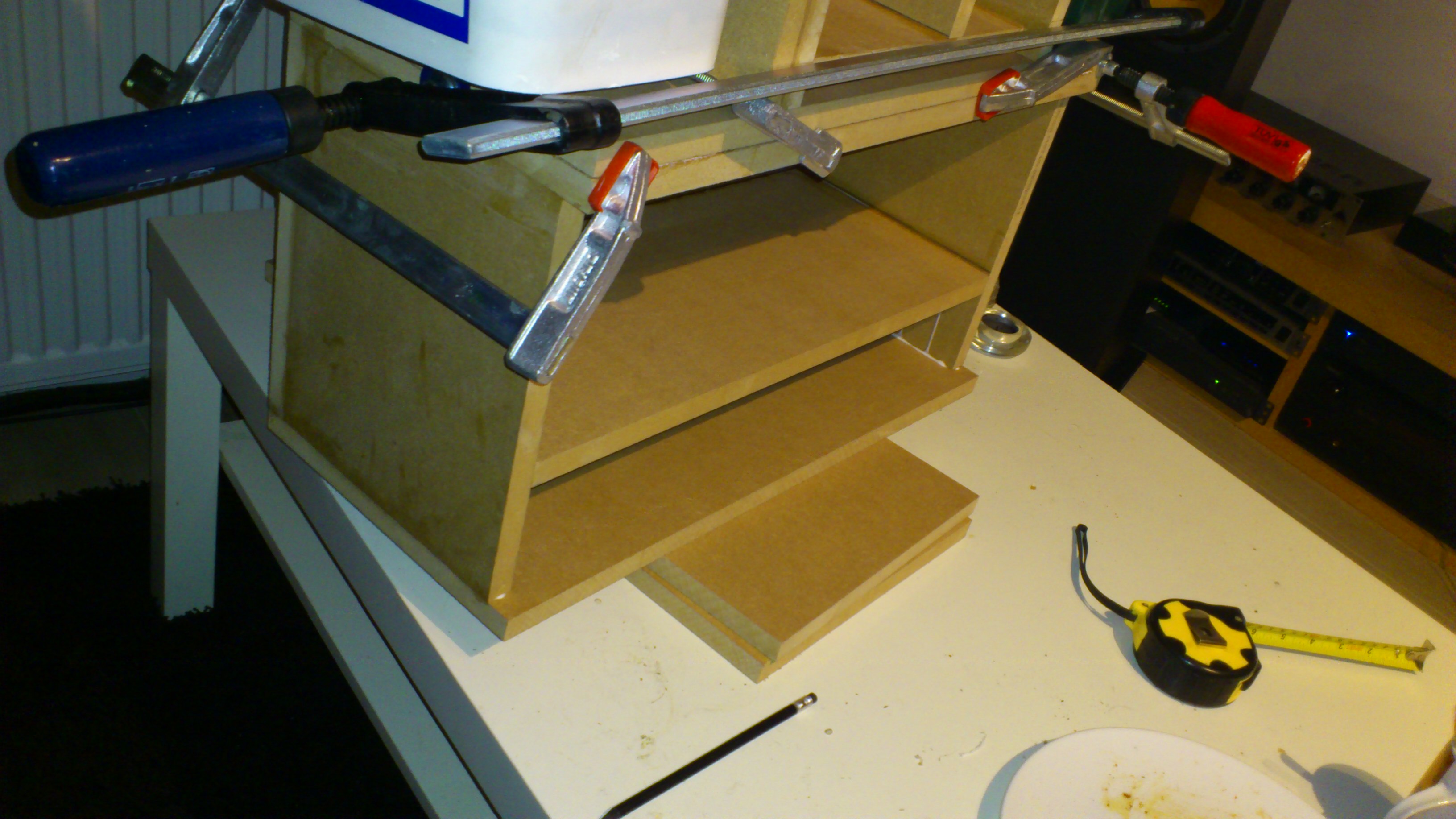

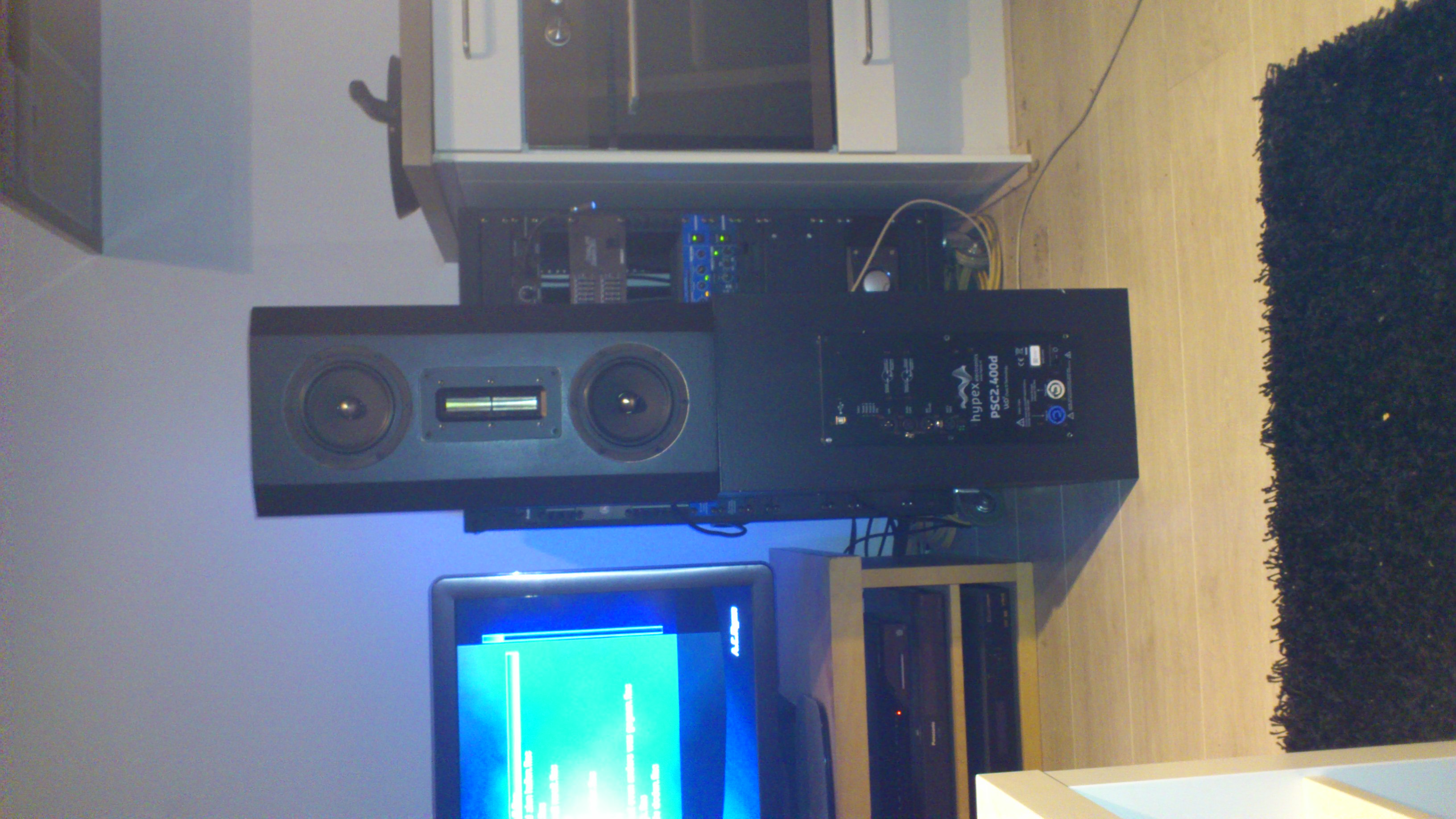

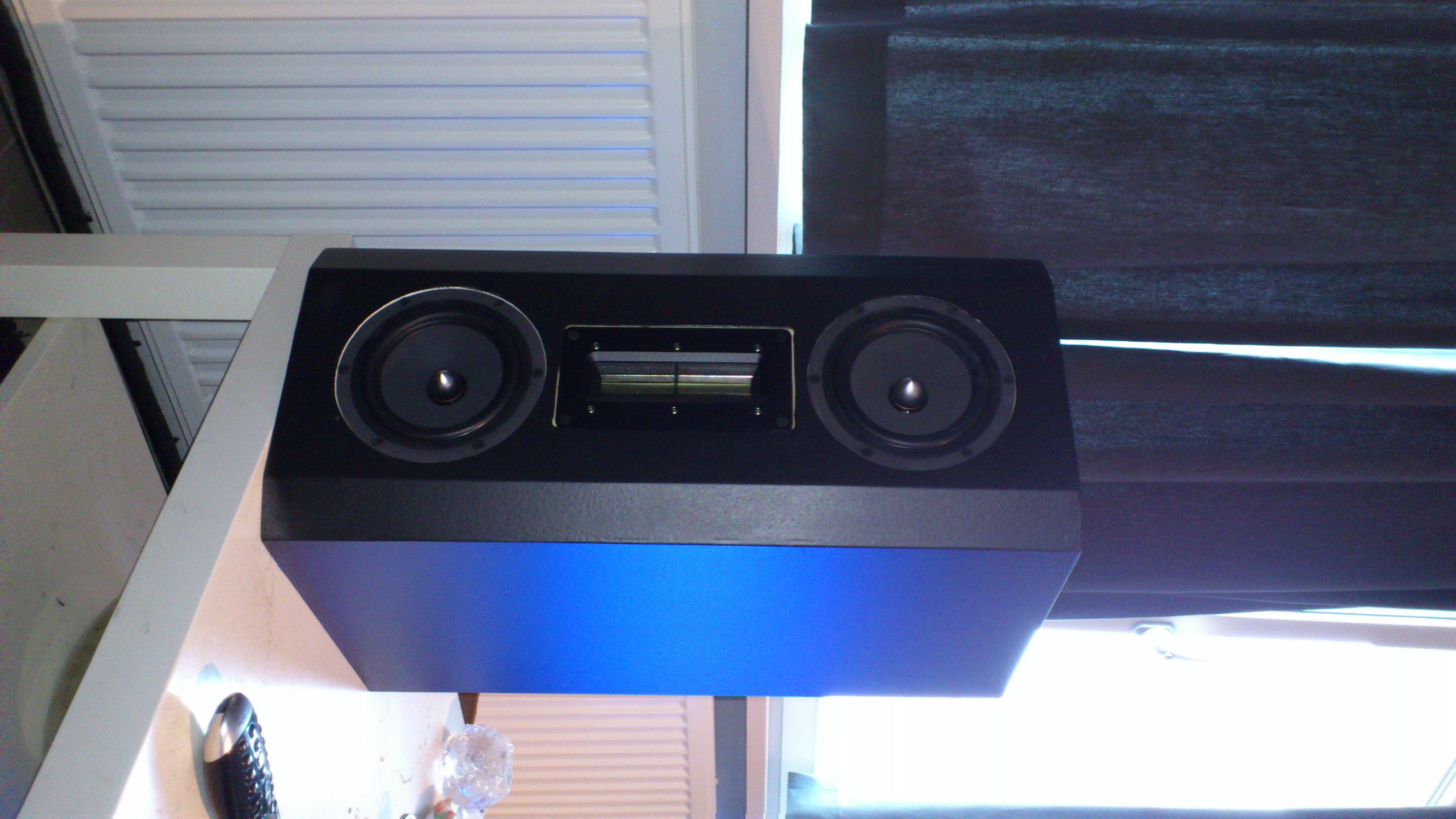

More photo's.
I live in a really small apartment so my living room doubled up as a workspace for building these speakers... I don't think i've ever vacuum cleaned my living room as much as I did while building these speakers 😛

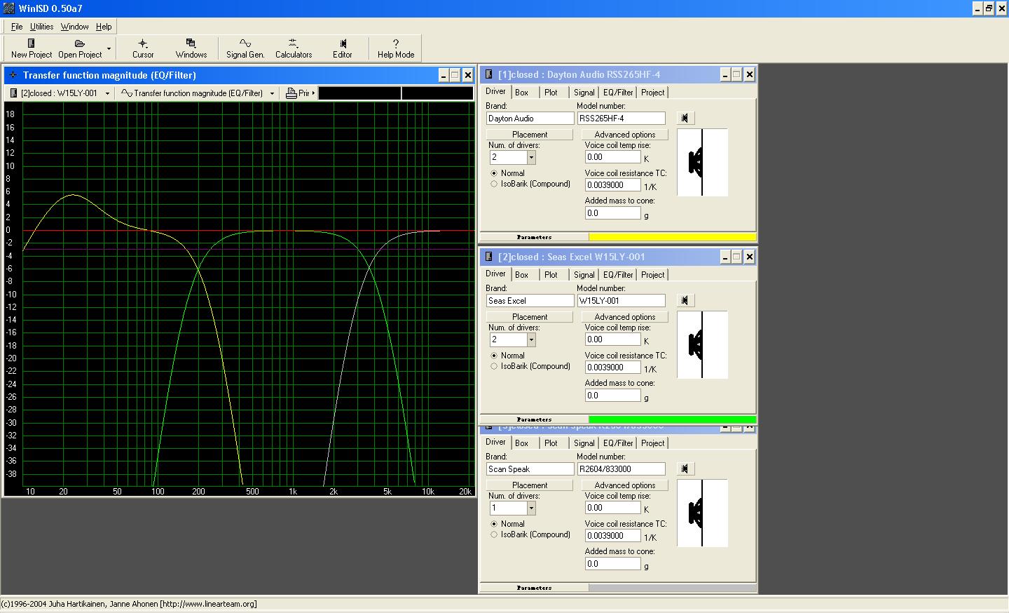

Hi LineSource,
Thank you!

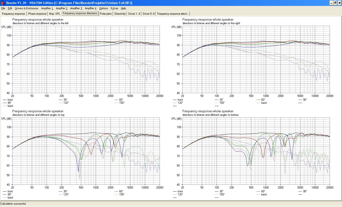

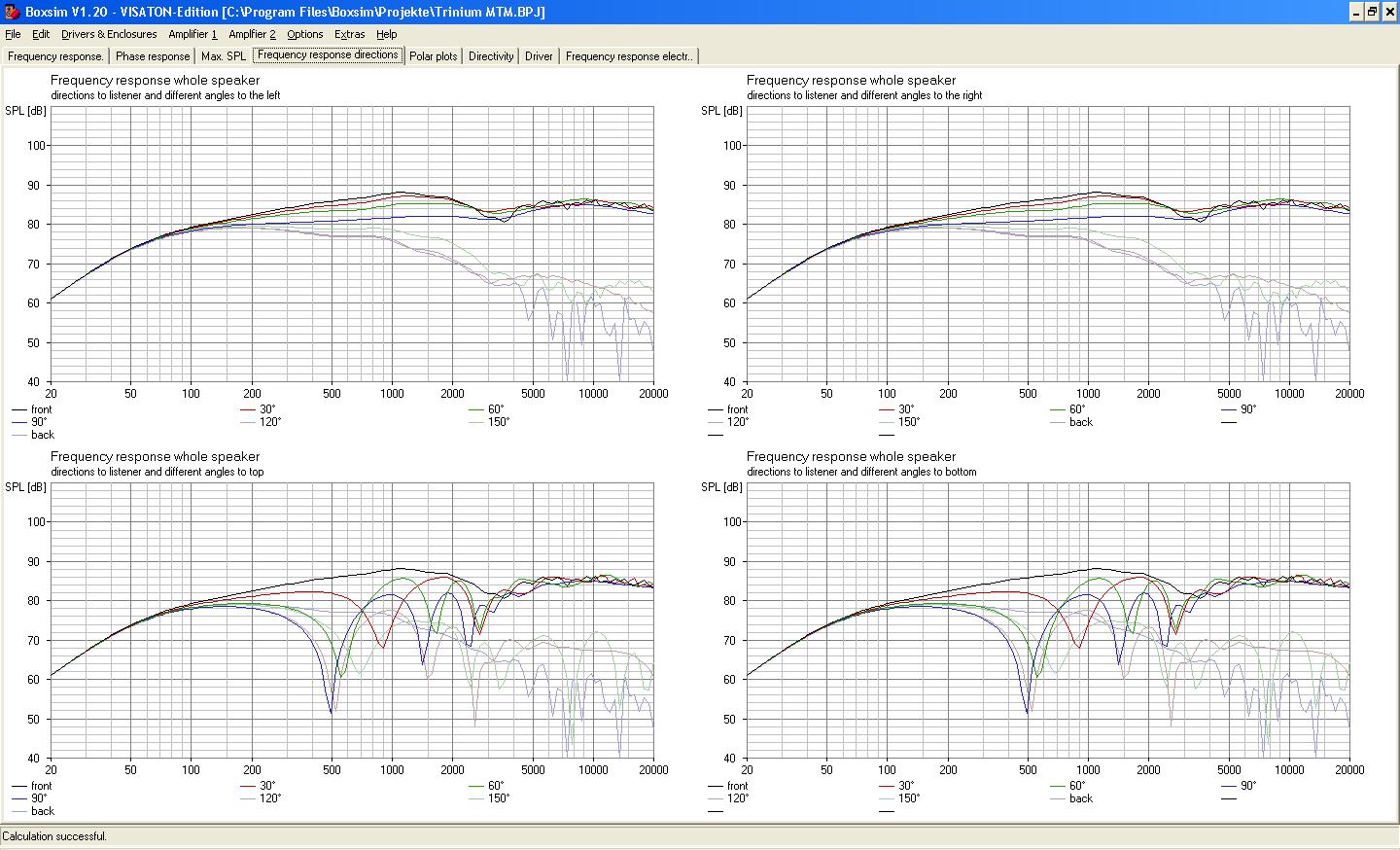

Yes I know vertical lobing is a problem with such a setup. Did a lot of sims with WinISD, Boxsim, Edge, Xdir and AADA before starting this build. In the end I just wanted to try a big ribbon to see what they can do with good amps and DSP filtering.
With these drivers you need a 3KHz minimum XO to avoid distorsion problems with the tweeter. (hence the Nextel woofers in stead of Magnesium) Which of course translates to vertical lobing problems and comb filtering effects. I am playing with the idea of a NTM type crossover to push the XO frequency a bit lower.
In my setup I don't really care about the vertical lobing because I just sit down in 1 place to listen. Heck I even use a modded DEQ2496 for some room correction... attached an early Boxsim sim (no DSP data included), it gives a rough idea of the polar response and comb filtering effects.
Edit: because of the vertical response pattern of this tweeter you will always have lobing, no matter what type of driver arrangement you build!
Thank you!

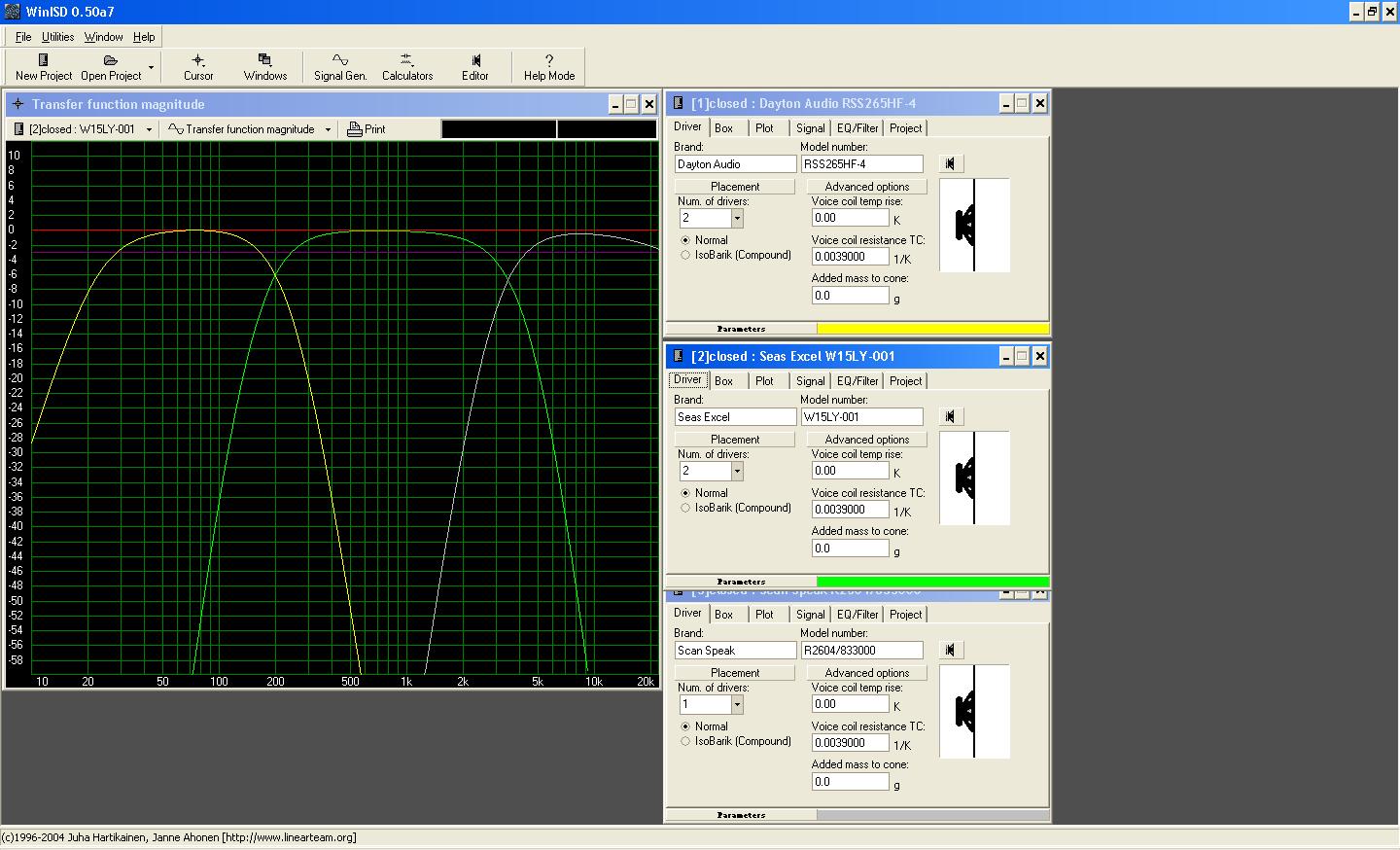

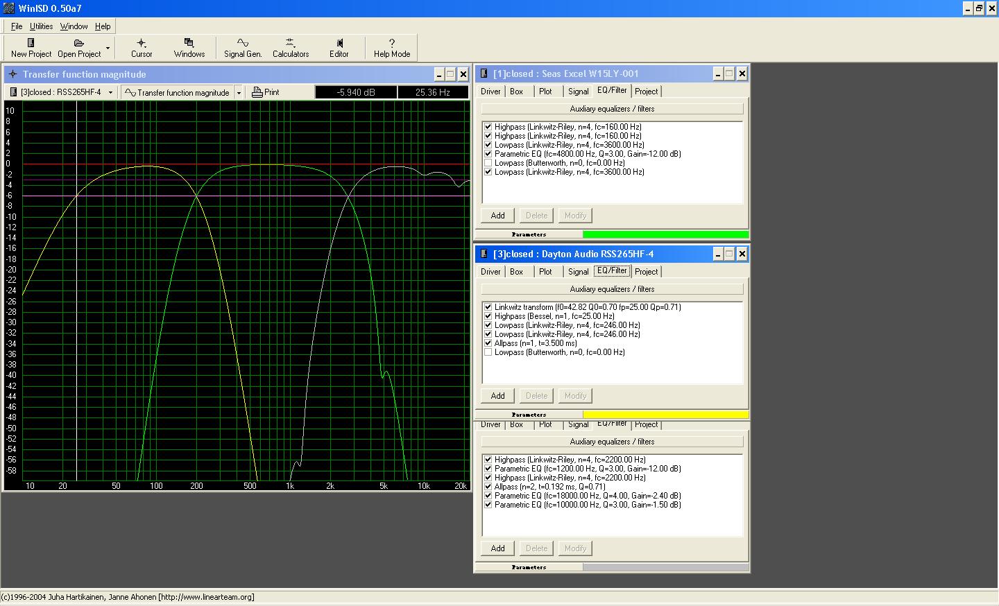

And the response plots of the planned system when completely done (active 3 way with 2X Dayton Audio RSS265HF-4 per side added)
I like the overall response in the 200-600Hz region for reducing floor and ceiling reflections down where they're harder to deal with.
But looking at the horizontal response I notice also that between 200-2k, the zero degree axis is higher than the overall response. So this might benefit from the right toe-in.

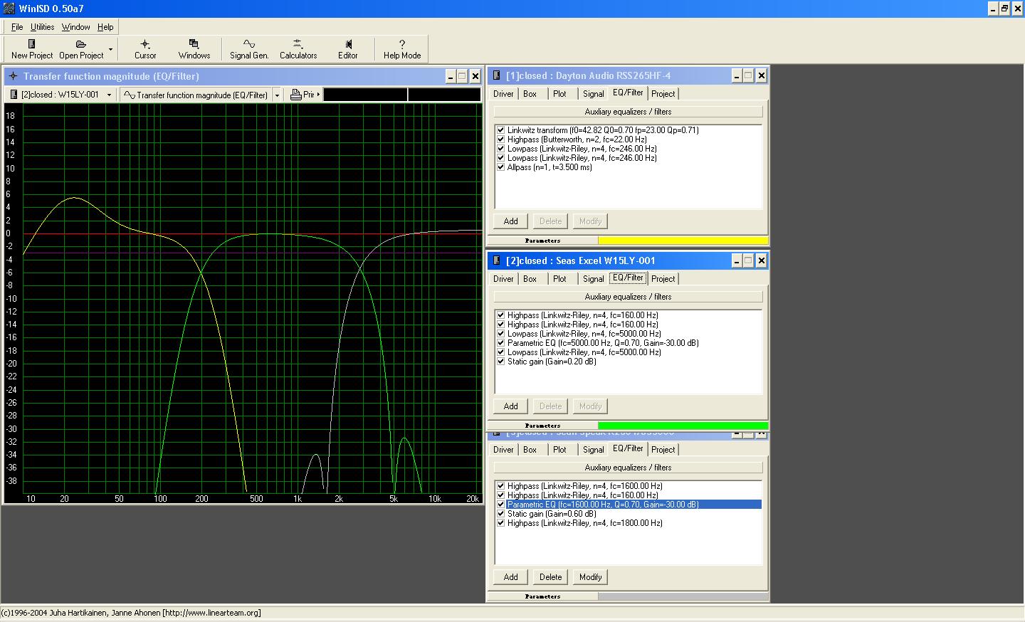

Ended up pushing the XO frequency between the mid and tweeter a little higher. It's now at 2.7KHz. The tweeter likes this a lot better, distorsion wise.
The 4 notches stayed, 1 on the woofer to compensate for the rising response and 1 one the tweeter to tame a resonance around 1200Hz. The other 2 notches on the tweeter are there to flatten the response up to 22KHz.
The XO itself is a LR8, and the baffle step compensation is 5.5dB. The (sub)woofer section is still a sim only but it looks like that when I take into account the room gain I get a frequency response that covers ~ 20Hz - 22KHz.
