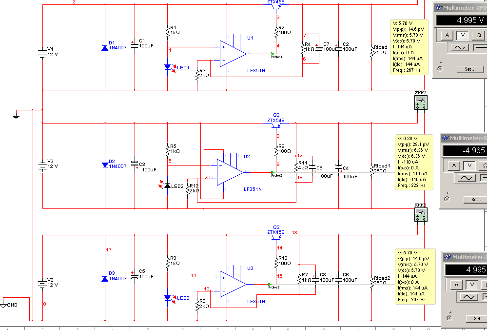

I have op-amp based voltage regulator:
Actually, I have three of them.
One for analog +5V, other for analog -5V and third for the digital +5V.
My power source are 3 SLA (12V) batteries. Each one for each VR.
If only analog +5V and -5V are connected everyhing is OK, but as soon as I connect digital and join DGND with AGND, analog +5V drops by half of the volt!
Is this a VR problem? Or gounding problem?
Any help is very appriciated...

So are you saying you have 3x that circuit shown and they are only tied together at a single ground point? There is no other circuitry past the output?

Well, the negative regulator is a little but different (diodes inverted, etc.). All the the same ground. Analog +5V and -5V are grounded already at the SLA battery. Digital +5V on the PCB (or at the battery - it does not change a thing).
Output circuit is AD1865N DAC for analog, and CS8414 receiver for digital.

SY said:Separate opamps for each of the outputs (as opposed to duals or quads)?
I am using separate LF351N for each VR. Actually, all VRs are seperated circuit (they do not share anything) - expect the GND.
Matej
Then you have a sneak path somewhere in your load circuit, probably a diode which turns on when the commons are connected. Verify this by disconnecting the loads one at a time at the "hot" end.

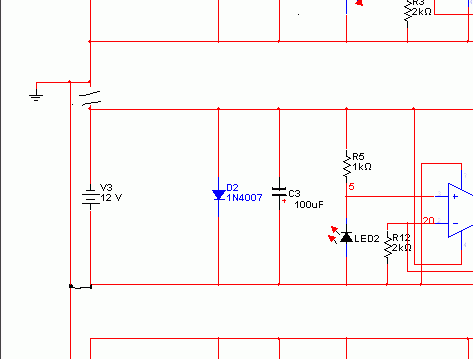

janneman said:Hmmm. That battery for -5V is grounded at it's pos terminal, right?
Jan Didden
Right. And I guess this is wrong?
Matej
That's what you want.
Do you have a scope? Sometimes when these puppies oscillate, a simple voltmeter reading shows a voltage change. It would be interesting to see what happens on the rails when the commons are joined.

Black Gates are being used.
I got the scope and I did not notice any oscillatation.
I have BG at the input and at the output. I also have a diode (reversed) to prevend wrong polarity connections. (Diodes can be tricky.)
But I noticed the following: if I connect +5V and -5V VRs everything is OK. Then I only have to connect AGND w/ DGND and this happens.
What happens is that that negative VR does not react - it's like before.
Positive VR changes... I noticed that op-amp outputs practically its max (near input voltage), and therefore opens the transistors.
Why?
I guess there is something in the orher digital VR? A diode? Caps?
Matej

Like has been said, these circuits can be unstable. You wrote neither simu nor scope did show a problem. That is strange, as I did a quick simu with quite comparable LF411 and BC547 parts and it heavily overshoots/oscillates somewhere between 10kHz and 100kHz depending on actual OpAmp bandwidth when output cap ESR falls below the 0.1R region...

I think you wired them wrong.
And you are violating the common-mode restrictions of the LF351.

I noticed my VR schema is a little bit different, but it is a standard one (a voltage divider to the op-amp input).
Can you be more precise about the common-mode restrictions you noticed... this might be it, since op-amp goes high.
Matej
juergenk said:the input voltage must have a certain distance to the rails, only inside this common mode range an opamp works, as it is intended
regards
I measured V+ and V- on op-amps and I got: 1.76V (V+) and 1.49 - 1.76V (V-).
This is all << Vin.
Matej
as a rule of thumb, input voltages should 3V from the supplys away.
With your 12V Battery, the voltage at in+/- should be between 3-9V.
There are opamps which allow input voltage close to one or both supply voltages.
regards
