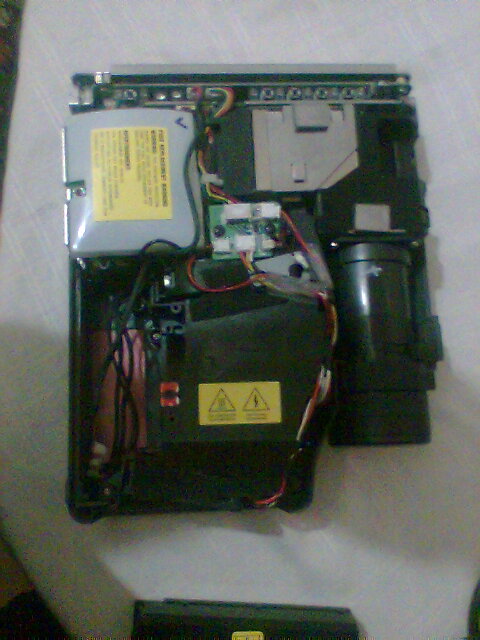

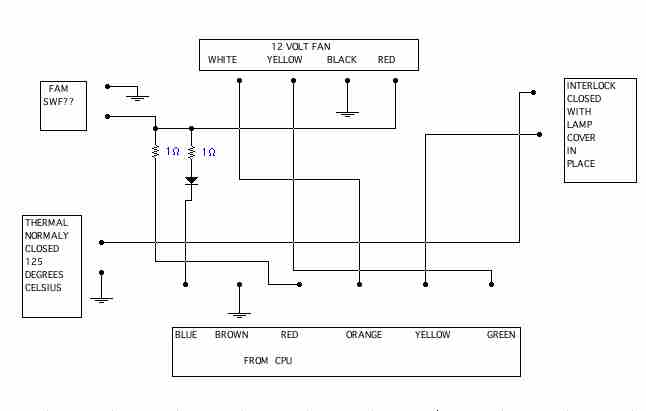

Here is the general layout of 7765PA
OOPS imaages in PDF, can't see to imbed images in post

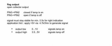

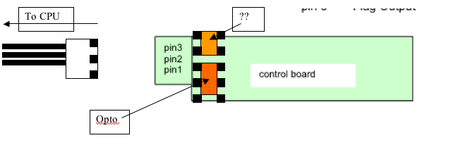

From CPU to sub board 6 wires. Seems to me only lamp door sensor & overheat sensor, no lamp sense

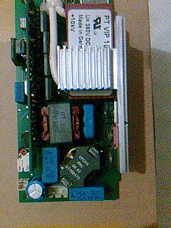

From Power supply to ballast two inputs 12 VDC & 380 VDC
From CPU to Ballast 3 wire

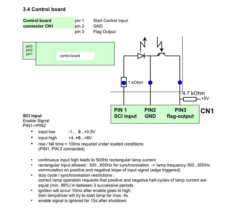

This comes from http://support.mpccorp.com/tech_support/CsmrEltrncs/Projectors/7004580/SpecVIPR150P16L_draft.pdf
Lamp is different 150/P24 but this correct ballast
Ballast at present not in projector.

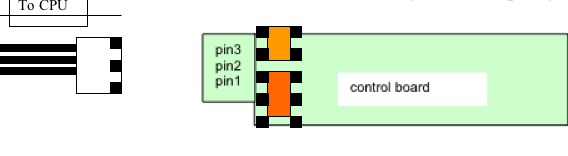

IF I short pin 3 to ground will it trick projector into thinking lamp is on??
OR do I need the ballast in for colour wheel synchronizing ??
There is another sensor to the side of the colour wheel, has 3 wires that go to CPU. Might this be a lamp on sense? Os something to do with the colour wheel? The colour wheel stepper motor is driven by its own ribbon cable.

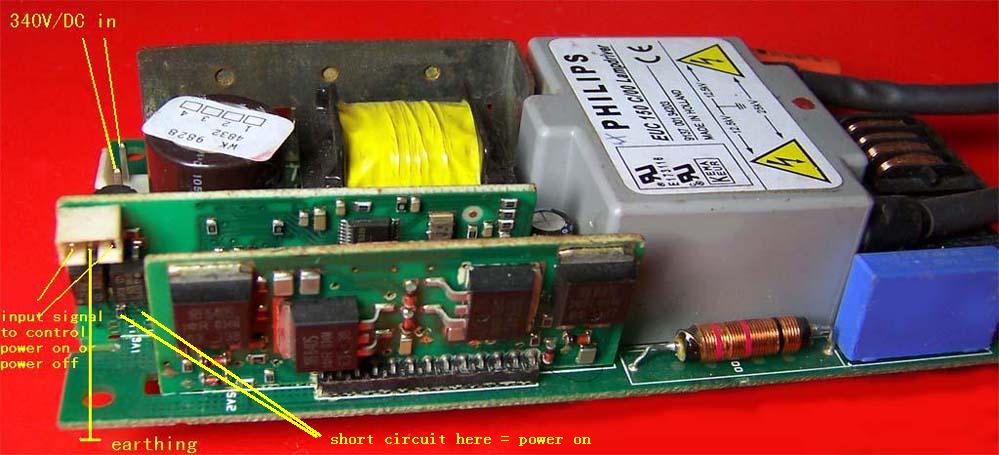

ywh said:sorry my poor english
Thanks YWH
My ballast is slightly different, not sure which points you mean to short.
Would prefer at this stage not to go near ballast with soldering iron.
Also would prefer not to have ballast in projector, if possible for initial tests.
Do you think shorting pins 2& 3 to CPU would do the same thing as your suggesting
thanks Dave
Tried shorting pins from ballast to CPU didn't work.
Did manage to find schematic for projector, too big to attach (2.9MB), anyone want to look at a copy email me & will forward it.

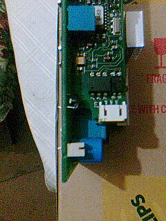

Hooked ballast back up to projector, can see it trying to ignite globe, can see component FSI on ballast img 1 from post3, actually lights up & gives 3 pulses.
Still unsure which pins to short as image from YWH looks different to my ballast
