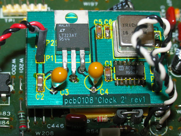

Hi there everyone, can anyone help in identifying the 2 yellow caps? on the trichord clock 2 rev 1.
as i have just purchased a faulty marantz cd 6000 with a dead laser, and when i opened it up the clock and psu where fitted in the player, upon closer inspection of the clock 1 of the yellow caps has a very small crack in the outer casing, I am wondering if anyone can help in identifying the 2 yellow caps, or if anyone knows what i could replace them with.
the clock speed is 16.934
I have already contacted Trichord direct but they say they cant help me in any way, just buy a new clock from them. NO THANKS!!!!
attached is a stock photo from the web
the writing on the yellow caps is
+R
10µ
25

They are 10uf/25 Volt tantalum. The + indicates the positive terminal. I havent looked recently but I would think RS or Farnell would stock them. Alternatives would be
