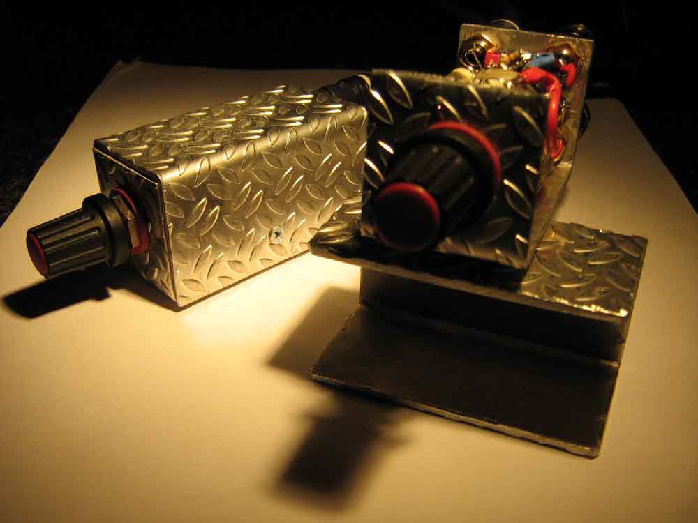

This kind:
http://www.marchandelec.com/xm46.html
Can be DIY-ed very easy, they sell a kit for 65 USD...
L😱 😱 k at the specs, and by the way mine "sound" fine...
The theory (in R-C instead of L-C-R...):
http://www.t-linespeakers.org/tech/filters/passiveHLxo.html
