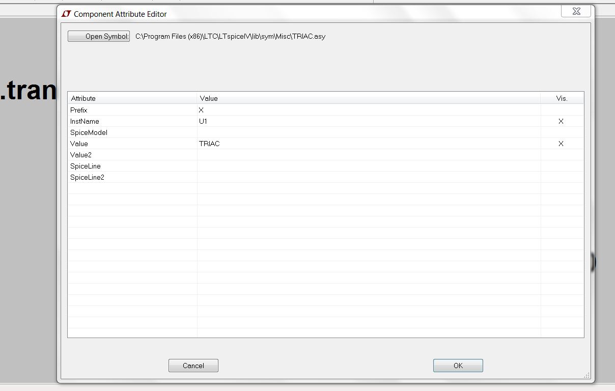

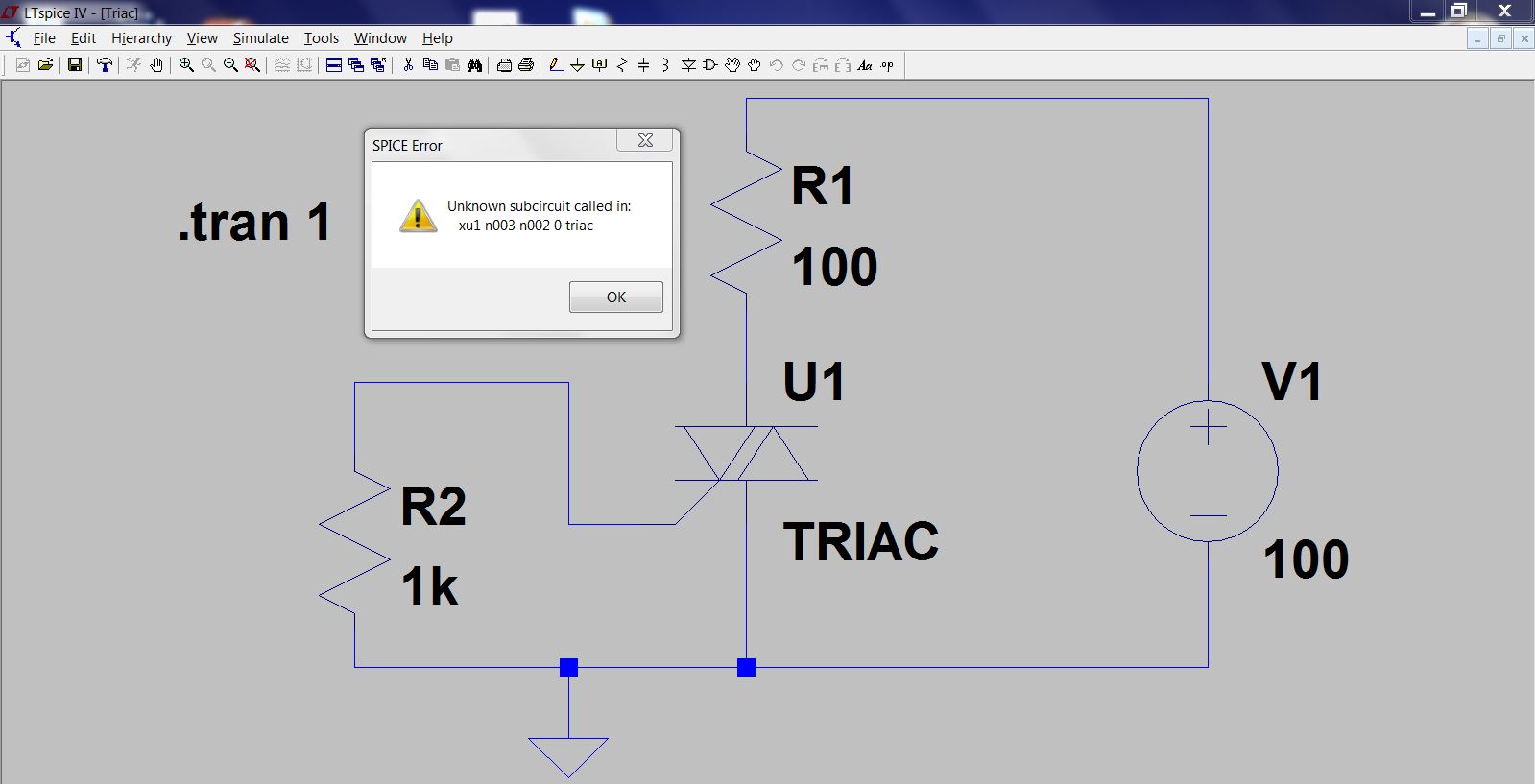

I'm trying to add a Triac to a circuit but haven't a clue how to set up a model for it. There is a symbol within spice but no working models that I can see.
A web search hasn't turned much up either.
Do any models exist anywhere ?
I'm after a "normal" 600 or 800 volt 10amp plus device.

Then just tight click on the triac symbol on the schematic then right click on the spice model line. At the right end of the line you should get a drop down arrow, click on it and pick the triac model from the tectriac.lib. For 800V 10A use Q8010L5.

Drop down arrow, what drop down arrow !
Figured it out eventually... after realising I need to select the symbol from your file and not the one in the main library. Doh 🙂

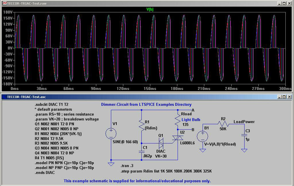

Im also trying to build a circuit to with a Triac for 230V 50Hz supply to analyse or observe the Leading edge waveform the standard Triac dimmer produces.
I'm having trouble changing the parameters on the Triac that RJM1 uploaded (big thanks for that).

Can you modify the "dimmer" example circuit that is included with LTspice ?

Hello, I know it's been a while since this thread has any update. But let me try my luck here. I donwnloaded your teccor_triac schematic. V=V(A,B)*I(Rload)...???? Is the voltage source B1 dependent of the Power dissipated on Rload? Even being so, V*I is not a Volt unit, why LTSpice accepts that as a voltage source value?
Please can you clarify this for me (I use LTspice once every few years, so I keep my self very rusted the whole time 🙂)
