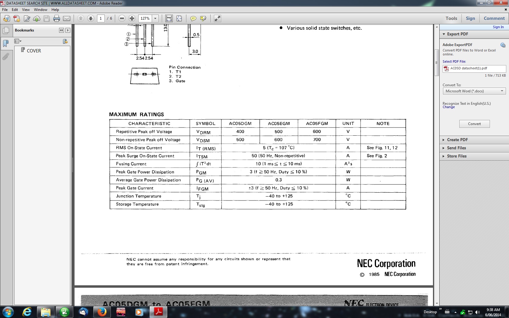

Is there a substitute for Triac NEC AC05D that I can use in my 24v GOOT 711as soldering station? The only place that has them will take a month to post otherwise.I don't have the confidence to to try another triac for fear of burning something out.If someone could work it out for me I would appreciate it.

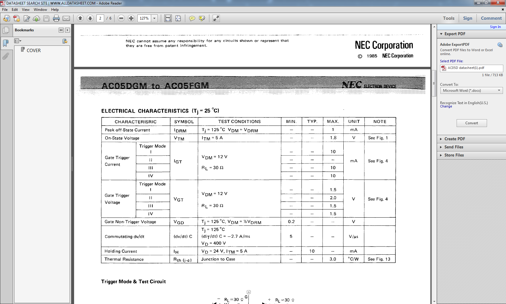

That is a low/medium gate current triac so my usual sub (BTA08-600B) will not do I guess.
In that case the NTE5609 or BT137-600D which have a 10ma Igt will do.
Both have 600v/8amp so a bit of overkill 🙂
Try RS components in Auz look for sensitive triacs or 10ma gate current.

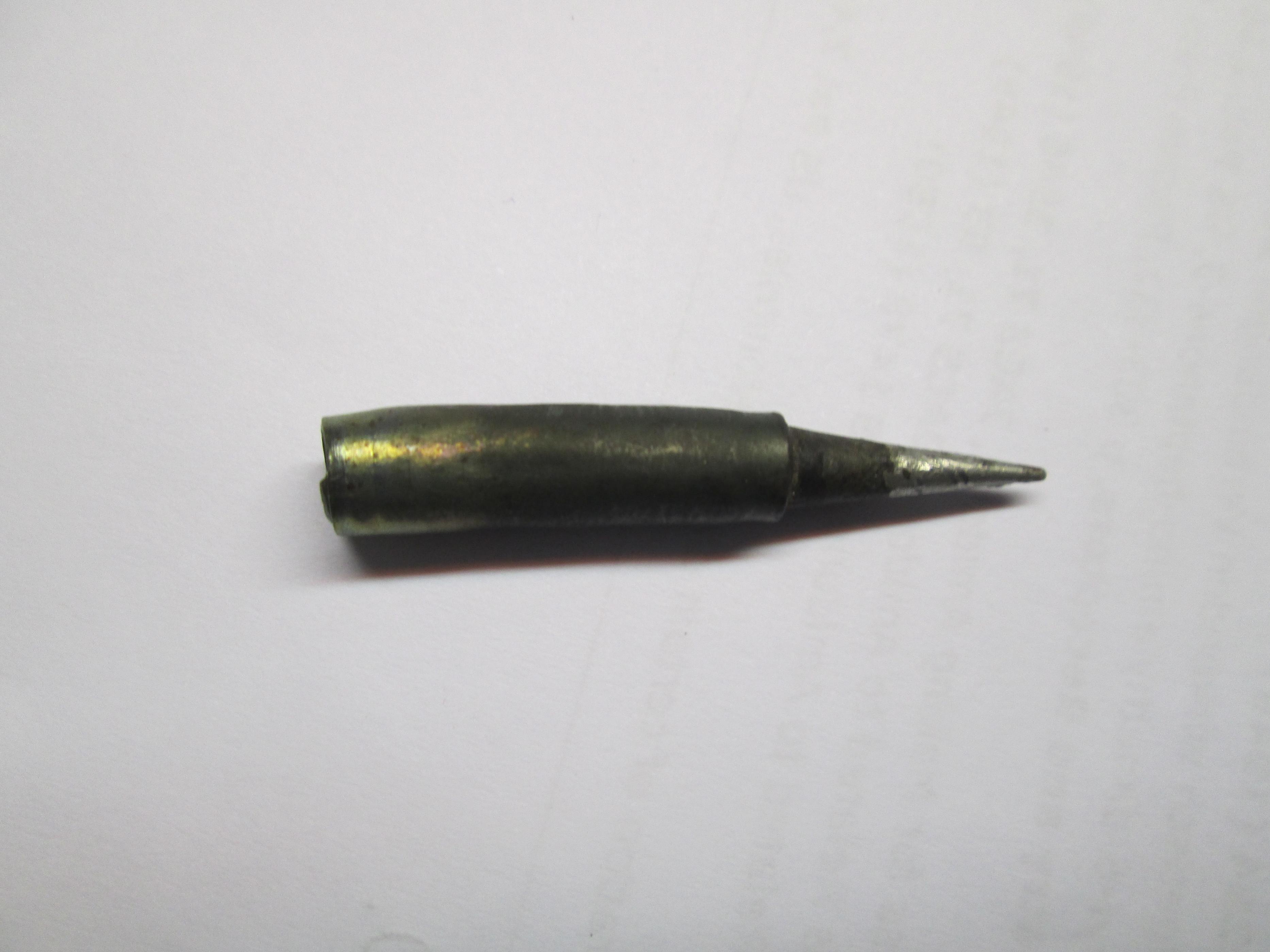

I guess the question I would ask is why it failed? Some further investigation might be required. Did the heating element short out or was it killed by a nearby lightening strike? Insufficient heat sinking? Latent defect? (Hopefully this) If you are lucky there is no collateral damage and the soldering station works properly when the triac is replaced.
Often a resistor in the snubber failing open is the root causeI guess the question I would ask is why it failed? Some further investigation might be required. Did the heating element short out or was it killed by a nearby lightening strike? Insufficient heat sinking? Latent defect? (Hopefully this) If you are lucky there is no collateral damage and the soldering station works properly when the triac is replaced.
Thanks for the help fellas. Triac failed because the tip would come loose just about every time I used it and I forgot to tighten it up once,I used the tip to bend a capacitor pin into position and it bent the tip and shorted it out.(I run it hot) Replacement heater for it cost $38 so I ordered some heaters from fleabay got a pack of 5 for $6.50 and did a DIY.Looking at the boards etc.. it probably cost less than $38 to manufacture? Heres the rest of the specs that I forgot?
alan
Ill give RS a ring monday morning,thanks mate.

Thread types could be better chosen for hot metal objects like irons. Too fine and they weld up, too coarse and they come unscrewed. I've had a few cheap products like that and whilst I resent paying high prices for very basic, traditional products from Weller, Adcola and some local manufacturers, their reliability issues had been worked out well enough over decades of product life.

I emailed RS for a sub for AC05D,the guy recommended BTA08-800CW3G ? I forgot to mention the 10ma gate. Would this triac be OK to use? Here is the datasheet link. http://docs-asia.electrocomponents.com/webdocs/10de/0900766b810de296.pdf
