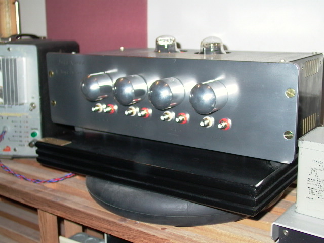

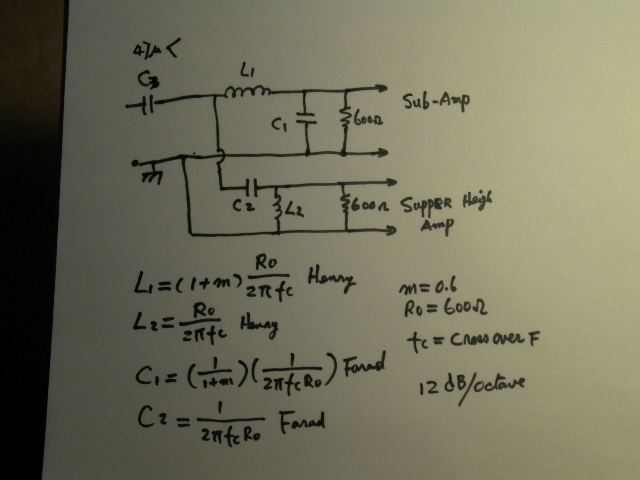

Hi Eric
My system is 4 ways 4 amps, crossover home made, add on style gain stage+ filters, I believe this is better than the active style, in here all my friends have similar system because we do compared with others. in your case what I suggest is
1) use same kind of amps not mix with tube and silicon
2) for tube amps all in same style SE or PP because they sound different
3) high power for sub-low, less power for supper high
4) sensitive adjest for each amp ( place a 600 ohm pot in the filter's load)
5) phase adjust is most critical, because music is a combine frequency, if they are not in time never can get good sound, what we can do is judge by ear, in speaker system they use time delay by net-work's components, but in multi amps phase is 0 delay, the only way to do is place each speaker unit forward or backward, take off the mid unit put it forward till you get the best sound stage, (it should stay behind the speakers in air)
6) crossover point, every room should be different if you have a adjustable frequency crossover then you can find it out, if not then you can only by guess. I suggest you take off the mid, put it into another box to run full range, if it can't cover all, replace with a good full range unit, the original one use as sub and with supper high, crossover point 80-100 HZ for the sub and 10K-12K in high will do the most job
7) in making the filter, work out the value of C and L for the frequency that you want, cap can combine with small value to target, choke - you can custom order from Electric Print audio Las vegas, it will not too expensive because no current needs
8) you can add a gain stage (mu stage or SE with transformer to match 600 ohm)front of the filter for better result
Regard Tony Ma
A nice thing about Linkwitz-Riley crossovers is that they are in phase, at the "corner" frequency. 🙂
