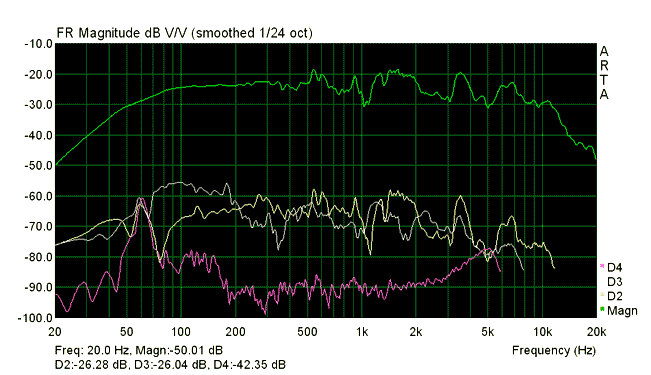

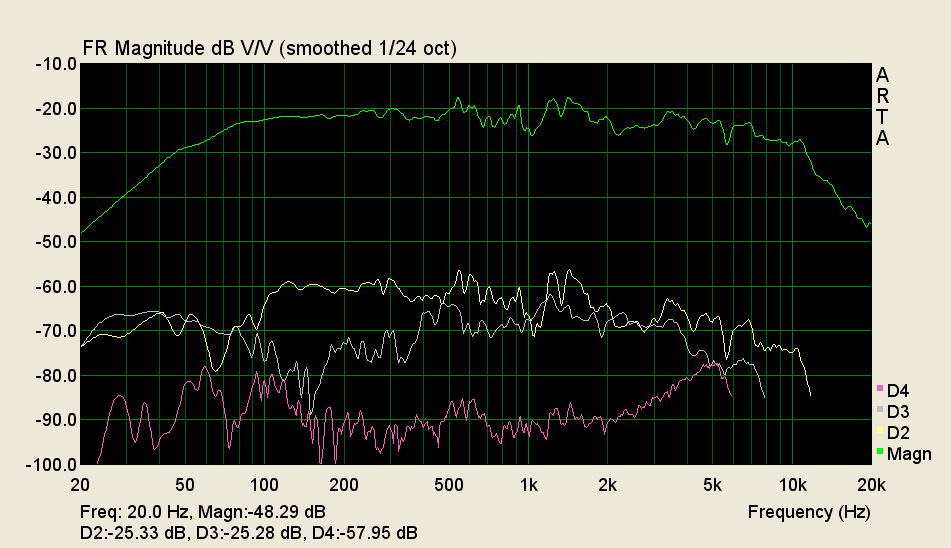

treating cones with rubber cement
this is frequency response of driver from klipsh 4.1 pro media subwoofer. I found rubber cement coating to be most effective resonance damper for paper cones. before treatment frequency response above 1k was a total mess.
both cone and surround are treated.
and copper ring added of course 🙂

Is the copper ring you added supposed to function as a shorted circuit (shorted turn) for the motor assy. If it is, shouldn't it be shimmed between the coil former and pole peice, at least within xmax? Although this will be extremly difficult to do (s/b tight clearances for a small fullranger) for a DIY.
<edit> Can you post graphs of before the mods?
