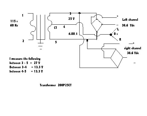

I used
the Abbott's from Steve, they give 27 before and 39 after the bridge
a bit close to the edge but they work perfectly and they are 200VA
fairly descent! I use one for BOTH channels!
J-P
J-P

Isn’t 25Vct 12.5-0-12.5? Giving you about 17.5ish after rectifying?
Abbott Tech.
200p 25ct 25VCT 8 Amp Removed from equipment Hermetic
$15.00
when using these
transformers, my guess is that I am vey very close to the highest possible level of dc IN of the chip .
I can say as well that the wattage is present with this trannie
J-P
J-P
What you have there is 38.6V Total. or a neg rail of 19.3V and a pos rail of 19.3V
Pretty low voltage for a chip amp since LM3875's max is 84V (42V per rail +/-)
Most people shoot for from 25-35Vdc +/- for their chips from what I’ve seen. That’s about 20-25VAC
