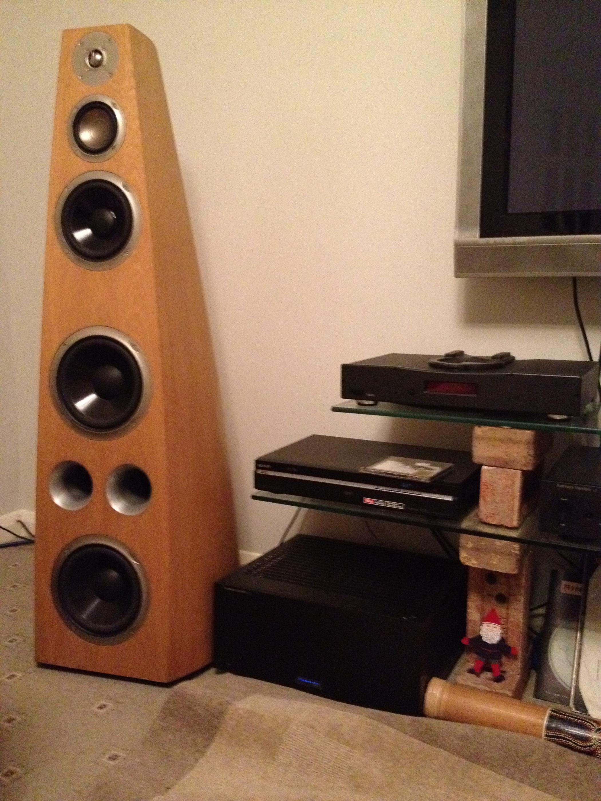

Thanks Chris, I've only listened for an hour and they've already blown me away. Do they take long to bed in? My 7.3's changed dramatically early in their life but these already sound wonderful.
They do get better with some time on them
dave
That's good to know. I'll give them an easy time for a while. They do sound great already though, thank you Dave for another great design.

Dave, do you have plans for a taller floor standing version of this enclosure and if so, are there any sonic benefits?
The reason I ask is I've just discovered a company a few miles from me that manufactures bamboo ply. They make 3 ply 18mm sheets and will make the outer plys in a few different wood species including my favourite Zebrano.
I'm now absolutely ready to explode with excitement at the the thought of a speaker box made in this material but I obviously want to make the most of the material and build the best version possible but also the most striking.
There is a Compact floorstander version of these. Same tuning,same volume. They don't need a stand, can have a bit more bass impact (due to floor/wallloading if the vent), are an easier build, but don't have as low a diffraction signature are the trapezoids so they don't have the same potential to dissapear and to throw as wide and deep a soundstage.
