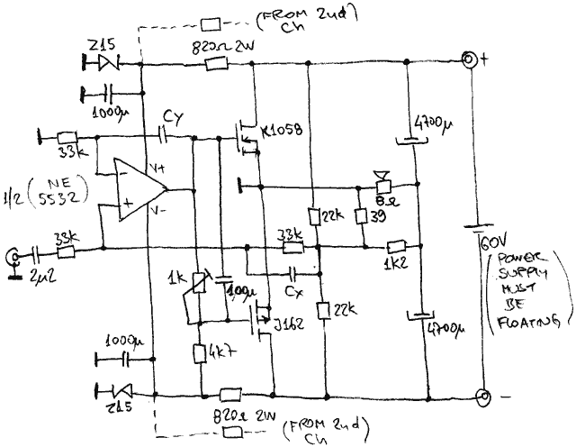

It is possible to make a very simple version of this topology using a single power supply and a pair of lateral MOSFETs, directly driven by an OP-amp capable of 300 ohm drive (like the venerable NE5534, it is even possible to use the dual NE5532 with a bit of attention to the power supply). The neat thing about lateral MOSFETs is that their source terminals are on the package tab, so they can be bolted directly to a heatsink, and the heatsink tied to ground. This is actually the power ground of the circuit, which also makes wiring easyer.
Here it is, but remember it's just a circuit idea and not tested, so some things are not shown, like gate stopper resistors for the MOSFETs, any protections, the compensation caps have no values and the power supply is shown as a battery.
In the real transnova the output and filter caps are one and the same, to be honest I'd rather have an extra smoothing cap after the rectifier (across the full power supply) and connect that to the schematic as shown via a fuse and a small value resistor in series, just to lessen the burden on the OP-amp front end.
A dual OPamp can be used for stereo if the extra output channel is connected to the power supply for theOPamp as shown in the picture. The second channel power supply of course has to be fully independent and floating.

Will that output stage run as a follower (sans op-amp) ?

You could use the same topology as above, with, say, IRF640/IRF9540, but you need to replace the simple trimmer with a Vgs multiplier, of course, you can't bolt the MOSFETs directly to the chasis because standard VMOS and HEXFETs have their drain terminal on the case. Alternatively, you need a CFP configuration. If you go this way, stability issues are simpler with BJTs as outputs.

Will that output stage run as a follower (sans op-amp)?
No, the way the concept works is that it makes the stage wotk in common source, i.e. it has gain, this is why it's sources are grounded and the power supply is floating.

I am assuming that you are asking about the low ohm divider in parallel with the load, to which the 33k feedback resistor is connected (the whole thing is global feedback). This is because you want reasonably high input impedance, in this case 33k. In order to get the required gain, a straight feedback from the output would be about 30x larger, so about 1M ohm. If you do this, you have two problems:
1) Using a bipolar input OPamp would cause a huge offset due to the input bias current making a voltage drop over the 1 meg feedback resistor. In order to get it somewhat balanced, you would need the same resistor on the - input of the OPamp, plus balance trim - or a FET input OPamp.
2) The above is quite irelevant once you consider the input and stray capacitances of the wiring around the OPamp inputs. What you get is a huge peak in the transfer curve at high frequency, because the feedback is actually attenuated at high freqecies by the RC combo made out of the 1 meg feedback resistor and the input capacitance of the OPamp.
So, on both accounts, you need a much lower impedance for the feedback network. In order to do this, you pre-divide the output by a low impedance divider, by your intended amplification factor, and then feed that into a regular higher impedance (33k in this case) 1:1 feedback network.
The extra trick here is that the low ohm divider is actually composed of 4 resistors. The two 22k resistors that come from the ends of the power supply, are there to insure that the single power supply is properly centered around the ground point. This scheme will work for many OPamps, but it has the drawback that it is sensitive to power supply ripple. An alternative is to place balancing resistors across the 4700uF caps, but still, excess offset can result because the OPamp offset is amplified by the total gain. All of this is needed because the output is actually AC coupled, so without it, there is nothing to set the DC level of the power supply with respect to GND (remember that the power supply is floating).
