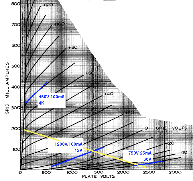

However the tube is bent all over. A dartboard study shows 4K to 30K.

> zero bias
If you idle at zero, the signal must swing positive. Positive grid sucks.
Yes, there are A2 triode amps. Mostly these are "small 2" amps, just a couple mA of grid current. This is another world.
One tube, zero bias, has infinite grid impedance for negative swings and very-low grid impedance for positive swings. "Very low" may be 2K down to 600r. Very few drivers can handle this abrupt change of load at zero crossing. In push-pull (transformer) the impedance is "always" low, both ways.
Taking the yellow loadline we need about +50V on grid, which looks like 60mA grid current. The grid impedance is going below 1K. We want a driver which will supply 60mA with like 100 Ohms source impedance. A EL84 triode might get there. Actually the 805 has more gain above zero than below, and with the low positive grid impedance, for any specific load and drive, there is a non-zero driver impedance which will minimize total distortion. THD will not stay low for other drive levels. A dynamic driver impedance could help, and a tube driver naturally has the right curve. But getting it "optimum" will be a lot of hard hot work.
There's a name for cathode follower driving heavy A2 grid. There was even a tube with both units preconnected. It attempted to compete with early power pentodes. It didn't.
Plate resistance and speaker damping-- the yellow loadline is 12K, so damping for *small* signals is about unity. However at the extremes, where you may especially need damping, it goes to 3 and 0.4. The asymmetry may encourage cone-shift on loud passages; I'm really not sure of that.

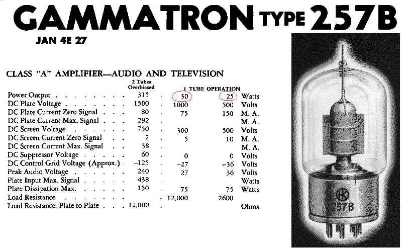

This is a "skinny" power triode. It needs BIG plate and grid voltages to pass any useful current. For single-ended use it is much easier to work with a "fat" triode, high conductance at moderate voltages. HK257 was an excellent fat triode, and there are Class A (1, not 2!) conditions on the datasheet. While HK quit business long ago, I understand that 4E27A/5-125B is nearly the same, and I have seen a 4E27A SE amp.

BTW: look on the HK257 datasheet for SE Class A conditions (omitted on the 4E27A sheet). They call it video or television for a historical reason, but it is valid for audio.
