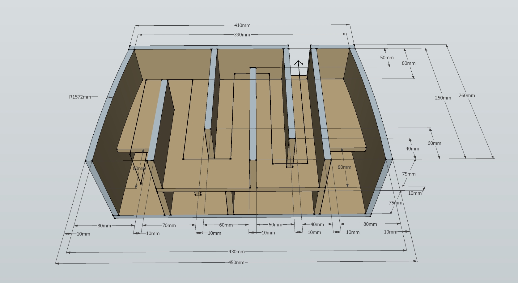

With my new updated mathcad woorksheets from Martin J king (thanks for making the service avaiable again) I came up with a 62 inch 2:1 transmissionline with the driver position 8 inch from the closed end. Working with google sketchUp simoustanely gave me a quite funny construction that I really wanted to try out. The size, 450x180x275[mm], was actually smaller than my predetermined limits.
Mathcad MJK simulation
Sketch

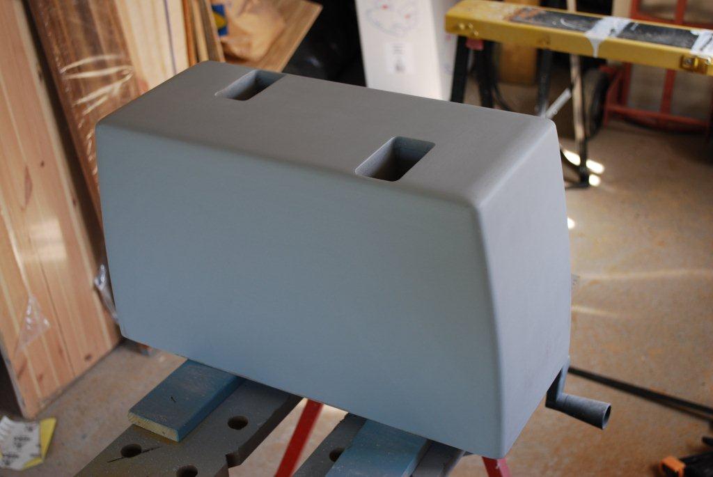

Then I built the box out of 10mm MDF, the sides was sliced halfway to allow them to bend.
The baffle is just for testing purpose, I will build a new one from some fancy wood later.
I have not yet decided the finish but I think it will be white except from wodden baffle.

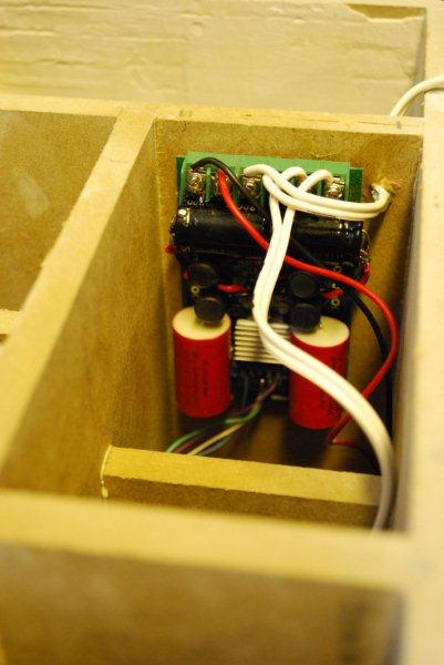

After a day of listening to it (passive driven by a gainclone) I decided to go all way with it and mount the amp inside it and try to find a proper ipod dock for it.

I noticed some lack of the higher frequencies and I think I will add some small tweeters crossed over with just a capacitor from 10000hz or so.

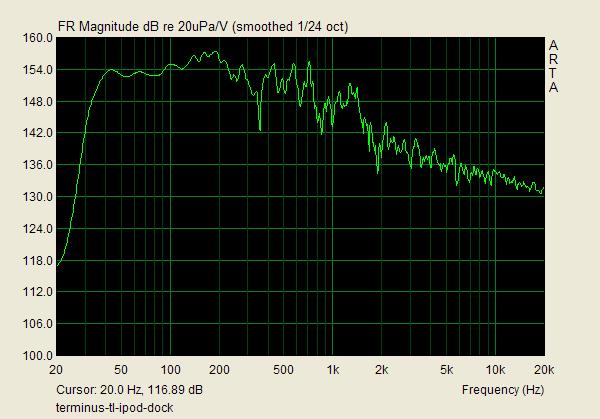

Did some diy measurements.
I will probably stuff the line a bit harder trying to get rid of some of the ripple at 100-200 hz.
Thats where I am right now.

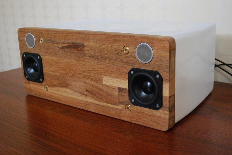

Some more work done.
No ipod dock yet though...

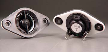

Added some cheapo ribbon tweeters ($5 on ebay) crossed over with only a capacitor. They actually sound really good! I use them to help 10000hz and over and for that they are perfect.
I wonder how low you can push a 3 inch driver?
This driver has a Fs of around 80hz and this system delivers 45hz at resonable spl.
Regards Håkan

H@jen,
That tweeter looks a lot like these ApexJr Ribbon Tweeter.
Living in the baltic, you must have easy access to baltic birch?
dave
It looks like that tweeter for sure! They are quite nice considering that they cost almost nothing. I have tried to cross them at 4khz 12dB but that was not a good idea, I think that they should be used >8-10khz
Next time you need a budget tweeter you should also have a look at these from Steve:
Speaker Stuff
I've been buying them 30-50 at a time, really useful for adding some zip on the top of a widebander. Ask Steve for the diyA special price.

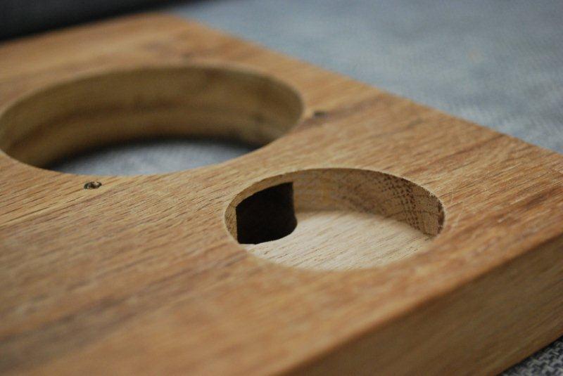

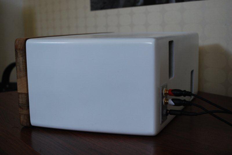

Could you share how did you do the white finish for the MDF on the back? Was the front baffle from a wooden kitchen chopping board?
Thanks!

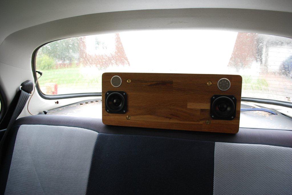

I applied spray filler in thin layers and sanding between each layer. I used one can (300ml) of spray filler. After that I used white spray paint for car rims. One can was more than enough. The result is not perfect but good enough considering the time consumed.
The baffle is made of an oak kitchen worktop.
Nowadays it lives in my SAAB 96 🙂
Regards Håkan

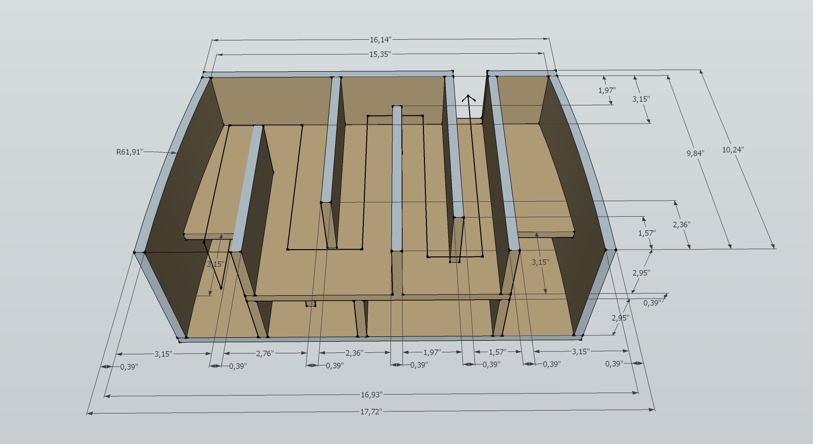

Those look seriously spiffilicious! Do you have a dimensioned drawing for them?
Images attached. The dimensions for the lower chamber (line) are the same when the speaker is flipped....that sounded a bit weird but I think you know what I mean 🙂
I hope you have that secured; wouldn't want it hitting your passenger in the back of the head!
Nice design, I would like to build a TL one day, but I'm not sure whether just using MJK's TL alignment excel spreadsheet is enough... 🙂
Anyone who has had the honor to ride in my SAAB 96 has asked me the exactly same thing, "I hope that you have secured that thing you have on the rear window shelf?" Yes its secured with two screws through the rear deck.
Thanks for your concern 🙂
Regards H@kan
