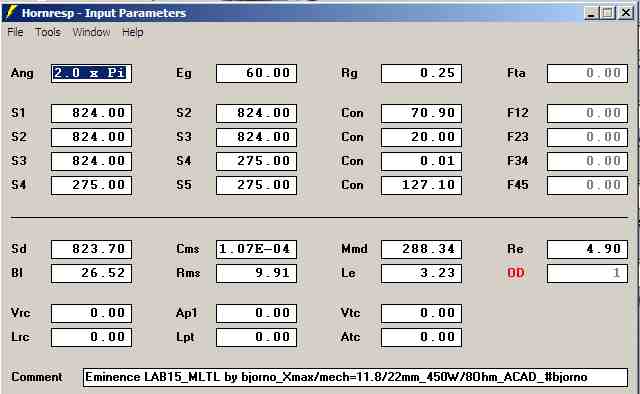

I've simulated several types of enclosures but it seems it's not possible to simulate a transmissionline enclosure.
Is that corrcect, and if it isn't, how should I proceed?
Hi oiraM,
It's indeed possible to simulate all kinds of 1/4 wave (and 1/2 wave) resonators in Hornresp. Here is one example: a mass-loaded transmission line by bjorno.

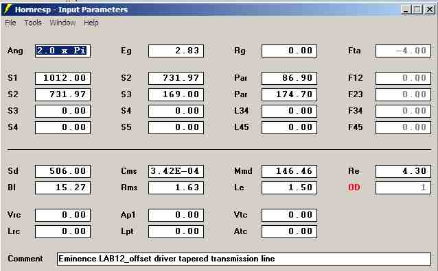

Hi again,
Had to run to work for a while.
Here is one that uses Hornresp a little differently. Basically, it's a bass-reflex enclosure using the Nd driver arrangement, and a vent a little like a JBL jet duct. You can modify it to represent a transmission line. The normal horn throat chamber becomes the back chamber, the throat adaptor turns into the first section of the line, and so on...

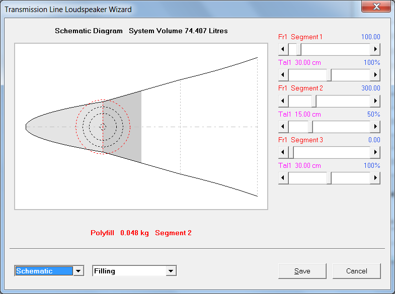

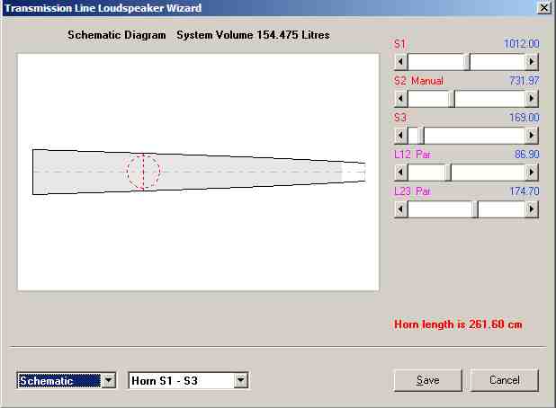

Hi oiraM,
Here is what I think David is talking about (obviously a much more logical starting point):

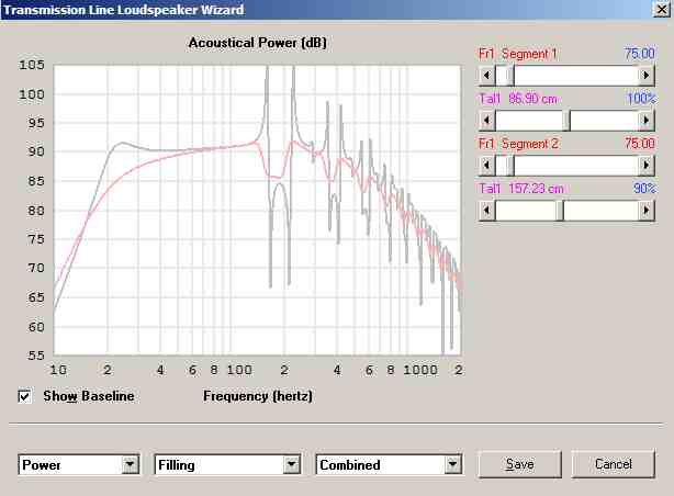

Hi oiraM,
TB46, I have a question about the filling material you specified in the Transmission Line Loudspeakers Wizard page. You entered "75" for the Fr1 in segment 1 and 2. Is that "75" number the specified value to use for poly-fill?
Is there a chart somewhere that shows you the values of different stuffing materials?
Hi Jimmy420,
Finally had a little time to try to find a few quotes on stuffing in the Hornresp thread.
just a guy did stuffing comparisons between MJK's spreadsheet and Hornresp, see: Posts #3796/3900/3905
This should get you started. There is a lot more data somewhere in the Hornresp thread.
It's also important to note, that the Transmission Line Loudspeaker Wizard also has the total Polyfill weight in kg.
When the airflow resistivity value is less than 1000 mks rayls/m and the Schematic and Filling options are selected, the total amount of Polyfill absorbent material required to achieve the specified resistivity value is shown in kilograms.
Double-click on the total value to display the amount in the currently selected segment.
