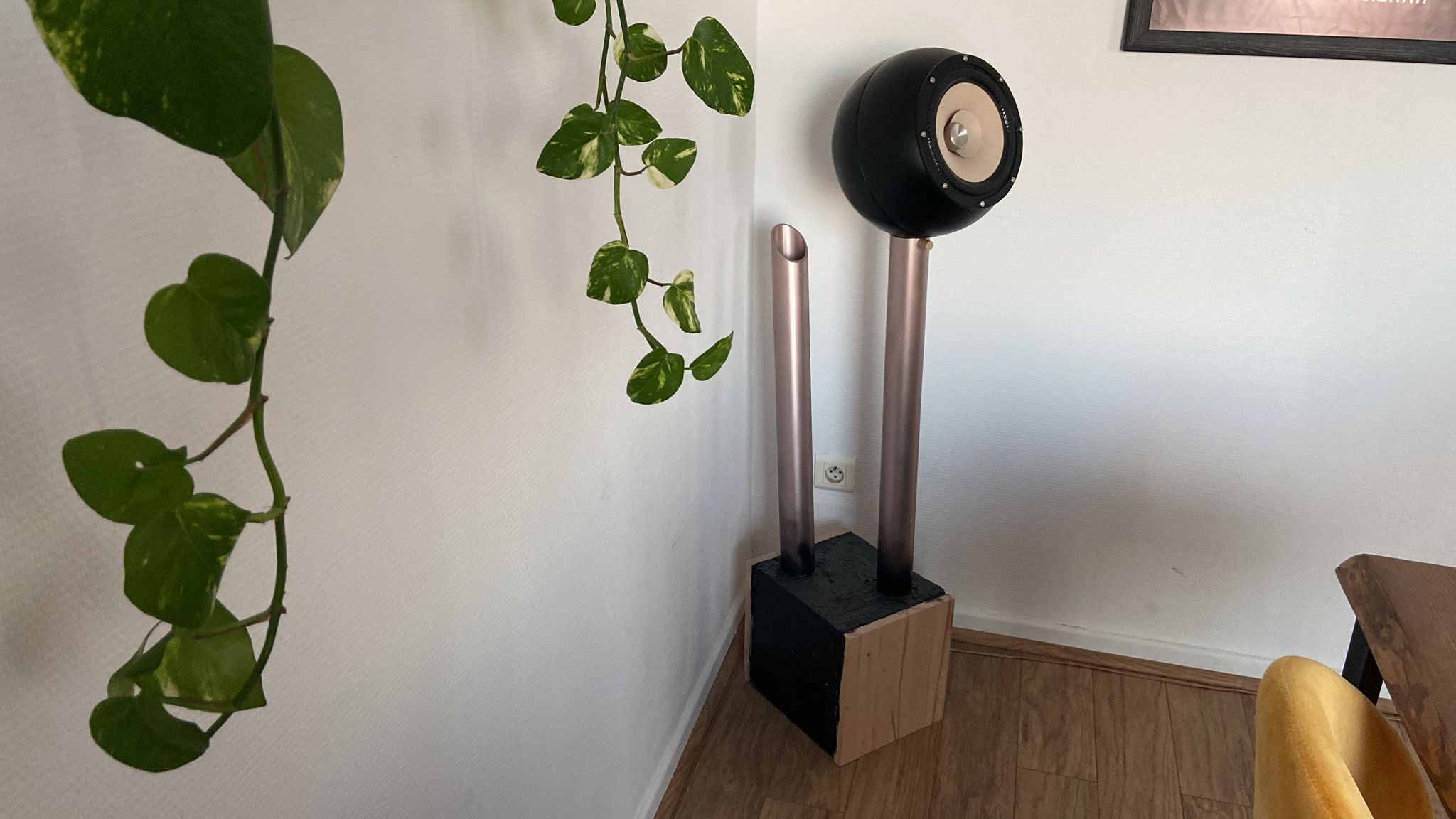

Hi everyone, I made a pair of this speakers a while ago. I always though that's a transmission line or a "quarterwave" design. But is it really ?
They are made around the Tang band W8-2145 driver, blanda bowl (the large one 28cm) and a PVC pipe (about 210cm long and 6.3cm diameter). All of this sealed in a concrete base which incorporates the connectors. Sorry, I don't have graphs and mesures, but they sound good-ish to my ears.
First I designed this speaker with the 1/4 wavelenght type of enclosure, but now I'm wondering if it is a transmission line or a very long ported design.
Thank you by advance for your reply and feedback.

As member planet10 pointed out, it is a vented box with too long bass-reflex tube - presuming that the cube at the bottom is not empty chamber with two separate tubes (in and out) attached to it. That is a wrong design.
😉......and a PVC pipe (about 210cm long and 6.3cm diameter). All of this sealed in a concrete base which incorporates the connectors.
this particular design mixing spherical and TL
It is not big enuff to be a TL. What is the volume (a bit less than 7 litre?) and length & diameter of the vent is 6.3Dx21 cm?

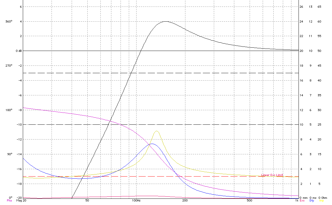

First guess on the response. Does not account for the vent resonances that will happen. And the noise.
dave
It's big/long enough to impact the driver's performance over a much wider BW than a simple 'one note' reflex vent (34400/4/21 = ~410 Hz) as your sim shows, so TL seems an appropriate moniker to me and why I used the reflex math that the local Altec Dist. designers recommended to design high aspect ratio 'column', 'tower', TLs beginning back in the late '60s.
The sphere intern volume is 9 litres, pipe diameter 6.3cm and the pipe length is 210cm. Like you said, it remains far from optimum.It is not big enuff to be a TL. What is the volume (a bit less than 7 litre?) and length & diameter of the vent is 6.3Dx21 cm?
Thank you GM, I'm not used to sim software. Usualy, I use the Dominique Petoin site to chose an enclosure type with a specific driver in mind.Sim it in Hornresp as a reflex with a very long vent
volume is 9 litres
Sim goes a bit lower, but the hump is bigger.
dave
