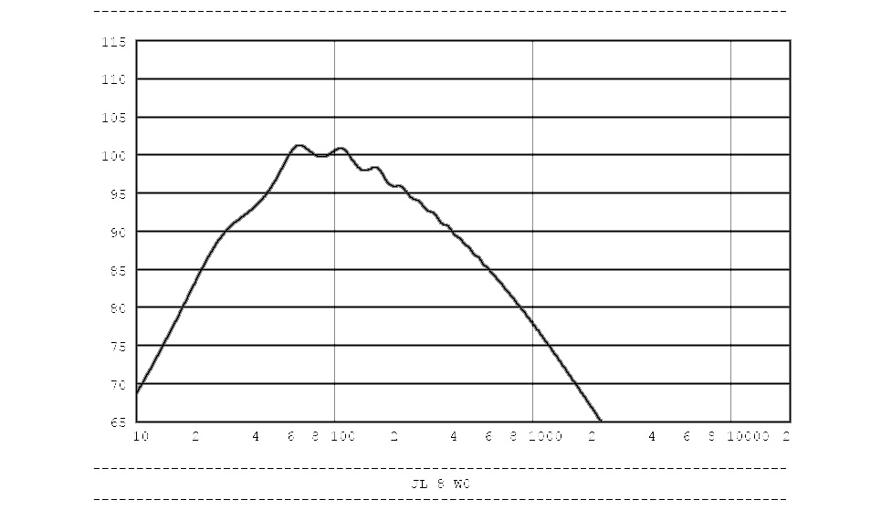

I have now done the calculations on the JL 8 W0 driver.
Conclusion: You have to build a very large horn to get good frequency response. I guess that the TL of yours is ten times smarter than building a new fridge.
Attached you'll find the frequency responce of a 2 meter horn with a mouth sized 1,2 * 0,6 meter. I got 5 dB more efficiency of a 3 meter version with a mouth sized 1,2 * 1,2 meter.
Both designs are sideloaded open air versions. Tried to calculate in a chamber but the motorsystem is way to weak on the JL driver.
If you want to build one of them, I can give you enough info to make it and maybe a drawing.

Hi, I ran a calculation of the TL box and it is quite similar to the horn from 40 to 70 Hz, but it seems like there would be a dip with center frequency at 100 Hz and a really loud top with center frequency at ca 150 Hz.
In the calculation program I had to make the TL a straight line, so it is possible that the problems are much smaller with the bends.
You can try to find this out with sinus tones and your ears.
If 100 Hz has significantly decreased volume and 150 Hz the opposite, you should consider to set your crossover lower than 90Hz.
