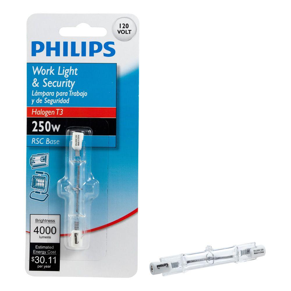

...er.. regular bulbs only go up to 100W...
If I go to a *serious* lamp supplier, I can still easily get 250 Watt incandescents. They are useful in boathouses and such, where large light is needed for short hours (efficiency not as important as lamp cost).
That's in Edison screw sockets (in the US, above 250W we must use the larger Mogul socket, and that is getting scarce).
But "tubular halogen" is again an incandescent lamp, the T3 size available in 250 Watts and 500 Watts. You need a proper fixture but they have always been cheap. (Can be free today: I have thrown-out several for LED replacements.)
And very few transistor amps suck large power when idle, or playing very soft. A "200W+200W" amp may idle under 50 Watts. And the cold filament resistance is low, so very little voltage is dropped in the lamp *unless* the amplifier sucks BIG current.
