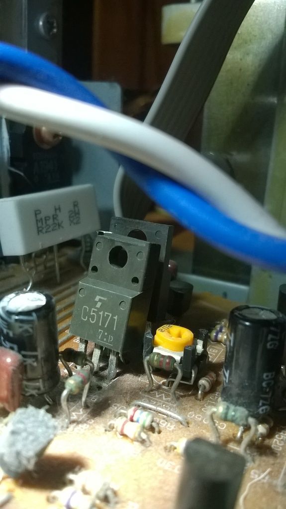

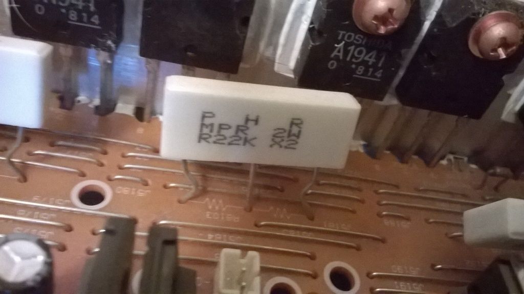

I'm in need of the following transistors and resistors, all for the centre speaker output channel of my ONKYO TX-SR506:
Transistors: 2SC5198, 2SA1941, 2SC5171 and 2SA1930
Emitter resistor: PHR MPR 2W R22K x2
I'm having a lot of trouble trying to source them, Farnell and RS Components are drawing blanks. I can find the transistors on the above companies but they are showing as obsolete, but I can't get a result searching for the resistor. Are there any alternative numbers and letters other than "PHR MPR 2W R22K x2" I should be using for searching?
And as for the transistors is there a replacement/updated part number?
Some photos of them:
Thanks in advance for any help,
fred

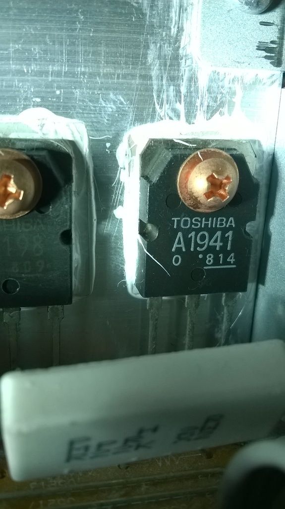

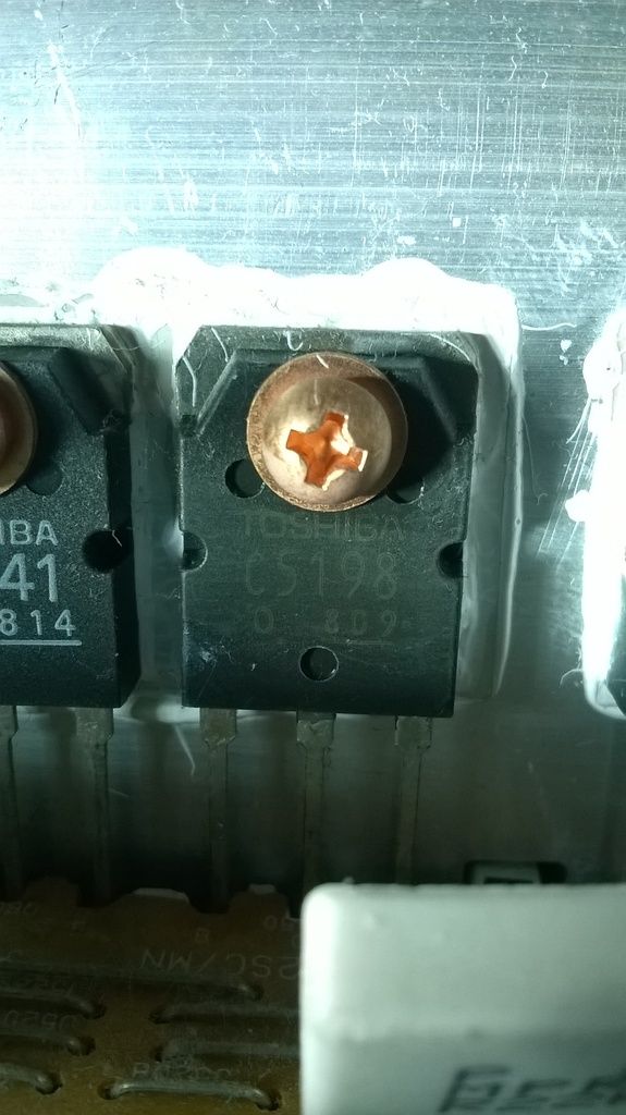

The exact resistor would probably have to come from Onkyo although most repair techs would simply fit a pair of standard 0.22 ohm, 3 watt rated resistors.
Same for the transistors, although with luck you should be able to find standard replacements such as MJ21193/MJ21194 for the outputs. Check the data sheets for the originals first to see what you are dealing with.
All the 2SA/B/C/D numbers are Japanese parts and you may well draw a blank in finding reputable suppliers. (Don't buy semiconductors from ebay, to many fake devices around)
I would not special order dual resisotrs like that unless I was already getting other things from that supplier. I agree, and a pair of 0.22 ohm resistors in 3-5 watt size would take its place quite well.
The R in R22 is to mean a decimal point. So R47 means 0.47 ohms. Likewise 4k7 means 4.7k. and 1M2 means 1.2 meg.
SO you are searching for dual 0.22 ohm dual resistors. Or just use discretes.
Hi fred,
for the emitter resistors check for Fukushima Futaba Electric 2x 0,22 Ohm
MPC708 (2W) or MPC725 (5W).
I think , thats exaxtly what you need.
BR
Günther
BR
Günther

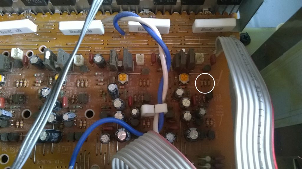

When you say "Make sure you order new resistors for the circuit. They will be flameproof ones.", do you mean all of the type of resistors I've highlighted with a circle in the picture below? 😕
Flameproof and safety related parts are normal marked on the circuit diagram with a warning triangle. Those look like standard 0.25w carbon or 0.1 watt metal glaze that often adorn this type of equipment. The large white resistors will officially be a flameproof/safety item.
Mooly is correct, but normally they are all flameproof in the amplifier circuit. There is also a small transistor on the heat sink you will want to replace also. You can see it between the driver compliments.
