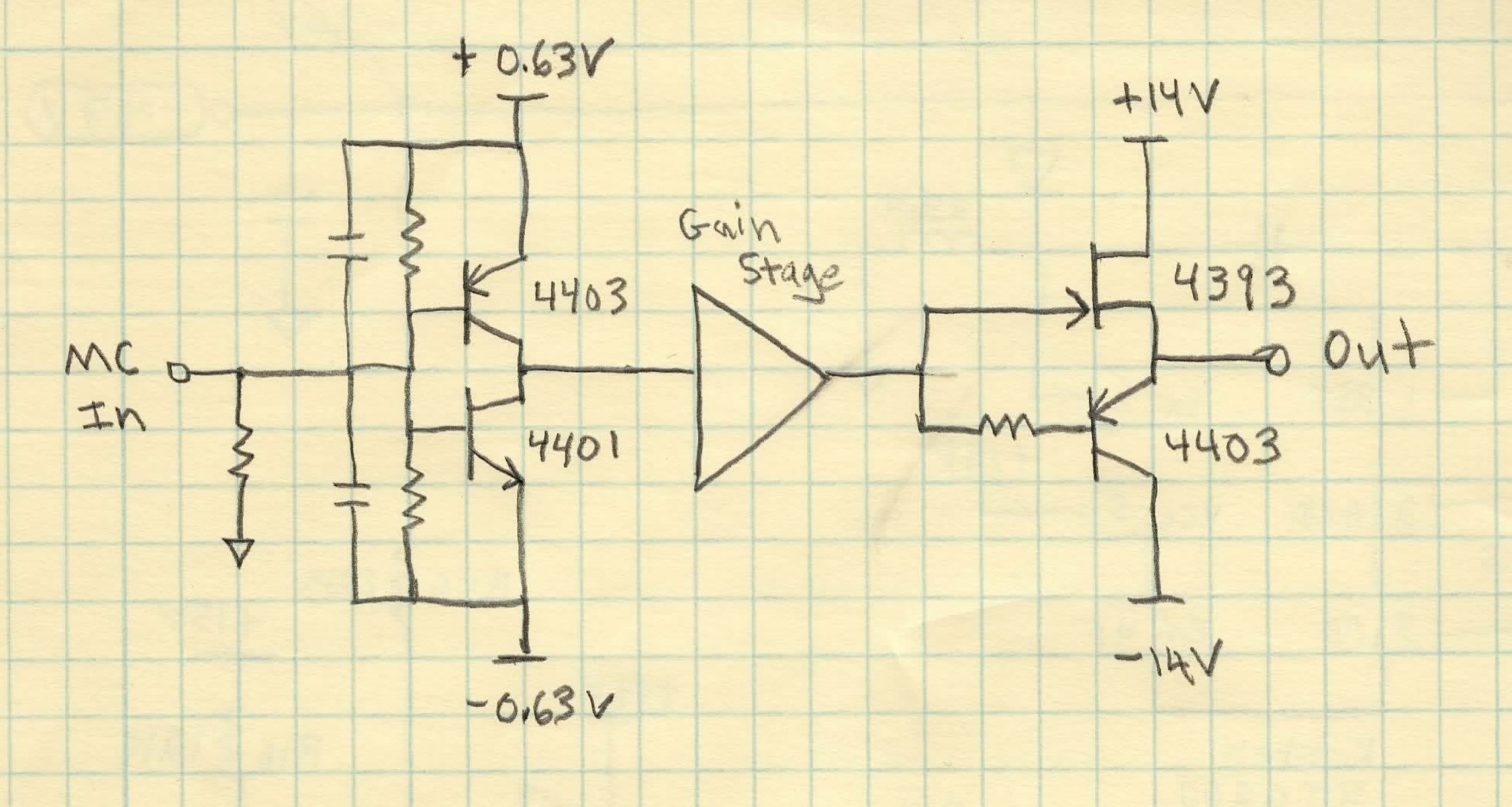

The diagram shows the rather unorthodox input and output stages of the MC section of the iPhono2 phono preamp. Since all transistors are general purpose types, I was wondering if better parts could be substituted -especially in the input buffer for lower noise. All parts are SOT-23 surface mount.
Maybe this thread could be of some use:
ultra-low noise transistors.
I guess the +0.63 V and -0.63 V are generated with a model circuit that uses the same types of transistors as are used in the input stage. Don't forget to change those as well.

4401 and 4403 are actually pretty quiet, although not the quietest. My battery powered MC stage uses the same, although the topology is different from yours. With the MC stage on I cannot hear any increase in the noise floor.

Regarding Jon's suggestion to put transistors in parallel: paralleling n transistors (at least for AC) essentially reduces the base resistance by a factor of n. For circuits that have to work with very low source impedances, like MC amplifiers, base resistance is usually one of the main noise sources, so paralleling transistors can help a lot.
