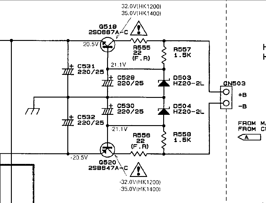

The 2SD667/2SB647 are used in supply voltage regulator circuits in the Harman-Kardon HK1400 (and possibly HK1200 HiFi Amplifiers, where they are used to provide stabilised +20.5 &-20.5 v. rails for the preamplifier circuits. A quite conventional Transistor assisted zener circuit is used for this purpose, which is supplied with + & -40v from bridge rectifier D20. I need to source a 2SD667 (& possibly 2SB647) or eqivalents for this circuit, and would guess that transistors rated at 30-40v(Vce) and ca 0.5A Max would be more than adequate. If they were in TO-92MOD packages fitting them would be easier, though an alternative package type could be used. Does anyone have any suggestions as to either a source from which to buy the original types, or suitable alternative types. I have a load of transistors of various types, mainly European BCxxx devices, so maybe I can find suitable ones in my parts 'stock'. Is it advisable to replace both transistors with a closely matched pair? The 2SB647 checks out OK, but the 2SD667 is seriously leaky between all 3 terminals, though I've no idea what caused it to fail.

I did think of using something like TIP31/32, Mooly, although the originals are TO-92MOD rather than TIP case style. Earlier today I fitted a MPSA42 to replace the failed 2SD667, with a temporary 33 ohm resistor in series with the collector, pending getting some 22ohm fusible types. I was getting 36v at the collector of the replacement transistor, but 0v at both the base and emitter. The associated zener diode checks out OK, but I haven't yet checked other peripheral components.

It would help to see the circuit but having zero volts on the base suggests a basic problem somewhere. 36V on the collector suggests no current is being drawn from the supply. So where has the base voltage gone ?
The circuits of both the positive and negative voltage regulators are standard series pass transistor assisted zener types, Mooly. I have the diagrams, which came from HiFi Engine, so I'm not sure that I should scan them & post them on here.
Just do a clear image of the relevant part of the circuit (use Windows sniping tool or equivalent 🙂) and post that. No need to scan anything.
I haven't carried out any further checks since my previous post, Mooly, but if R557 were o/c or high resistance, or C528 was leaky, this could cause the fault. I visually ckecked that I'd wired in the MPSA42 correctly earlier this afternoon, since it's pinouts differ from those of the 2SD667, but no wiring error there. I have in the meantime ordered a pair of the original type transistors from eBay, so may fit the new '667 when I receive it, and after checking for other faults
R557 if open would give your symptom as would the cap being short or very leaky (unlikely to be the cap).
Is the -20 volt rail OK ?
If you remove the transistor you should have 20 volts across the zener. The negative rail supply is a mirror image of the positive although the two are totally separate in operation with no interaction between the two possible.

The -20v rail is OK as of when I was last working on the amplifier. It may well be Monday or Tuesday before I can get back to it, when I will check R557 and the printed circiut tracks to which it connects.

This afternoon, I checked the components around Q519 only to find that the zener diode D503 was s/c. I don't have a 22v zener to hand, so the job is once more put on hold whilst I source bothe the diode and a 22 ohm fusible resistor. Who would have thought that such a simple circuit could cause so many problems??
