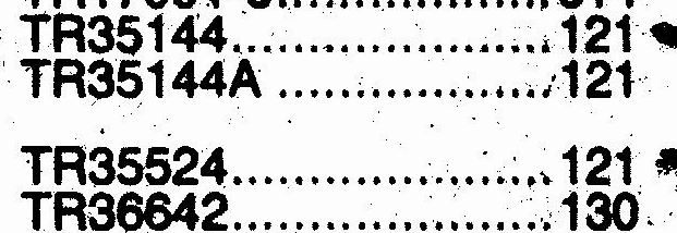

I'm working on fixing this same model, and likewise have not been able to find any information on it. In one channel, all four output transistors are blown, and I would like to find replacements.
In tracing the circuitry and testing the remaining good parts in the other channel, I find that all four transistors are PNP and appear to be germanium.
If I use the NTE cross reference, type 35524 gets cross referenced to NTE181, which is a silicon NPN power transistor, whch doesn't seem correct. Type 35144 cross references to NTE121, which is a germanium power transistor, so it may be correct.
Does anyone know what these transistors should be? Does anyone know of a source for a schematic or parts list for this unit? As mentioned above, I wonder if this was in production for only a very short time. I see virtually no information anywhere on this model R-590 (amp chassis 59A).

Thank you very much for the help. The incorrect cross reference is the online one at the NTE website: NTE online cross reference .
If you enter 35524 there, you get NTE181. That is probably what jaymanaa was using as well. I suspect it's giving incorrect information for this particular part number.
I should be able to track down either some NTE121s or one of the alternatives you've listed.
Do not trust that site. I've found errors on many occasions. My ECG book appears to be more accurate, not that I'm using it frequently.

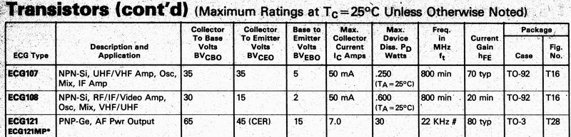

according to Net's posted datasheet, the nte121 is 45Vce0.
This is far too low for a supply of +-35Vdc.

This is why, Andrew:
