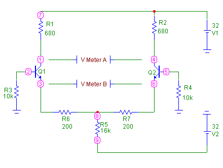

Peranders really got me thinking. So I came up with the following circuit.
It is not "exactly" like the circuit the transistors will be used in because Q2 in the operating circuit will not have a collector resistor and the match would be impossible. So I placed a 680R in the collector of Q2. It gives a place to take a measurement from and also balances the system. The simulator gives it a go!
R1,2,3,4,6 & 7 should be at least 1% types.
Notice the two meters.
Both meters will see 0V with a perfect match (unlikely of course). But Meter A between nodes 1 and 4 will be comparing points at about 31V and Meter B between nodes 3 and 6 will be comparing points at about .7V. Any comments as to which will result in better accuracy re the match?
Also the 16k can be varied to see if the transistors go off in different directions with different currents.
I do not know how close a match this circuit will show, but it should be better than nothing. 😀

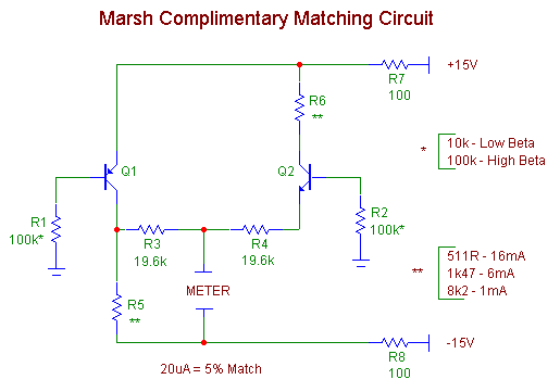

In regards to complimentary matching, I rustled around and found this circuit presented by Richard N. Marsh in AA during the 80's.
I think all the resistors in this circuit should be 1% or better for proper matching.

This was what I ment but I think it's sufficient with only measuring the collector voltage. This is a good approximation because you can't match every parameter.

I was not suggesting multiple tests. I was asking which point of measurement (A or B NOT A and B) would result in a more discriminating and accurate matching process.

aborza said:A: I was not suggesting multiple tests. I was asking which point of measurement (A or B NOT A and B) would result in a more discriminating and accurate matching process.

A: You are always interested in the collector currents, you shuold measure therefore the currents (or voltages over the collector resitors)

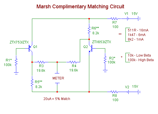

Correction
Sorry,
The prior schematic for the complimentary match circuit was wrong.
Here is the corrected schematic. But I am not sure this circuit will work properly either.
Note that the meter is suggested to read uA and is not in series. It would seem the measure should be in V's not A's. Also I put the circuit into simulation and it did not seem to work out sensibly.
Can someone check this out?

At what potential shall the emitters be? I think something is wrong, either the 100 ohms resistor or the whole circuit.
Is your purpose to get a NPN/PNP pair? Can't you show the circuit they will be in?

Did you check the comp match circuit to see if will work?
