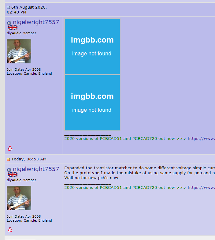

Expanded the transistor matcher to do some different voltage simple curves too.
On the prototype I made the mistake of using same supply for pnp and npn, this caused spikes in pnp readings. So split the supply through two separate transistors and it works a treat now.

The pictures got deleted when I had a clear out.
Here it is again.
This one is the prototype, waiting for new pcb's to come in from China.

First picture is transistor matcher.
Second picture is curve tracer with traces of 4 different voltages.
