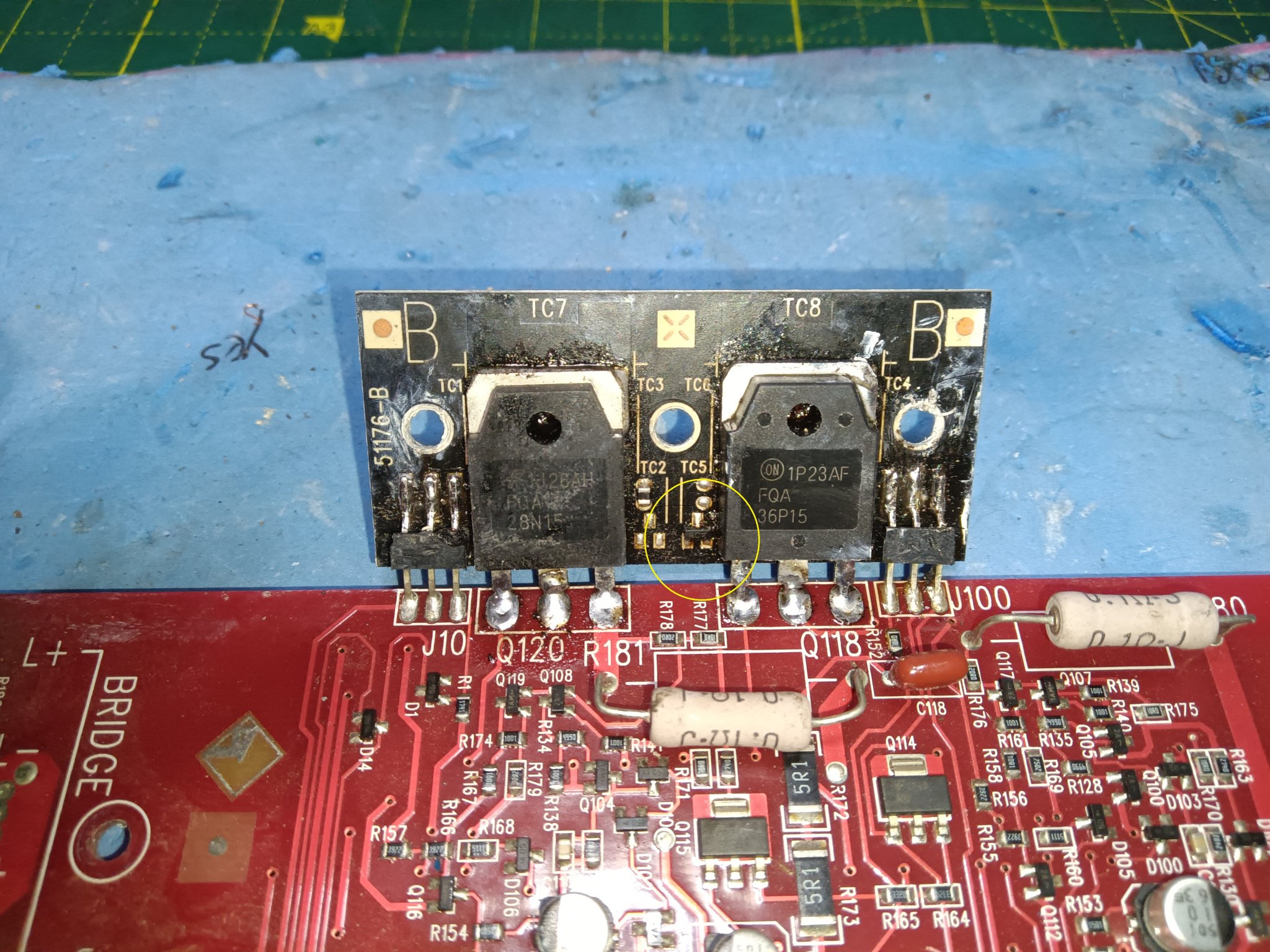

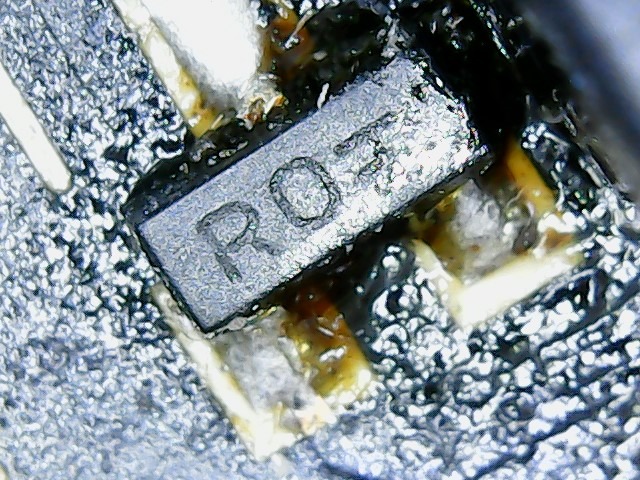

jfxwave Member Joined 2016 2023-08-01 3:46 pm #1 2023-08-01 3:46 pm #1 I think it might be https://www.digikey.com/en/products/detail/microchip-technology/mcp101t-475i-tt/319345 but i'm getting lots of hits with different transistors. Attachments IMG_20230801_094052.jpg 553.6 KB · Views: 84 WIN_20230801_09_10_34_Pro.jpg 130.1 KB · Views: 80 P Perry Babin Member Joined 2003 bcae1.com 2023-08-01 4:01 pm #2 2023-08-01 4:01 pm #2 See attached. Attachments rockford - punchP2002SCH1405-51627-B.pdf rockford - punchP2002SCH1405-51627-B.pdf 680.6 KB · Views: 94 MMBT6521LT1-D.pdf MMBT6521LT1-D.pdf 109.7 KB · Views: 86 jfxwave Member Joined 2016 2023-08-01 5:27 pm #3 2023-08-01 5:27 pm #3 Thanks again Perry. You must log in or register to reply here. Share: Facebook X (Twitter) LinkedIn Reddit Pinterest Tumblr WhatsApp Email Link
