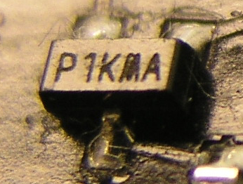

Hi. I'm trying to identify this surface mount transistor that is part of a piezo buffer circuit. The markings on it are P1KMA. If I search using the first three, P1K, I find the transistor PMBT6428. If I search using the next three, 1KM, I find the transistor PMBT6428L. It looked like this was the transistor but when I looked at the pinout it was incompatible with the way the circuit is wired. The transistor has a single pin on one side and two on the other. The single pin connects to the piezo and needs to be a high impedance connection.
I am comparing two piezo buffer circuits, a old and a new. On the new, the transistor is a Jfet which makes sense because the piezo needs to see a very high impedance. The pinout for this Jfet works with the circuit correctly with the single pin as the gate. The PMBT6428 is a BJT that the pinout would put the single pin as the collector and would put the base to +V. This does not seem right.
If anyone can help it would be appreciated. Attached it a picture of the transistor.

It's a piezo system by L.R.Baggs that is used in some PRS Guitars. The surface mount componantes are the piezo buffer circuit that is on a pcb mounted under the bridge.
With SMD-codes you need to differentiate between lower and upper case. Inconveniently, different manufacturers use the same code for different products.
The last letter(s) usually refer to country of origin.
From: SMD marking codes P
p1K = Philips (NXP) PMBT6428
P1 on a SOT23 Philips transistor = BFR92 (also a BJT)
the Philips datasheet mentions only marking P1p (sometimes there are more possibilities if a component is manufactured in more than one country).
but
P1 on a SOT23 Temic-Atmel transistor = SST201 a n-channel jfet
In the context of this thread I would guess that's the one. MA on your transistor might mean Malaysia.
P1K doesn't appear in the SMD codebooks.
