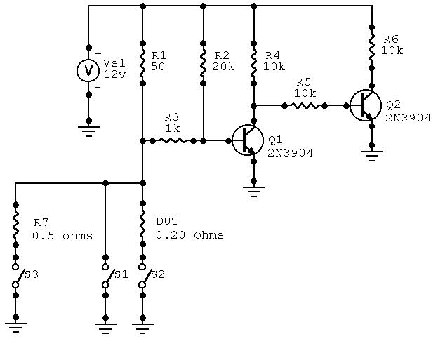

I need a circuit that can differentiate between a
0.2 ohm resistor going to ground and a short across
the same resistor to ground. Also, if the load is > 0.2 ohm, it will not trigger.
Perhaps, there is a different method of doing this I can't see ?

Here's an untested circuit.
You set the max detection level using R1
for whatever load resistance you want to
test. I don't need precision, I need a simple pass/fail
checker.
Adjust R1 to trigger if load = less than .2 ohms,
but not trigger if it's greater than .2 ohms.
Output = collector of Q2 = ground when triggered.
I have not idea if this works in reality - hehe
Plus, R1 would consume alot of heat.

Tried the circuit, seems to work
but it has loose toleranaces plus
when testing for short, there is
unacceptable levels of dc at
the speaker, probably 1v worse
case @ 8 ohms.
I tried the LM339 version of
the circuit, seems to work better,
better precision and 10x less
dc offset. The comparator is the
winner so far.
The last problem to solve is
how to check for bridged
amplifier external short across
both output leads ? The circuit
only checks output to ground, but not
across another amplifier's output.
(amp modules are seperate PCB's)
