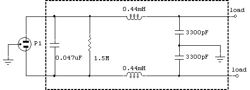

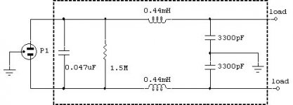

Thanks, dlharmon. I'm using an EMI filter, which is shown below, with my amplifier. Still, I have the annoying POP sounds. Is the EMI filter different from the RF filters? And, isn't spike voltafe different from RF interference and EMI? I'm beginning to feel shame at my ignorance. 😱
This filter won't take large spikes, only RF and small spikes. You must add varistors also. Size K10 and up. If you have 230 VAC in choose 250 V varistor K10-K14 at least.
Example here
http://www.elfa.se/elfa/produkter/se/20/2012568.htm
P1 is not suitable for "normal" protection. Each time this tube disharges, lifetime is shortened. Neon tubes is good for lightning protection. The tube may also break the fuses if it's triggered, not so pratical....
