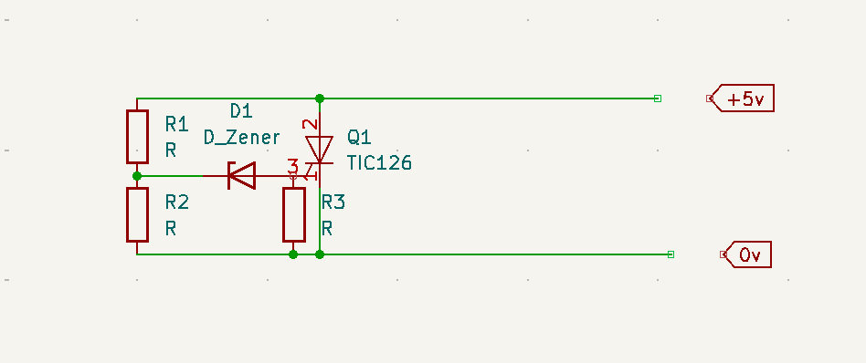

Use a "crowbar" on the 5v output.
A simple voltage spike detection circuit will trigger the thyristor, almost instantly, if the 5volt output rises above your preset voltage.
Just a 4v3 zener between the +ve output and the gate of the thyristor will cause the thyristor to conduct, like a "crowbar" and not release until the supply voltage is removed.
D1 4v3
R1 1k
R2 2k2
R3 10k
Q1 Tic126 or anything to suit
Very simple and 100% effective.

P.S.: the approach in post #2 with a TRIAC is for me the most interesting and convincing.

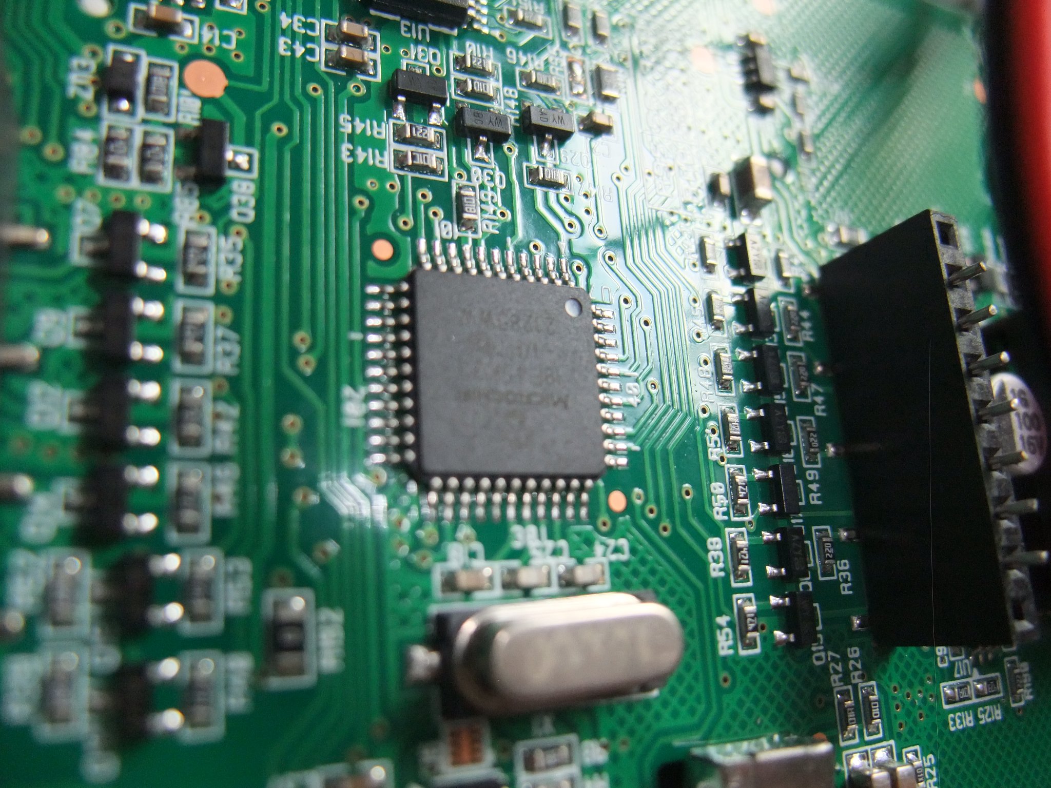

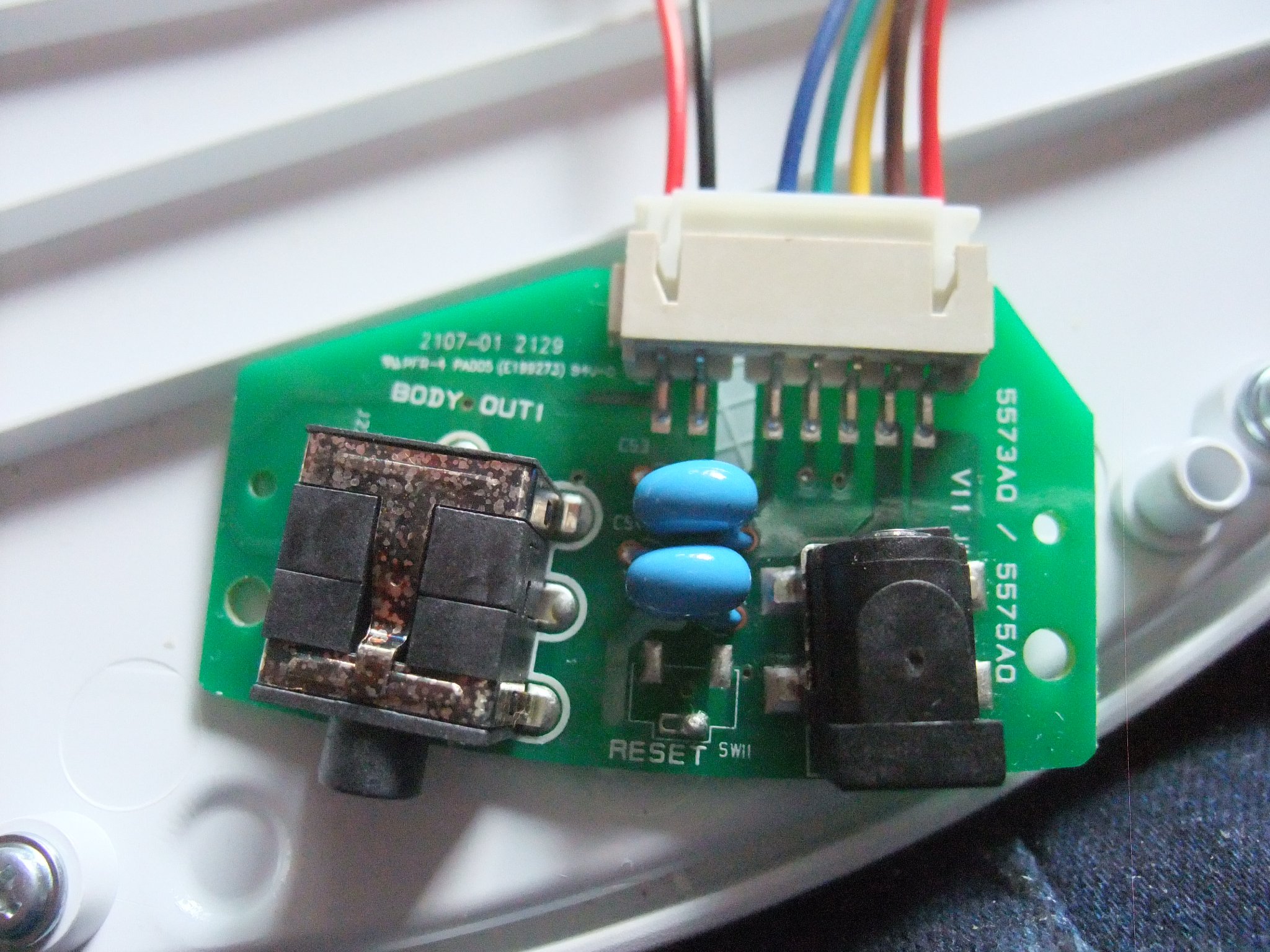

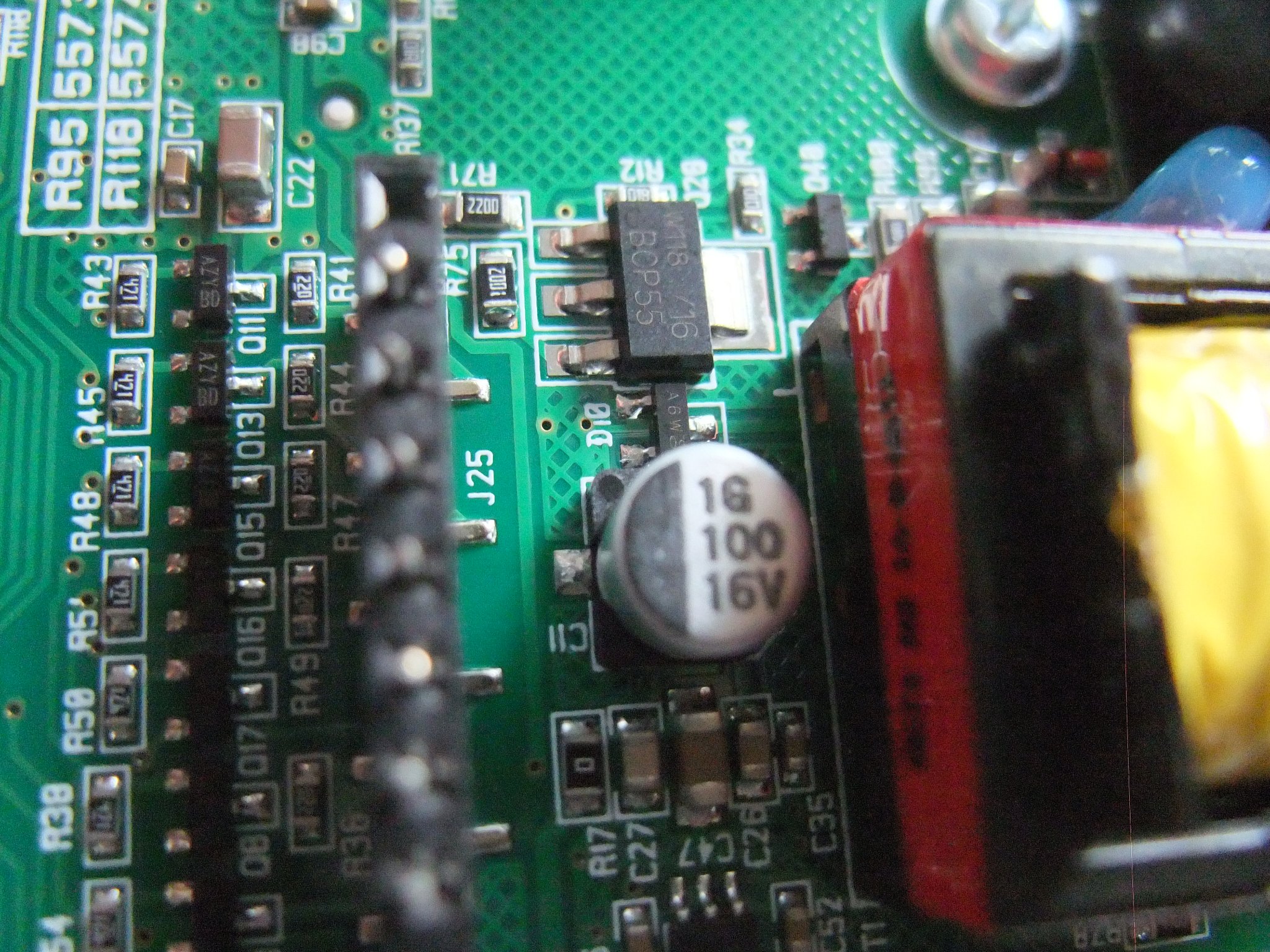

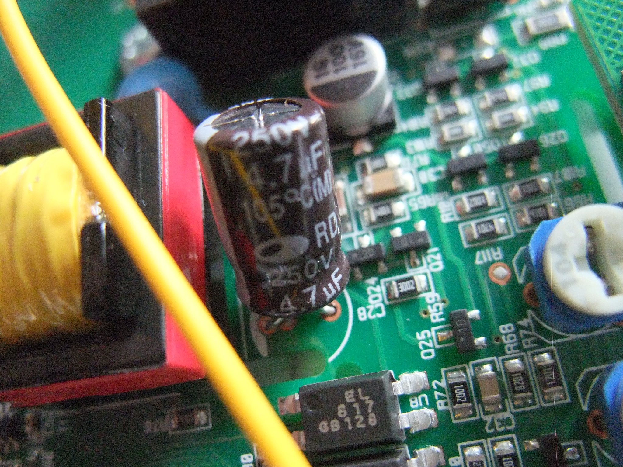

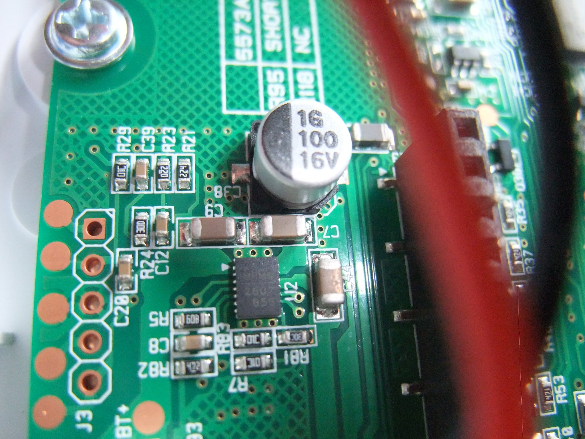

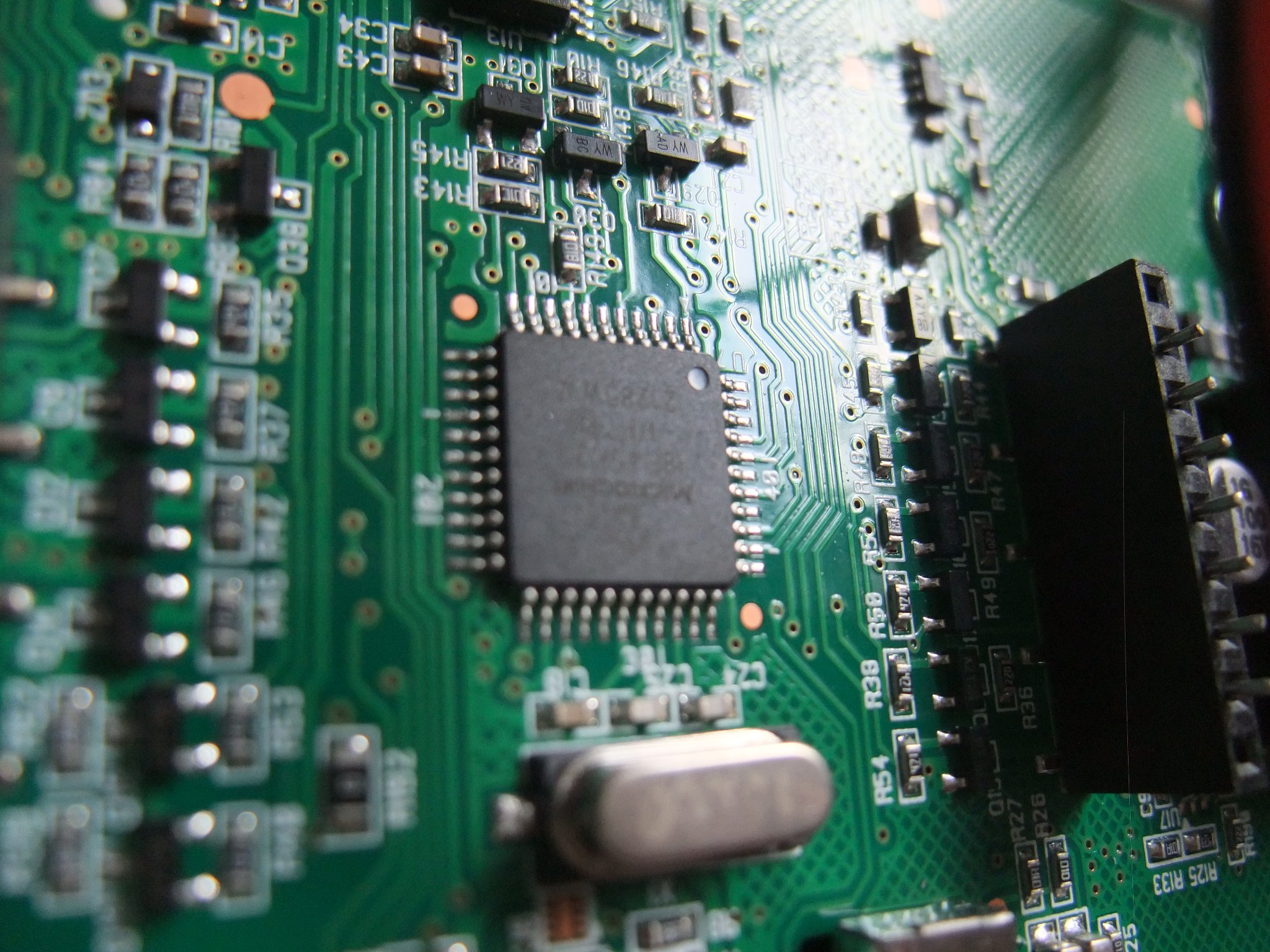

In the attachment some images of the wall wart power supply plug (5V/1A) and the PCB of the device (a little bit newer version than those from the videos in post #1). Amazing is, that a 5VDC power supply with nominal 1A can deliver more than 400W due a faulty overvoltage peak.Probably SMAJ-5.0A was chosen too tight but it should not stay in conductive state. Choose definitely one by another brand and test. Also check the maximum power the PSU can deliver and if necessary upgrade to SMCJ-5.0A as alexberg suggested. It may very well be a small spike can cause too high current in that device.
I recall having defective ones and then thought them becoming a short circuit is normal 😉
A Zener diode is by far NOT a suitable replacement.
Tranzorbs are simply zeners with a high surge rating and specified for 8/20us surge ratings.
No regulated power supply should give any significant overshoot above the nominal 5V.
The SMAJ5.0 only starts to clamp somewhere between 6.40 and 7.00V, already high for many logic families.
The way to find out is to measure the power on behavior with and without TVS (which are not Zener diodes).
Maybe it is not the power but the repetitive breakdown cycles at every power on. Manufacturer detected overshoot and solved that with a tightly chosen TVS, that kind of thing. Chicken-egg dilemma.
There must be a reason for failure.
I suspect the overvoltage protection is due to the SMPS having a long and somewhat unreliable feedback loop involving an opto-isolator.
