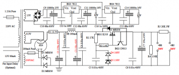

Hi, I am new in DIY and need help from all the experts in this forum

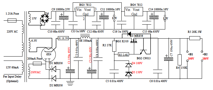

I am building a tube linestage. The PSU has a tube rectifier. It needs a transformer with 3 secondaries: 250V, 15V, and 6.3V. I have searched some transformer manufactures: edcor and hammond but cannot find it. I need to combine 2 transformers.
Could you suggest me what transformer that I can use? I am attaching scema that I am working on. The only different is I am using 115V as input (primary).
Thanks!

Thank You for quick reply! There are a lot of stuff in this HK store but I am looking for USA based store. The shipping for a heavy transformer seem same price as the transformer itself.
I am also open to advice on modifying the scematic so it works with any generic transformer.
