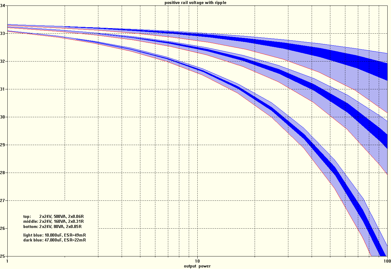

Transformer voltage droop
Being interested in how different transformer sizes might affect amplifier performance, I did some simulations in LTspice. I was mainly looking for the difference in secondary wire gauge and the resulting output resistance. Thus such things as regulation or saturation are not considered here, simply the different secondary copper resistances as stated in the datasheets were used. The load is steady and purely resistive. Output power calculation is already taking into account the typical 67% efficiency of a class AB amplifier.

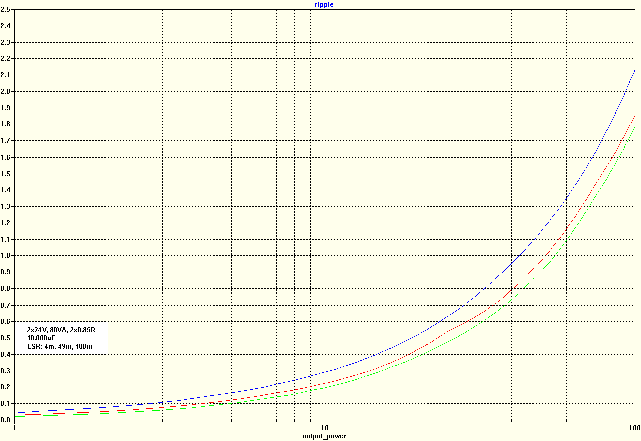

The second chart shows the influence of the filter cap's ESR, like 49mR for a single one or 4mR for 10 smaller ones in parallel.
This is actually pretty basic stuff, nonetheless it's quite interesting to look at... 🙄

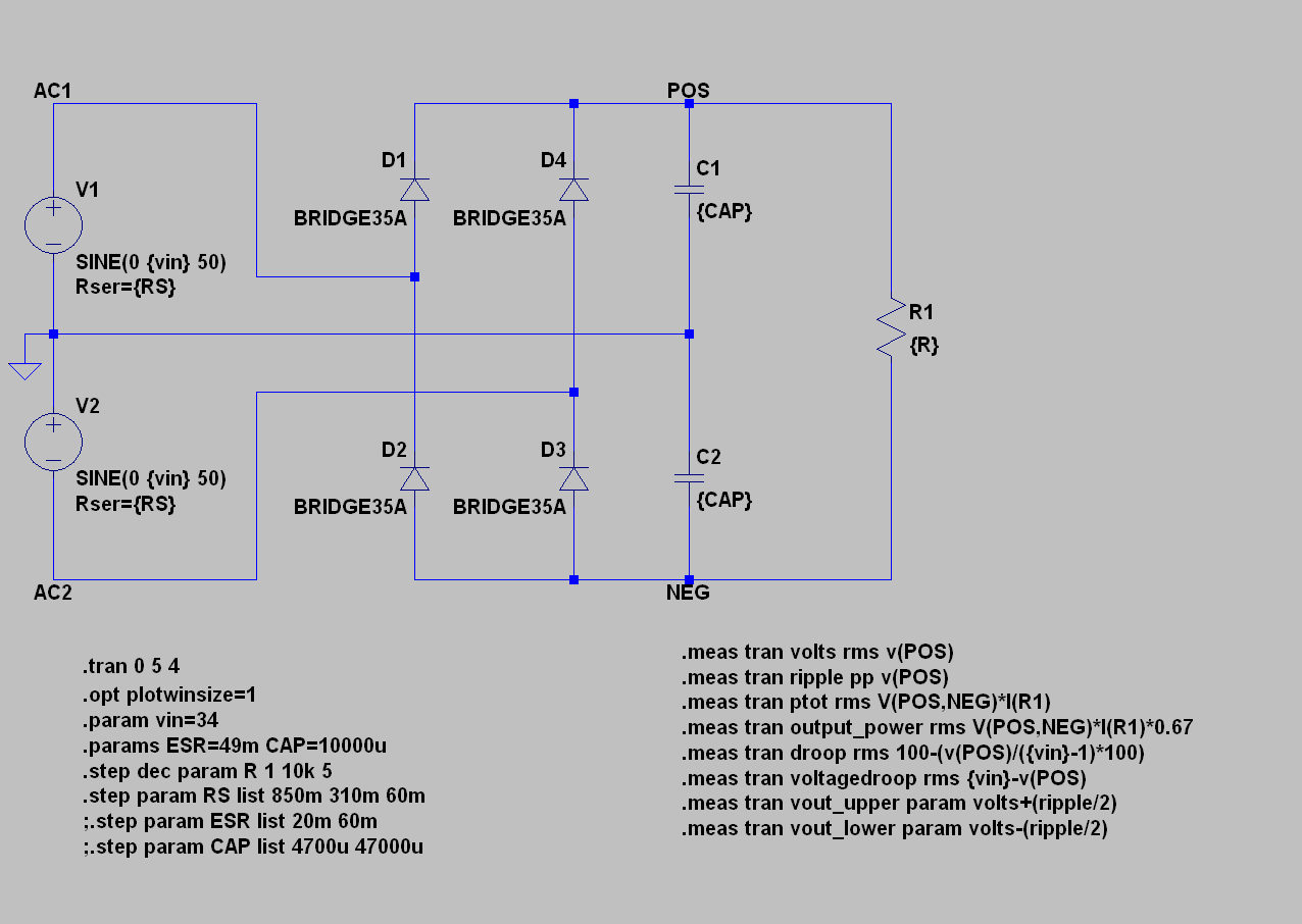

Are you using Rser to model secondary resistance?
Then a range from 0r06 to 0r85 covers an enormous range of VA in transformers. I'd guess from 2kVA to 100VA.
Hardly what one would select as a possible range of usable transformers for a specific power amplifier.
I think your Rload is too simple. The amplifier actually draws a half sinusoid in each power rail, when delivering significant power to the amplifier load, assuming of course that Iq has become small in comparison. This may throw up some differences in the way the model predicts actual behaviour.
I also suspect the Rser is too simple for what you're modeling.

ESR doesn't make that much of a difference, unless it's much too high. But since Low-ESR caps are common these days, that should not be a problem.

yes, I used Rser, as can be seen from the schematic.
The VA range is actually 80, 160 and 500 for each transformer with its two secondaries. The data is taken from actual datasheets.

Of course this is only a simple simulation, leaving out the intrinsic behaviour of the toroid itself, which should make things even worse. I stated that above. But nonetheless does the difference in secondary winding resistance make a difference in output voltage under load, which is shown here.
I did not quite get what you mean here. A real amplifier will behave different than a resistor, that's for sure, but a constant resistive load should be something like the worst case. The amplifier load on the psu will vary depending on the music signal, even into a purely resistive load (think of white noise vs. 50Hz sinus). In the simulation the load is constant.
Too simplified in my opinion.
Losses are proportional to I^2R and a constant current Rload underestimates this significantly.
0r06 is in the sim
0r08 is still too low for a 500VA
I measured 0r09 for a 1kVA transformer recently. I have never measured as low as 0r06 in any of my secondaries.

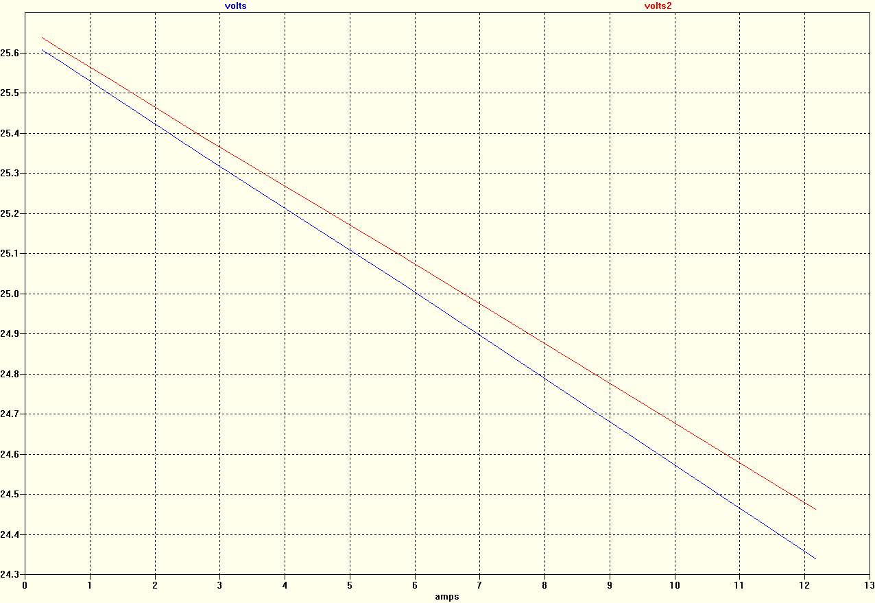

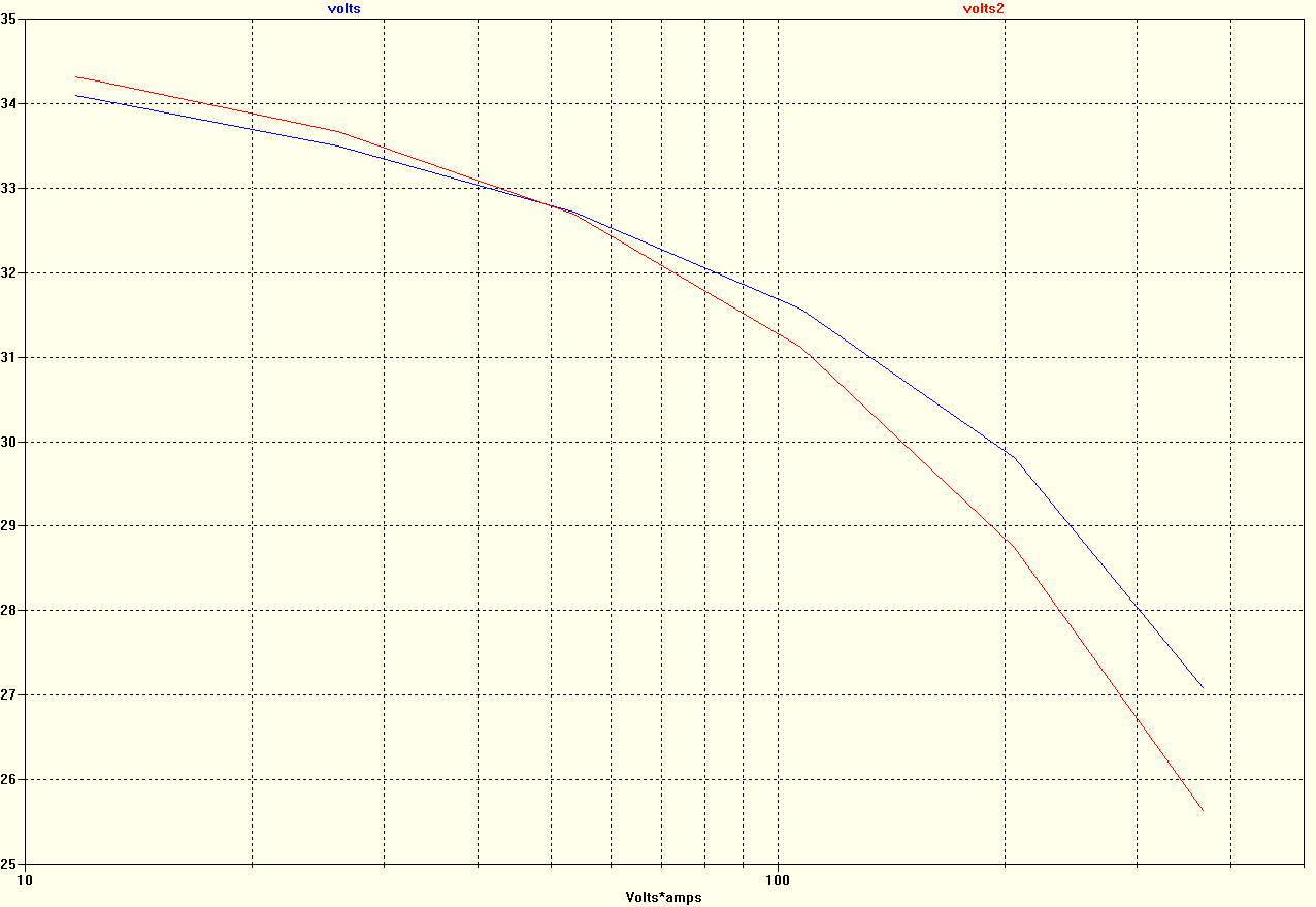

Here are the comparison charts. I used the simulation model from Tom Gootee with the measured data of my trafo.
The first chart shows both models with a simple resistive load on the ac, where the blue line resembles Tom's model and the red line my simple approach.
On the other charts the models were loaded with a full bridge rectifier, 4700uF (ESR=63m) and the stepped resistor. Same colour coding here.
Unfortunately I don't have a transformer with lower VA and equal voltage rating at hand. This would have made the comparison much more descriptive.
Please note that these comparison charts took more than half an hour to simulate, while the simple model is only a matter of seconds 😱.

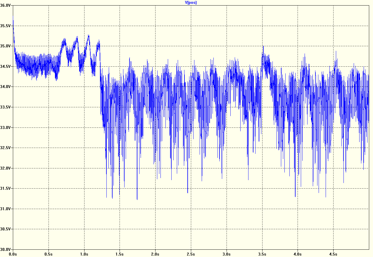

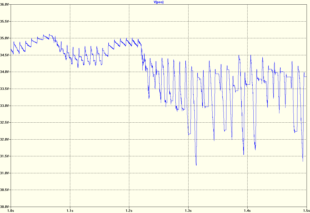

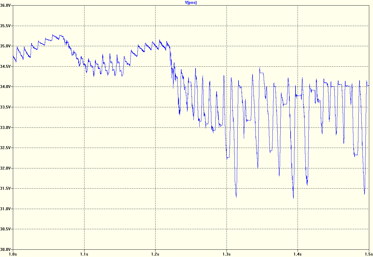

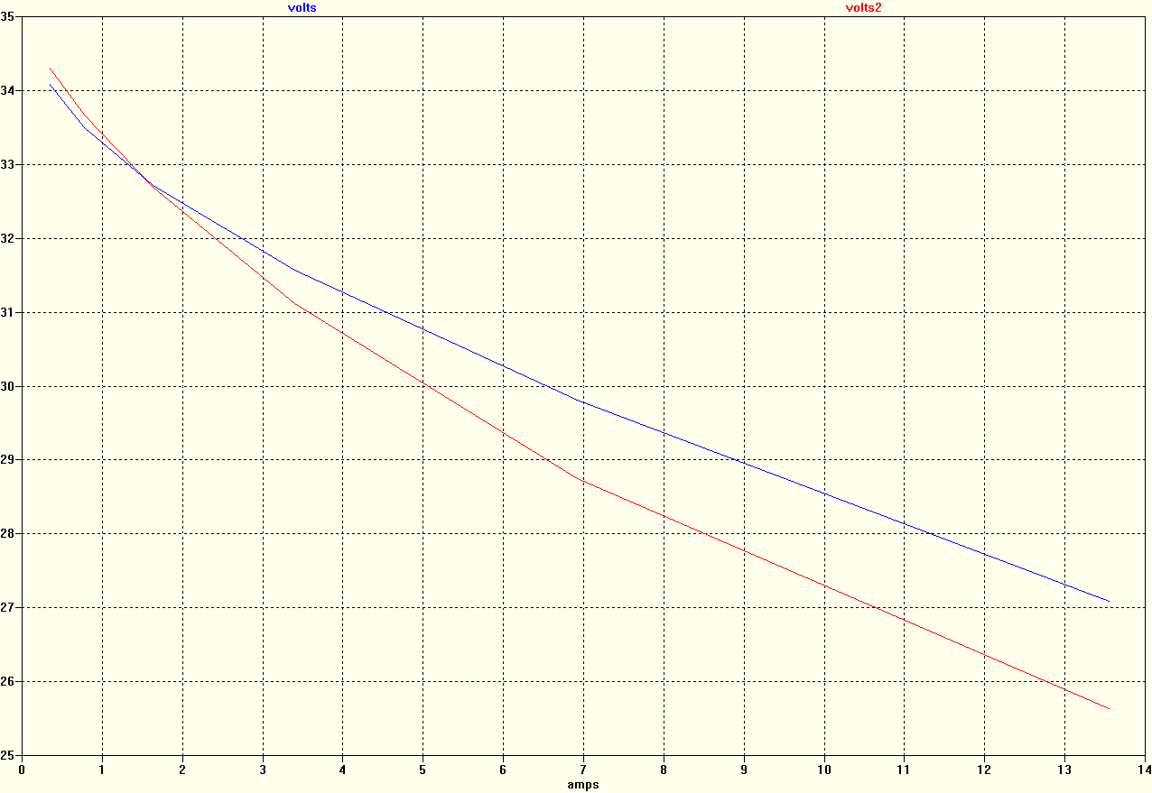

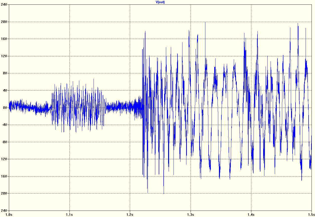

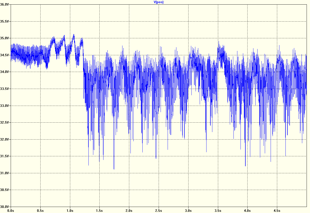

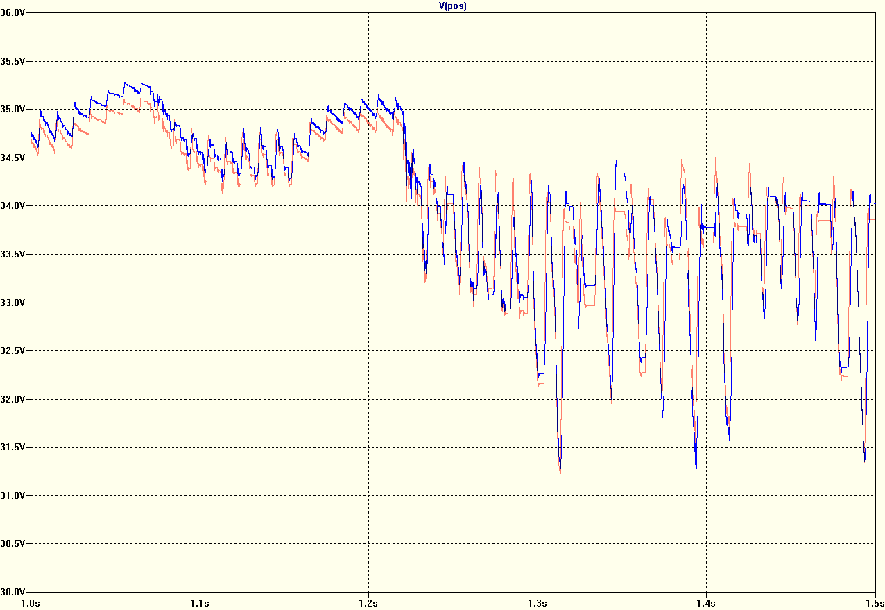

Made a more comprehensive simulation. This time I used the complete P3A circuit with a 2 Ohm resistive load and an actual wave file as input source. The power supply consists of a single rectifier bridge for both rails, 10.000uf of capacitance for each rail, and two modeled transformers.
Simulation time was almost four hours versus a quarter; the generated raw files grew to a full 36GB and 1GB, respectively.
#1: Elaborate Model, 5 seconds of music into 2 Ohms, positive voltage rail shown
#2: Simple Model, 5 seconds of music into 2 Ohms, positive voltage rail shown
#3: Elaborate Model, section of 0.5 seconds for better resolution
#4: Simple Model, section of 0.5 seconds for better resolution
#5: Overlay of both models for direct comparison, Simple one shown in red
#6: amplifier output voltage
