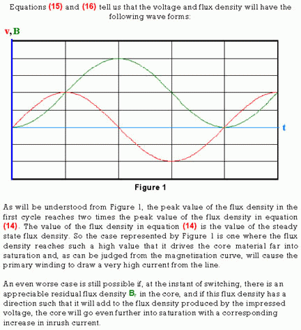

OK, here's the deal: The inrush current is max, indeed, if you switch the mains on at the zero crossing. BUT, if there is residual flux (from the last time you switched off) the inrush will even be greater. Because the excellent magnetic properties of a toroid, they have very high magnetic remanence and thus stay magnetically oriented from the time of switch off.
You can (if you are courageous enough) even calculate it...
As is seen, at the first zero-crossing of the voltage (red) the flux (green) is maximum.
Check the text below fig 1.
Jan Didden
Jan Didden
