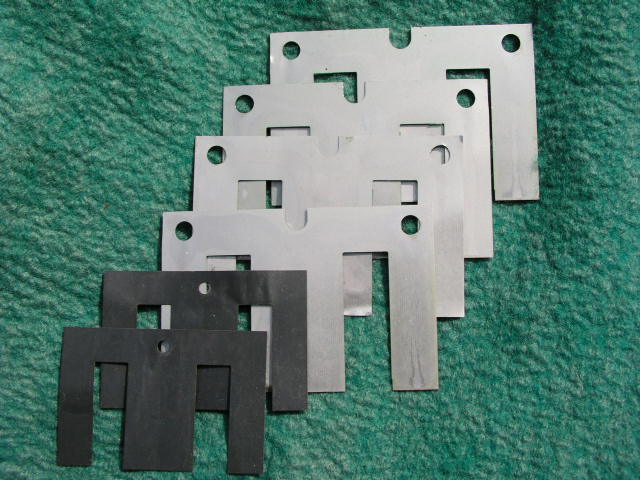

hi joans,
the silver colour lamination because of contain Nickel.
Nickel alloy will more shininy with more nickel contain.
the black colour orient HI-B because of the different grade, physical property as cool roll & heated roll. Different flux density will have different.
But in my knowledge thinner lamination will be better because of less core lose.
for more information pls visit my site to proto lam.
www.diyaudiocraft.com
Click more info & see the bottom.
U can see the detail of different lamination.
thnaks
thomas
