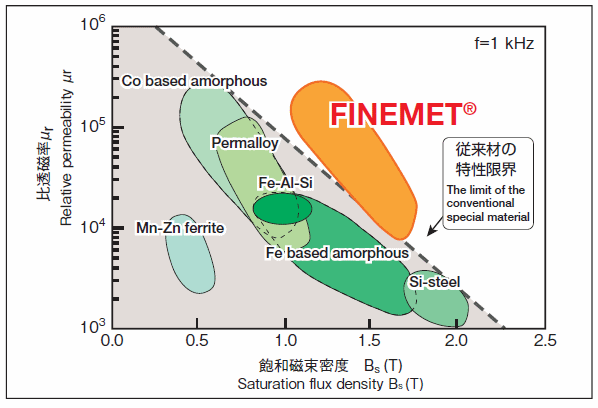

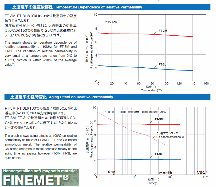

BUT-- when you get to "super core stuff", apparently there is such a thing. Or rather, Hitachi boasts that their FineMet has far less aging than 'Co based amorphous'.
Nanocrystalline Soft Magnetic Material FINEMET<sup>(R)</sup> | Hitachi Metals
https://www.hitachi-metals.co.jp/products/elec/tel/pdf/hl-fm9-h.pdf
Note that this is at 100 deg C, some hotter than we normally run. Running 50C cooler *may* extend the scale 32X longer; that still includes the life of many vintage audio amps.
The blob-chart shows FineMet against Permalloy, Co based amorphous, and Si-Steel. Frankly this is interesting. Not for "power"; I am sure FineMet is SO much more costly then Si-Steel that we would "always"(?) choose a big lump of iron over a kilo-buck of FineMet. However in the small-core case where Permalloy is king we *may* get a smaller core (less C) with FineMet. (And negligible aging!) But "Permalloy" is widely sourced at good price, and Hitachi probably holds-up Finemet prices because nobody else has it.
(Yes, somebody is/will be winding OTs on FineMet, just because it costs a lot.)
If working with Co based amorphous, OTOH, you want to know your aging.

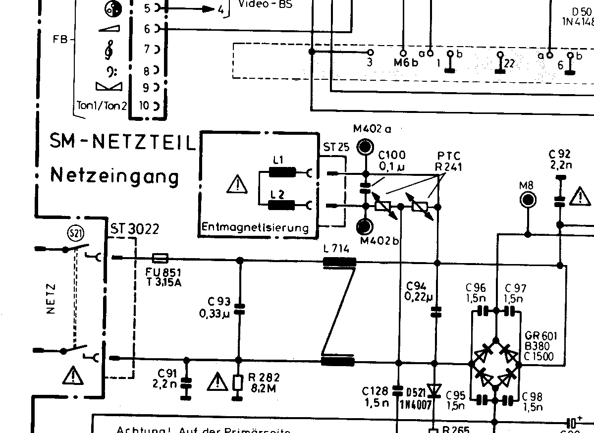

The mechanism is the same, but degaussing coil is designed to… how to say… degaussing. 😀
In all my years as a TV repairman, never saw an NTC in parallel, just the PTC in series.
The NTC is to prevent the inrush current surge due to the uncharged big electrolytic capacitor on the input of PSU, and it has nothing to do with the degaussing circuit.

German color TV's usually used a three pin component that combines both the PTC and the NTC which work as I've described. If present at all, the PSU's NTC was quite another story,

German color TVs used a three pin component which has two PTCs inside, one series connected to degaussing coil and the other paralleled with mains, replace one of them by an NTC is a recipe for disaster. 🙄
Dismantle an old Siemens or Telefunken 3 pin PTC and measure by yourself. 😉
